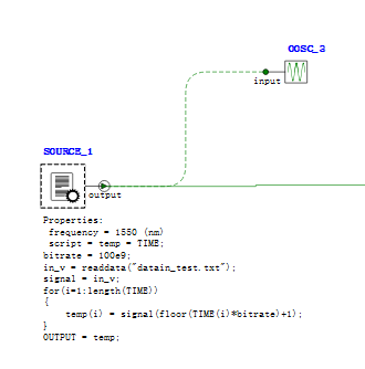

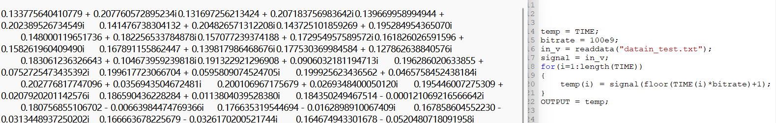

      I encountered a problem when using INTERCONNECT. I want to verify my simulation results in matlab, so I need to input an optical signal, including amplitude and phase. However, I tried the 'Scripted Optical Source' module, and used the script as shown below, and the txt file content is also as shown below. The signal obtained does not contain complex numbers, and there is no phase information.
      How should I solve this problem? Can I use other modules? As long as I can get the optical signal containing amplitude and phase that I need, it will be fine.
      Thank you very much and look forward to your reply!

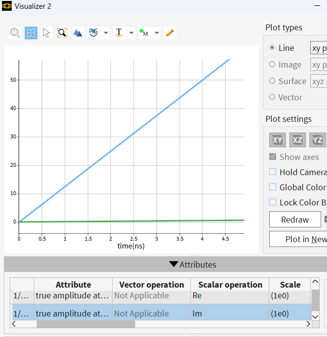

      After you run the interconnect file you should get both the real and imaginary part of your imported source with the oscilloscope(OOSC_1: plot format: rectangular)
      I hope this helps.

        Thank you for your patient answer and professional examples. I completely solved this problem with your method and learned how to use readdata.
        Thank you very much! Have a good day!
