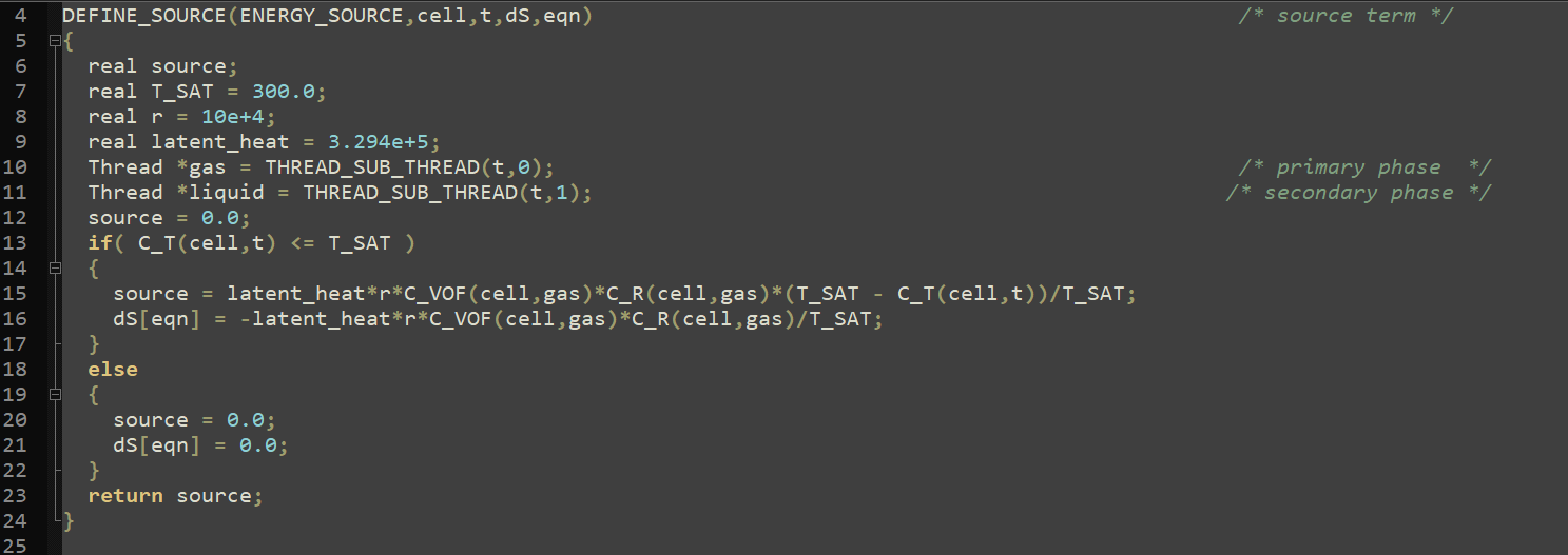

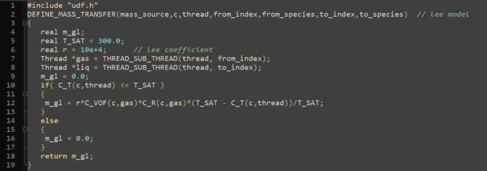

SubscriberI'm modelling the Stefan condensation problem in fluent. Initially, my domain only contain vapors with the left wall at sub-cool temperatures (295K). I'm using the UDF for the LEE model and for the addition of source term in the energy equation to maintain the interface at saturation temperature. Although my simulations run with the UDF, the mass transfer isn't taking place and the domain remains complete of vapors. I have checked my UDF and BC multiple times but I couldn't get what is getting wrong.

Lee Model is not a wall condensation model. It is a bulk condensation model.
So you can check by patching a very thin zone near the wall with initial condensate volume fraction.
Also, have you tested with the built-in Lee model without using any UDF?

SubscriberThank you for the reply. I tried without the UDF and it works. Also, I figured out the problem with my UDF (For Mass_Transfer UDF you first have to run the following commands: solve/set/advanced/linearized-mass-transfer-udf).
But, when I load the source term Macro in the cell zone conditions, fluent given this error and it shuts down.
"Node 0 : Process 43356: Received signal SIGSEGV"
"Node 1 : Process 31152: Received signal SIGSEGV"
I tried my UDF with both interpret and compile options. But, this error is the same. I also tried with setting user-defined-memory locations 0,1 and 2. Below is my UDF

Ansys EmployeeJust a hint: if you plan to the multiphase mass transfer UDF's do not use the DEFINE_SOURCE ones. If you plan to use DEFINE_SOURCE for mass and energy do not use the multiphase DEFINE Mass Transfer ones.

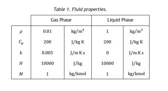

2) what viscosities did you use for the phases, as in the table and other parts, the viscosities were not mentioned. only this table
which the standard enthalpy of vapor should be 10000 and liquid 0 as the molecular weight is 1.

SubscriberThank you for the reply. I'm only using now the DEFINE_SOURCE in my UDF. But, my error is still the name, and fluent shutdowns after giving the error
"Node 0: Process 49168: Received signal SIGSEGV"
Also, can I ask what is the reason not to use these two macro's in the same UDF (DEFINE_MASS_TRANSFER & DEFINE_SOURCE)

SubscriberNo, I'm only using it for the Energy equation.

Ansys EmployeeI provided a link for the master thesis which does contain the whole code. We optimized that with a couple of vof settings and smaller time steps and the results we are getting are matching. I cannot help you here as you are just making a screenshot of only energy source term which alone is not enough. Moreover you require a better model than Lee here and that is described in the master thesis too.

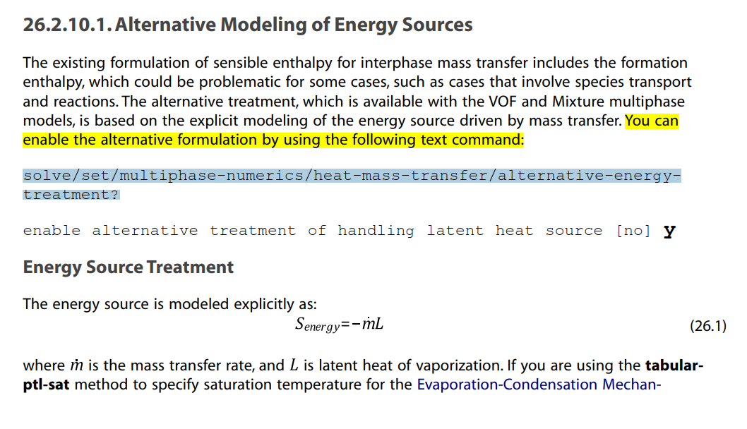

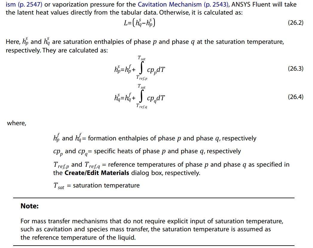

Lastly, I'm now using the built-in LEE model (not from UDF) to model the condensation in my case. I just need to add the source term to match the results with the paper mentioned above. But, here is the thing that a found. We can add source term using DEFINE_SOURCE macro. But, here is another thing that I came across in the Fluent User Guide (2021 R1 version). That the source term can be added using the following command: solve/set/multiphase-numerics/heat-mass-transfer/alternative-energy-treatment? YES .
The thing is, I don't know where to input the latent heat that is given in the equation in the user guide (Image is attached below). I have read this section further, but couldn't understand much. Let me know if you guys know about this.
