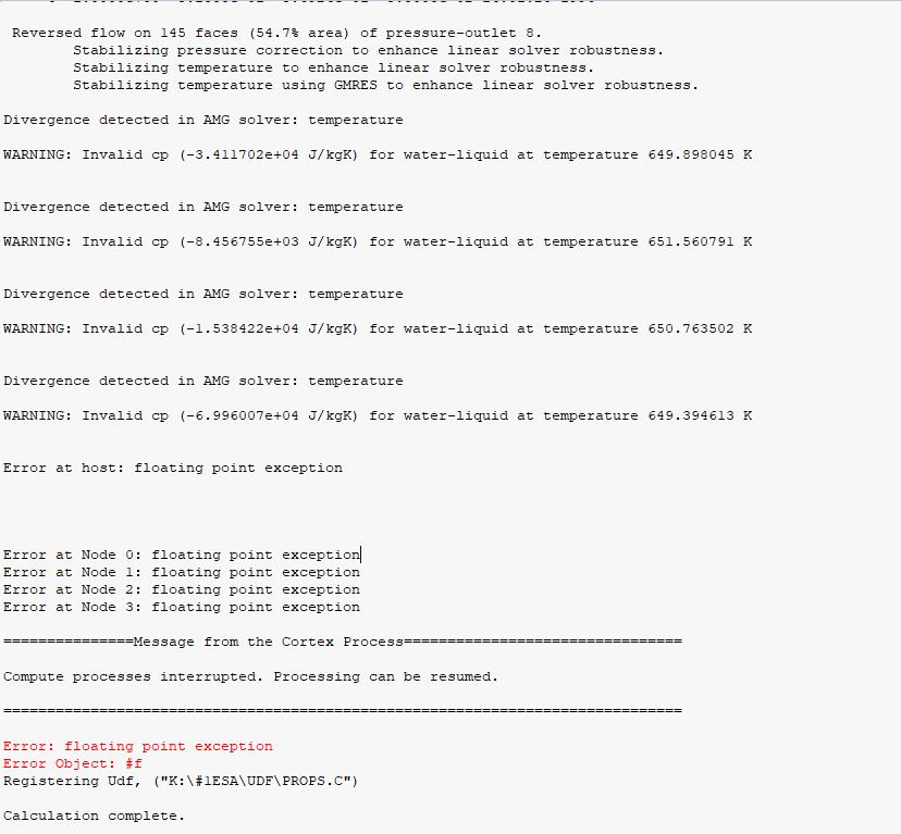

    • atulsbhat
      I have Checked My Polynomials, I had 4 polynomials for Cp, Exactly, they were Correct, But I got this Error
    • DrAmine
      You might need to limit temperature bounds at the beginning. Try that and report
    • atulsbhat
      I tried That in solution control limits, It Didnt work
