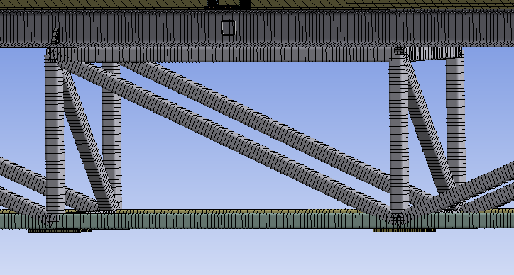

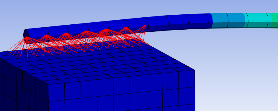

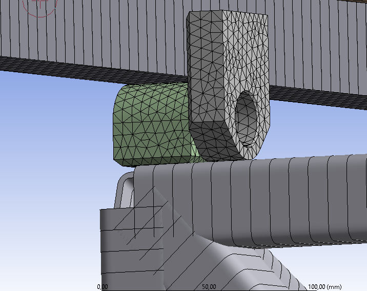

      1.How to connect a part of a beam, for example, its nodes, to the surface of a solid in contact or joint? An example of the contact of beams and solids:

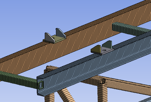

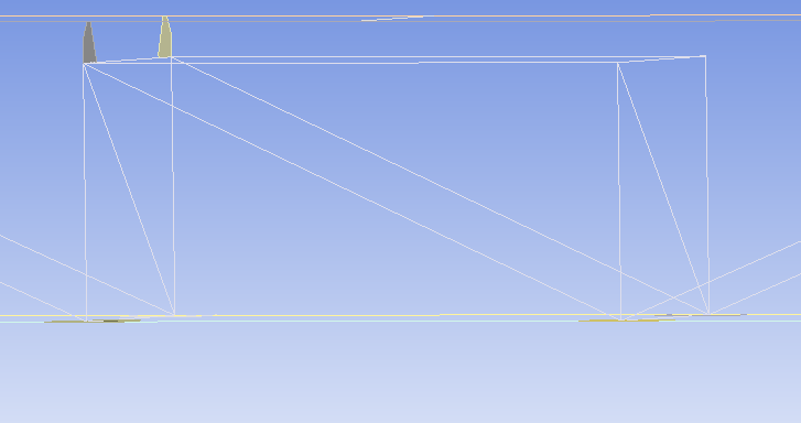

      2.What to do if two profile pipes run in parallel, they stand on top of each other, but after turning their beams, they have a space between the lines. How to take it into account and connect them?

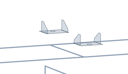

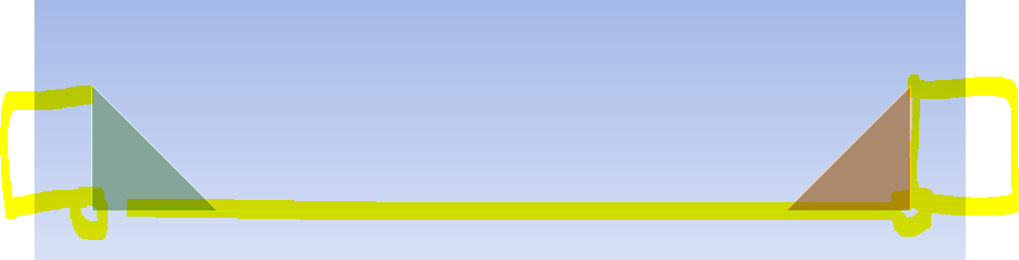

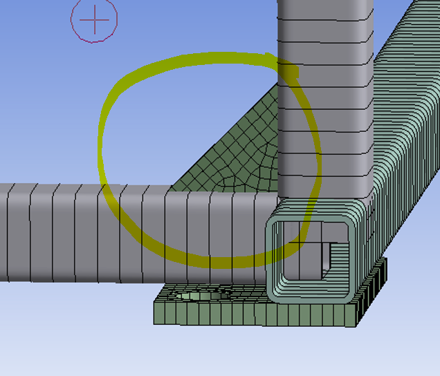

      3.If there is a gusset between two corner beams, after turning the pipes into lines, the gusset will hang in the air. Should it be moved to the beams or should it be pulled and extended to them?
      4.How to connect shells and beams correctly? Shells do not have offset in different planes. How to make sure that the shells are in the right place? Should they be moved to the beams? Then, after meshing, they will be in the center of the beam mesh.

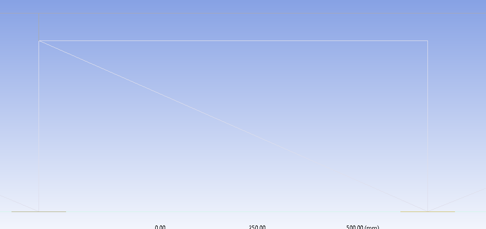

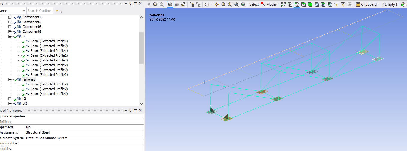

      5.When I SHARE beams in Space Claim, they are combined in the project, why? How to avoid it?
      The picture shows how I selected three beams, and many beams are selected in the workspace.

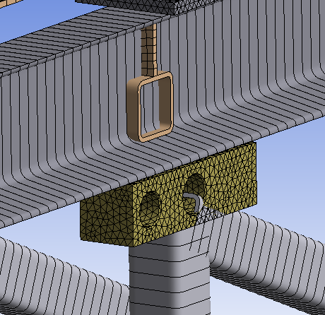

      6.Do the intersections of beams with solidamias as in the picture affect the calculation?

      Q1.How to connect a part of a beam, for example, its nodes, to the surface of a solid in contact or joint?
      A1: It is not possible to share or connect the nodes of a SOLID body with the nodes of a SURFACE or LINE body. This must be done with Contact Elements.
      A2: It is not possible to share or connect the nodes of a LINE body that is parallel to another LINE body. This must be done with Contact Elements
      Comment: The Beam Cross Section solids are graphical representations only. There are no faces on the line bodes to select as we have with SOLID bodies.
      A3: You would have to move and or trim the gusset in order for the LINE and SURFACE edge to be coinsident. (This can be a very tedious process to do manually.)
      A4: LINES and SURFACE edges can only share or connect nodes if they are coincident. This connection must be done with Contact Elements
      5.When I SHARE beams in Space Claim, they are combined in the project.
      A5: SHARE means it will combine the beam endpoints to connect the mesh.
      Any sort of sharing of nodes is done in a Part group.
      6. Do the intersections of beams with solidamias as in the picture affect the calculation?
      A6: No it should not affect calcualtions. Similar to A2, the Beam Cross Section solids are graphical representations only.
      Q1. Sorry, I didn't write exactly. When I wrote CONNECT, I meant how to connect using CONTACT.
      I have dealt with this issue. You can use a joint, in which you specify the node of the beam and the face of the solid, so they will have contact.
      Q5. Means it is necessary not to unite them in one group if SHARE is used?

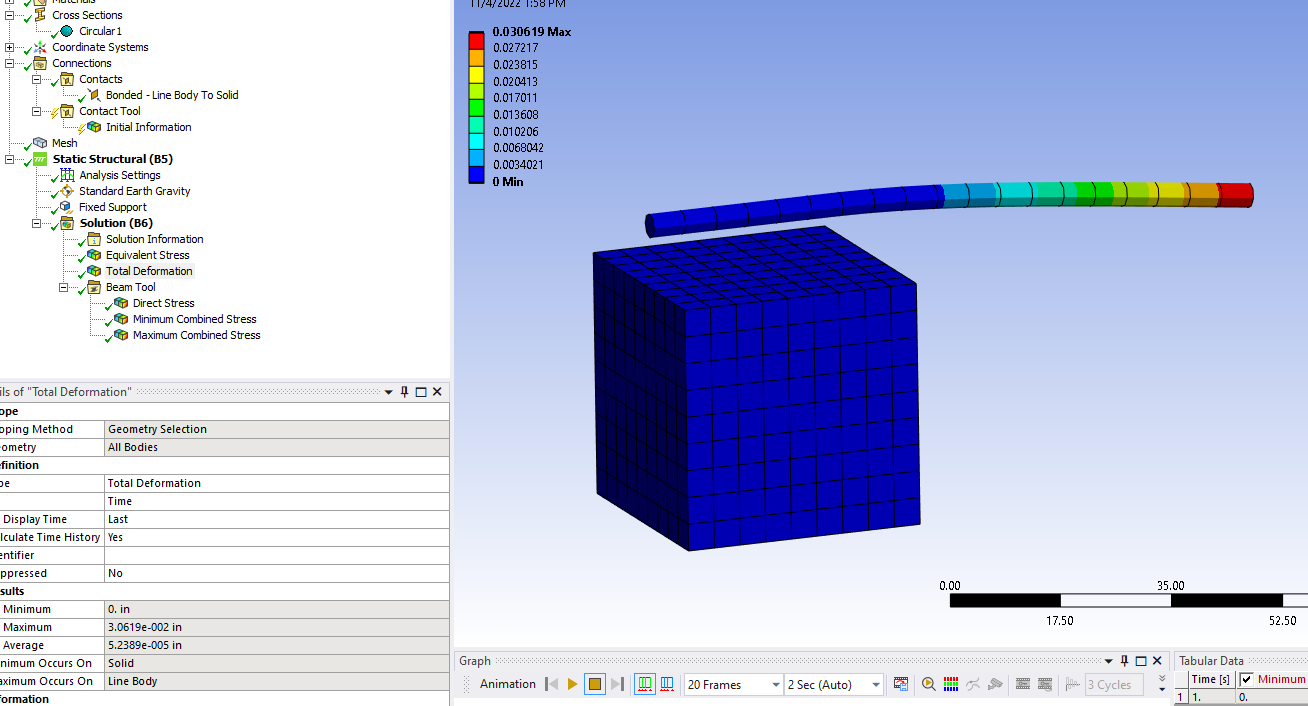

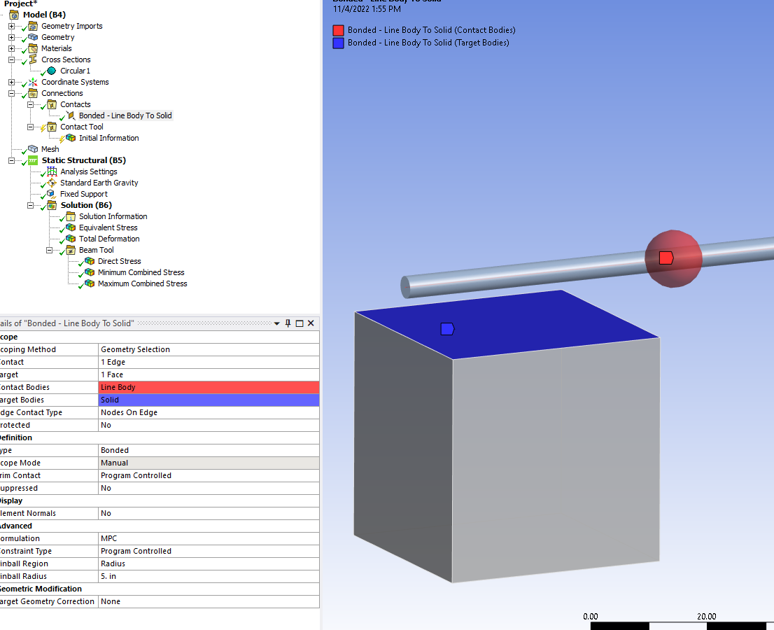

    • Gary_S
      Manual Contact Region Between a Line body and Face of a Solid.
      Simple gravity load. Block has a Fixed Support.
