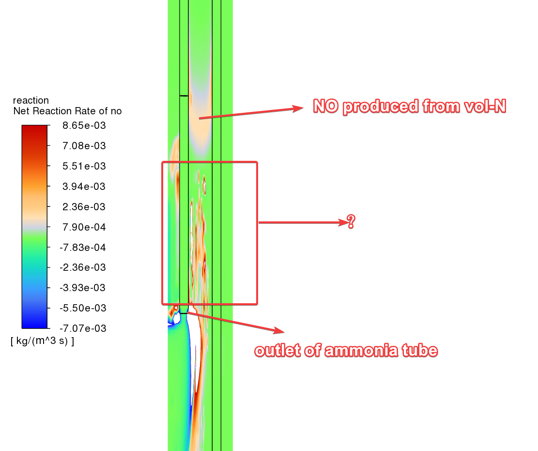

SubscriberI am using the EDC model in Fluent to simulate the co-firing of ammonia and coal. I employed a simplified Okafor mechanism to describe the gas-phase reactions. However, when analyzing the results, I noticed the presence of NH2 radicals in the pipe carrying pure ammonia, and a relatively high concentration of O atoms in the OFA pipe supplying pure air. The reaction mechanism I used does not include the direct decomposition reaction of ammonia (NH3 = NH2 + H). In theory, there should be no NH2 in the ammonia pipe and no O in the OFA pipe. Although the concentrations are not high, this significantly affects the credibility of my results. Is this due to numerical false diffusion or computational error?

I used Okafor mechanism reduced by myself to simulate the gas reaction.This mechanism comprises 102 homogeneous (gas-phase) reactions and 5 gas-solid reactions. I have compared the reduced mechanism with original Okafor mechanism using Chemkin, in my opinion, it's usable.
Although determining the cause remains a goal, the presence of NH₂ radicals within the tube is now less concerning. More intriguingly, significant NO formation is observed near the wall upstream of the outlet following ammonia injection, despite the absence of a recirculation zone in the flow field.

SubscriberYes,NO , NH2, NH, N are all in the mixture.Unmodified mechanism usually needs much time to solve out. That's why I need to do some reduction.Is the noticeable NO generation reaction phenomenon upstream of the ammonia pipe outlet caused by the grid, the algorithm, or something else?

Ansys EmployeePlease check if the mass/mole fraction of the NO, NH2, NH and N are defined as zero. If not, then you can expect these species in your domain. Also please re-check if there is really no reaction involving the before mentioned species.
