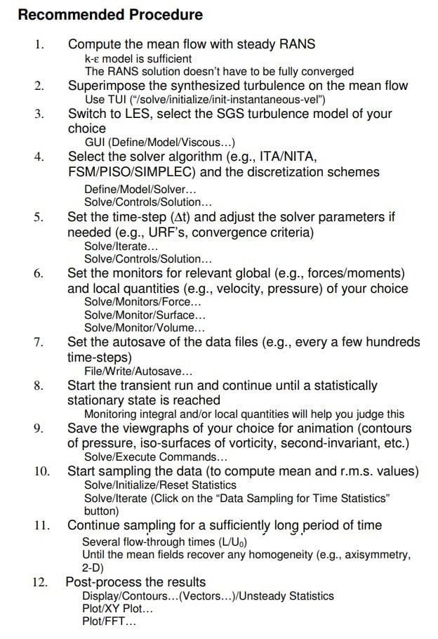

      So I have some doubts to do a good way in a Large Eddy Simulation and with a quick search in google I found a pdf with sometips to make this in ANSYS FLUENT. In respect regarding the mesh process I have some knowledge and my doubts is around the solution process. I give some image below with the data that I found in this pdf which I got in google. To make it clear, I do not have a supercomputer at my disposal and my package is student (some limitations).

      At first point, it's ok, as make a fully converged solution is easy I consider to use a fully converge steady RANS solution by a turbulence model of my preference.
      The second point, Is it really necessary to impose this turbulence synthesizer? What happens if I do not?
      The third and fourth point it's ok.
      For the fifth point, I tested a approach which I found in a Power Point file gived by dear friend Raul that have a way to speed up the solution which talks to use a very small time step size with a large iteration for the initial solution and decreasing across the solution, but I make some test with this and I obtained results, say, unsatisfactory, I think that for the case of the time step must be really small and as it has been calculated an amount of time to decrease the number of iterations per step of time but maintaining its size. (If anyone wants to comment on this, I'll be happy.)
    • José Mantovani
      For the sixth and seventh point is ok, for the the last (7th) I think that is in respect to create a Calculation Activities compatible with CFD-Post, per exemple.
      In the eighth point, I want know: What does it mean when say you get a statistically stationary state? Is it to follow the convergence residues in order to stop the solution when they obtain a "linear" behavior?
      The ninth point ok.
      In the tenth point, this point I need make after the solution be statistically stationary state or I need to configure the data sampling in the FLUENT area where I run calculation from the beginning of the solution?
      For the eleventh point, How I calculate the flow-through times? What is L in the formula L/Uo as we can see in the image above?
      And the twelfth point is also ok.
      So, here have many doubts about the LES solution procedure, but I think that it can be useful for someone which take a look in this thread. I will be very grateful to those who have the knowledge on this subject and can share their knowledge here in order to solve these small doubts. I'm here waiting!

      2. Superimpose initial synthetic turbulence: This is required so you can achieve relatively faster convergence of the LES simulation (Vortex method over Spectral Synthesizer)
      5. Timestep size: It is recommended to estimate the local timescale information from the precursor RANS simulation. You can create a custom field function (CFF) to evaluate the local timescale, dt = cell-volume^(1./3.) / (|V| + 0.00000001). Plot this CFF at multiple planes across your geometry to get an estimate of the min dt value. Ansys also suggests to use a timestep size of 0.5 * dt, which means that you set your timestep in such a way that you aim for a Courant number of 0.5.
      8. Statistically stationary state: This step is essential to eliminate the initial condition effects. The turbulent instabilities that are developed due to the initial conditions provided (either a RANS simulation or user assigned initial conditions) has to be convected out of the fluid domain. Since LES is computationally expensive, it is important to detect problems right from the beginning. You can monitor velocity across certain regions of your domain and if a repetitive pattern is noticed, then you can say that the simulation has reached a statistically stable state beyond which you can start time-averaging and sampling your data. This could take a minimum of 1 through flow cycle.
      10. Sampling the data and 11. Sample for a sufficiently long period of time: Once you've reached a statistically stable state, you can start sampling your data for several flow through cycles until you achieve a time-independent average solution. This could be anywhere between 5-25 through flow cycles (as Ansys reports). Mean values are reported to converge after 5 through cycles whereas the rms values can take between 10-25 cycles. The length scale (L) in the equation is the length of the flow domain. For a simple pipe flow, it would be the length of the pipe and not the diameter.
      There is a lot more to LES that cannot be covered over a post. The grid requirements are expensive for LES and with the student package you might be limited in certain aspects. Good luck Jose. Let us know how your simulation goes.
