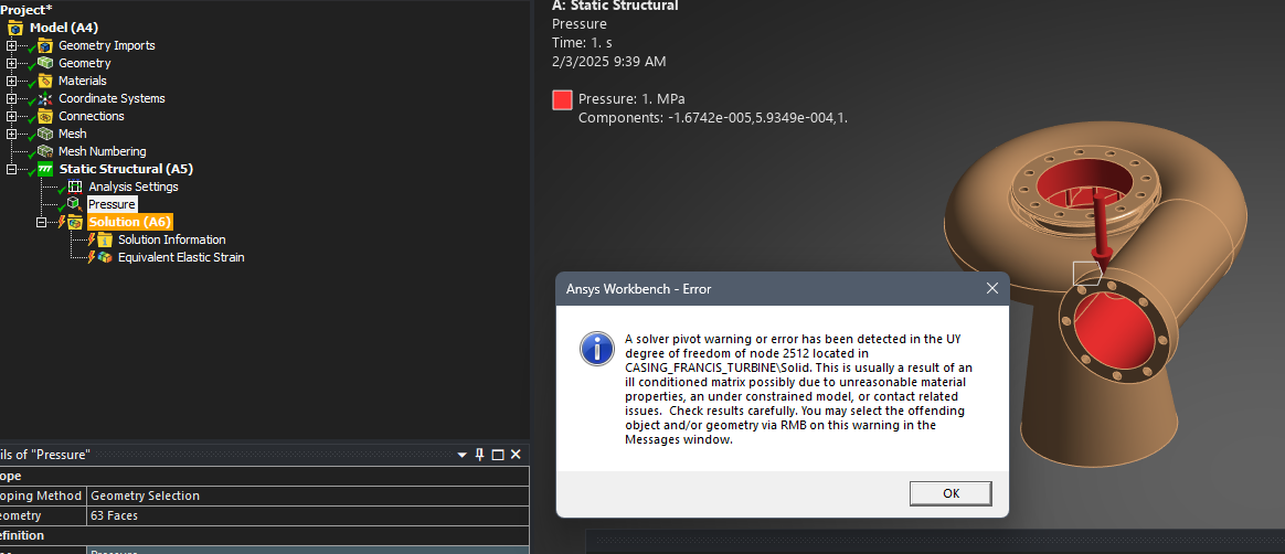

Solver pivot warnings or errors have been encountered during the solution
    • naufalbaktiono
      Hello everyone
      Can somebody help me to resolve my problem, I want generate solution and a massage like this appears
    • Akshat Gupta
      It seems like you are applying some pressure boundary condition without any fixed support or any other fixity.
      Have you used some fixed joints which will prevent the rigid body motion of the model?
      If not, please consider applying some fixed support or some other displacement constraints which prevent the rigid motion.
      Best,
      Akshat
    • naufalbaktiono
      thank you akshat for your advice and solution
      i tried it and succesfully managed it
