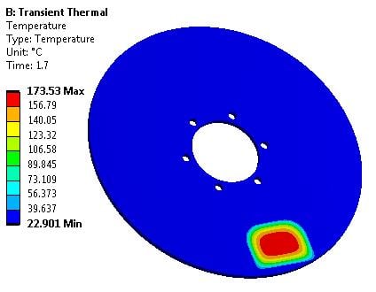

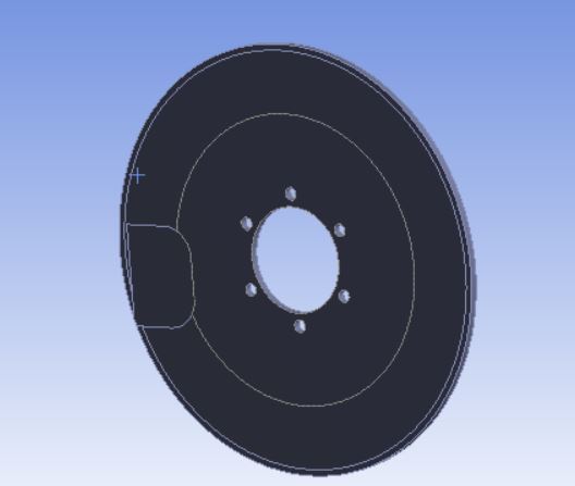

      Hi everyone,
      I'm trying reproduce this video:
       https://www.youtube.com/watch?v=_4FLYk00mls
      There is only one difference between the video simulation and my simulation the geometry, but I think that there aren't problem with it
      However when I solve the Transient Thermal Analysis I recieve this error:
      I read the discussions:
      /forum/forums/topic/solver-pivot-warning/
      /forum/forums/topic/a-solver-pivot-warning-or-error-has-been-detected/
      but neither one helped me
      Methods to resolve a solver pivot warning in a Structural model are different from what is needed to resolve the problem in a thermal model.
      I have much less experience with thermal troubleshooting than structural, but if you attach a .wbpz archive file, I will take a look.
    • marcelozortea
      Peter I don't know how to attach on ansys community, I tried click on attach but did not happen anything, I'll post at my google drive and share to public, I hope that aren't any problems...
      you can download it by: https://drive.google.com/open?id=1OF741z5A6vNWx8rOla1_ygMiy7rqJ1kQ
      Marcelo, I downloaded your model and made some changes to allow it to converge.
      I'm not certain, but I don't think it is valid to put both a Heat Flow and a Convection Boundary Condition on the same face.  I separated them.
      I also made sure there were many elements through the thickness
      I also turned on Automatic Time Stepping and used a small Initial Time Step
      Finally, I reduced the size of the Heat in each step and changed the Convection Coefficient.
      I you can try various changes to return it to what you wanted and find out which change breaks the model.
      Attached is a 2020 R1 archive.
