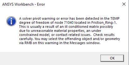

      I was trying to run Transient thermal analysis, It seems like Ansys doesn't want to run it. I'm getting 2 error messages and one Info.
      Error1Error2Info
      Previous links /forum/forums/topic/solver-pivot-warning/
      /forum/forums/topic/a-solver-pivot-warning-or-error-has-been-detected/ did not help much.
      I tried the suggested corrections in /forum/forums/topic/solver-pivot-warnings/,but in vain.
      Both Transient and steady-state has the same issues.

      I can't run your model on this computer because it won't fit in the Student license limits.
      It's a disk brake rotor, right?  You have applied heat flow over most of the brake surface, and very little surface area is left for convection. This doesn't represent how the brake rotor cools itself. There is actually convection over all the exposed surfaces, and only a small surface area where the hub bolts onto the rotor, where there is conduction instead.

      I applied all the way possible but it brings up the same error. Referring to the above picture, the blue area where heat flows, and the yellow area where the convection happens, I did not consider conduction and radiation as of now. It still brings up the same error.
      Even though the setup does not represent the actual brake cool off, it has to yield me bad results. But here the simulation doesn't run. I might be wrong on this with Ansys but Solidworks runs it.
