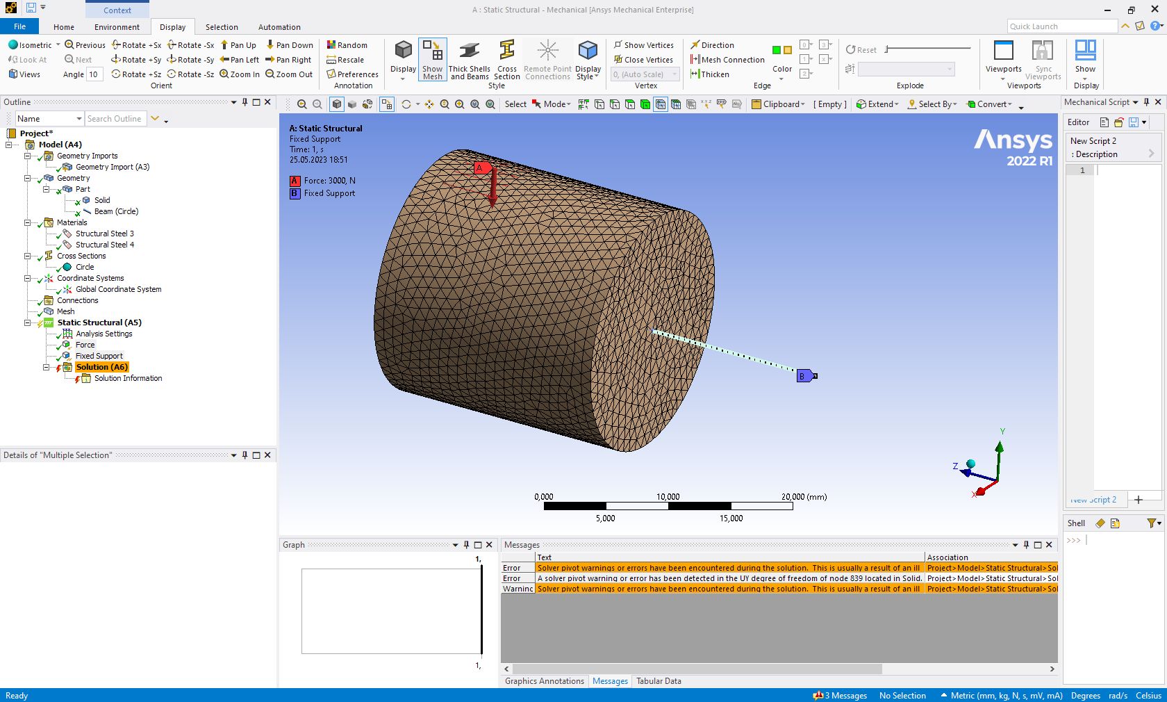

      In the model below, I always get a solver pivot error although the end node of the beam has a fixed support applied to it. In SpaceClaim, Share Topology is set to "Merge" or "Share" (makes no difference). What is the reason for that? Do I still have to define some sort of connection between the beam and the solid?
      Also, I would like to know how exactly the connection between solid and beam is established (since the beam has only one node in the intersection plane while the solid has many).

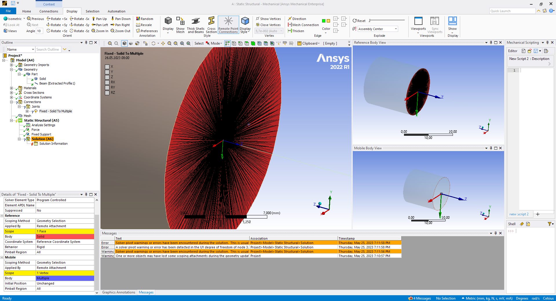

      Right click on the Connections folder and Insert a Fixed Joint. Select the flat face of the solid cylinder as the Reference side of the joint and select the vertex of the beam element that is touching that face as the Mobile side of the joint. The joint will allow the face and vertex to be connected in a way that transmits shear forces and bending moments from the solid to the beam.
    • K Kramer
      Hi Peter,
      thanks for your answer. When I select the end vertex of the beam, Body is set to multiple and the joint does not get a green check (selecting the vertex on the other end does work). I assume that is due to the shared topography? Should I disable it? That leaves me a bit confused since in this demo, topography sharing seems to work without extra steps: https://www.ansys.com/de-de/resource-center/video/beam-and-shell-modeling-with-ansys-mechanical
      Yes kramer, go back to SpaceClaim and Unshare the geometry. The Joint needs a node at the vertex of the line body that is not shared with a node on  the face of the solid.
      Shared Topology works between beam and shell elements.  It seems confusing why a beam and a solid element doesn’t work, so I will try to explain.
      Nodes on beam and shell elements have 6 unknowns (x, y, x, Rx, Ry, Rz), three displacements and three rotations.
      Nodes on solid elements have only 3 unknowns (x, y, z), three displacements.  That means when a single node on a beam element is shared with solid elements, the beam behaves as if there is a spherical joint at that node because there is no rotational unknown on the solid elements to support rotational loads.
      The same problem happens when a straight line at the edge of a surface is shared with a solid: a hinge would be created.

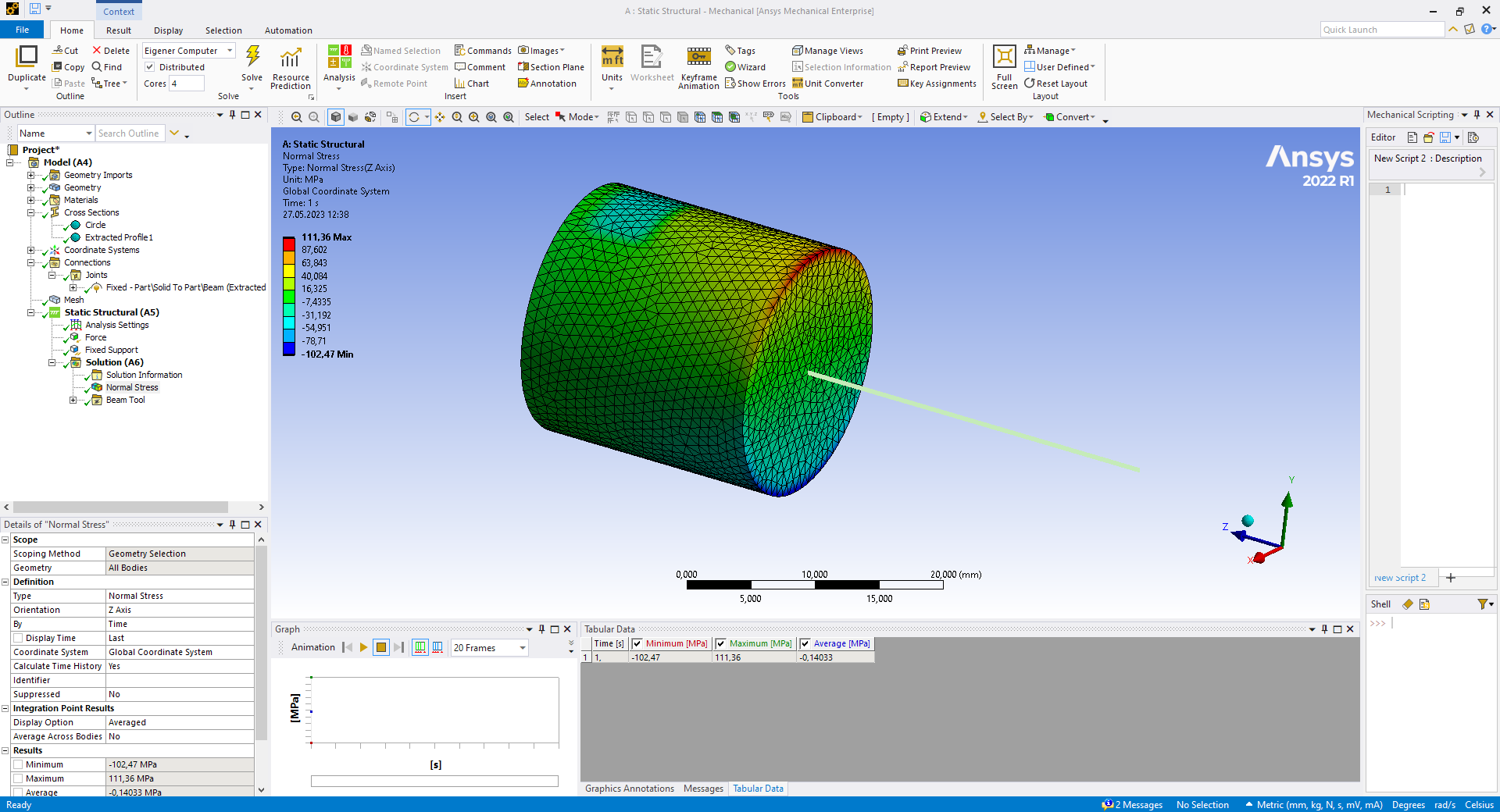

      Ok, did that. Should I set behavior to rigid or deformable? Empirically, deformable seems to give more realistic results.
      Behavior = Rigid forces the solid to behave more like a beam element, since the cross-section of a beam can't change, it can only translate and rotate.
    • K Kramer
      But rigid forces the solid cross section to move as one, right? Thus it would add artificial stiffness. I tried both rigid and deformable. The normal z-stress with deformable is very close to the analytical result (57.3 MPa for a force of 3 kN, a diameter of 20 mm and a distance of approx. 15 mm from load to end of solid), while the result with rigid is almost twice as high.
      Deformable:
    • K Kramer

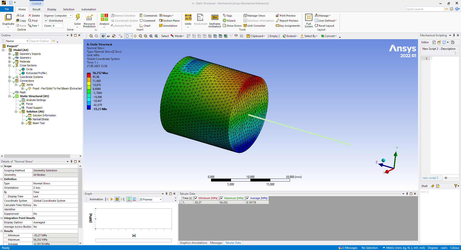

      Rigid:
    • K Kramer
      By the way, I get the following warning: "Joints are being used in the current analysis with Large Deflection turned Off.  Thus, only linearized joint behavior will be considered.  If finite rotation and large deflection effects are to be considered, please turn on Large Deflection."
      But that should be ok, right?
      Rigid elements often cause a stress concentration. That is why they should not be used in a region where accurate stress is needed. You can use deformable if it gives you a better result.

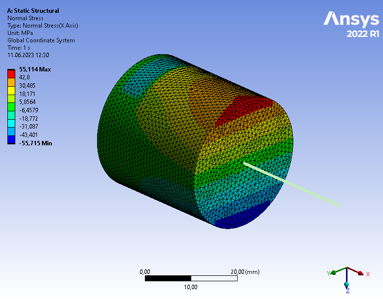

      Bending stress "flexible":
      Bending stress "rigid":
      So "rigid" creates, well, rigid links between the DOFs, but how exactly does "flexible" work?
      Euler-Bernoulli beam theory does not include shear deformation so there is no shear stress in your analytical result.  Shear stress is negligible in long, slender beams, but you have a non-slender beam so shear stress is significant.  Use Timoshenko beam theory to include shear deformation.
      Ansys Beam elements use Timoshenko beam theory, and solid elements develop shear deformation, so that introduces a source of error from the Euler-Bernoulli  analytical result.
      Deformable or "flexible" joints use an element called RBE3 for small deformation analysis.  Here is what the Ansys Help guide says about that element.
      RBE3 distributes the force/moment applied at an independent node to a set of dependent nodes, taking into account the geometry of the dependent nodes as well as weighting factors. The force is distributed to the dependent nodes proportional to the weighting factors. The moment is distributed as forces to the dependent nodes; these forces are proportional to the distance from the center of gravity of the dependent nodes times the weighting factors. Only the translational degrees of freedom of the dependent nodes are used for constructing the constraint equations. Constraint equations are converted to distributed forces/moments on the dependent nodes during solution.
      RBE3 creates constraint equations such that the motion of the independent node is the average of the dependent nodes. For the rotations, a least-squares approach is used to define the "average rotation" at the independent node from the translations of the dependent nodes.

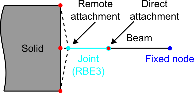

      The end of the line has a vertex and there is a node at that vertex, so you can use a Direct attachment to the Reference side.  The Mobile side is a face with lots of nodes, so you need an independent node to gather the motion of all the nodes into a single node that can be called a Remote Point because there may not be a face node at that location.

      You are free to switch the Reference side and the Mobile side of a Fixed Joint.  The Reference side is where the Reference coordinate system is created. In your diagram above, where the beam node has a gap to the face, the coordinate system would be in a different location and so the moments and forces would be different if you switched roles. In your model, the beam node is at the centroid of the face so the coordinate system will be in the same location no matter which way you choose Reference and Mobile, but the signs on the Forces will change if you switch Reference and Mobile.
      If you create a Fixed Joint to connect two Faces, then each face gets a Remote Point to gather the nodes on each face to a new node. The two new nodes exist at the origin of the Reference Coordinate System.  In the case of two faces, you can't do direct attachment.

      The gaps in the sketch above are just for illustrative purposes. So in the end the only thing that changes when swapping reference and mobile side is the coordinate system (which makes no physical difference)?
      From what I understand, the remote point for the face (in case of remote attachment) is created via an RBE3 element and then rigidly connected to the node on the other side (on the beam in this case). For the beam, direct and remote attachment are the same because a remote point would just be a duplicate of the end node, right?
      Swapping Mobile and Reference sides will change the sign of the Force output of the Joint.
      For the beam, there is an extra node and an extra element compared with direct attachment.
