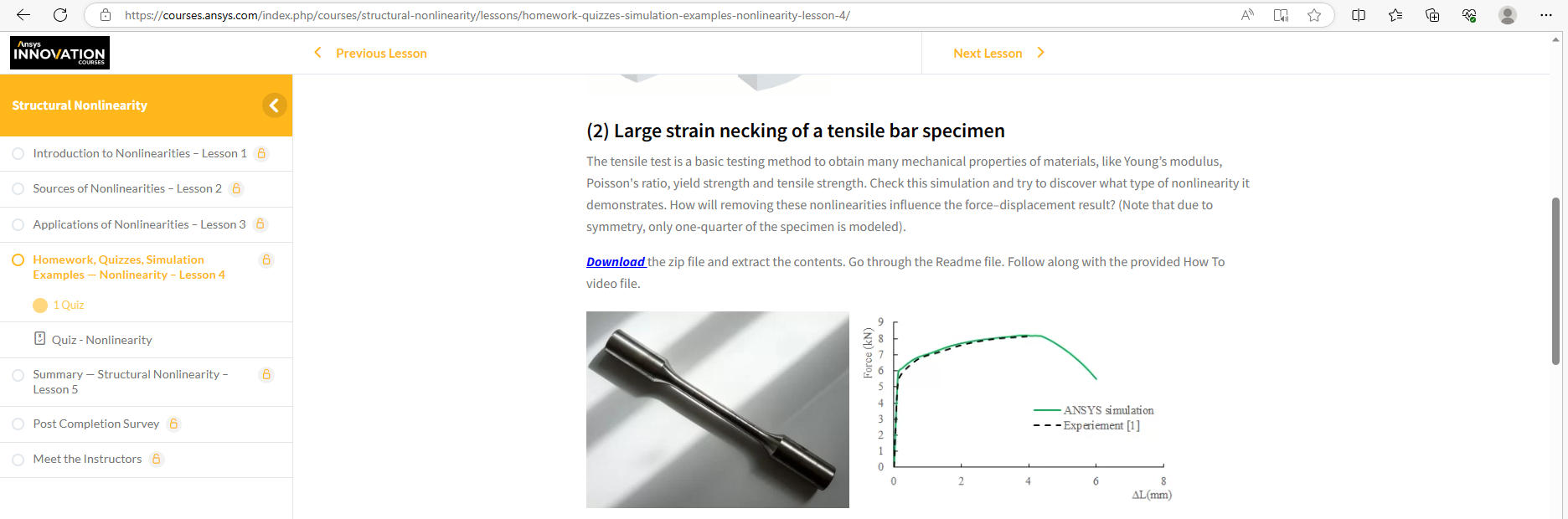

      I am using Ansys 2023 Student version. I am unable to analyse even simple non-linear problems. Even the one from Ansys innovation courses gave this error, "The solver engine was unable to converge on a solution for the nonlinear problem as constrained.  Please see the Troubleshooting section of the Help System for more information."
      May I pleaseknow if this is due to the limitation of my system or is it sue to the limitation of the student version software or is it some other setting in my system?Non-linear problem from Ansys Innovation course

    • khesh.selvaganapathi
      Anand,
      what plasticity model are you using ?
      bi linear or multi linear ?
      are you loading by displacement or force ?
      i have simulated necking with a 2D axisymmetric model with multi linear plasticity and displacement control, displace it to a reasonable level, you should be able to calculate what this is, for say 30% strain.
      your high distortion elements warning is probably in the necking region.
      Track reaction force and if necking has occured, you will see a peak force that then drops.
