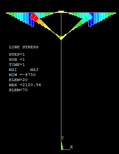

Solution output – Stepwise moment diagram (like a bar graph).
    • Errico Maasgano
      Hello, I have a doubt about the output of the solution. I can't understand why the momentum diagram comes out like this, in steps (like a bar graph).
      I don't know if I moved some setting or I'm doing something wrong but before it came out without discontinuity.
      Could you help me figure out what to do?
      I attach a photo.

      You need to use the quadratic version of beam188 like in the test below:
      /prep7
      et,1,188,,,2               ! Default beam188 only has one Mz, same at both ends
      mp,ex,1,3e7
      mp,nuxy,1,0.3
      sectype,1,beam,rect
      secdata,1,1
      n,1
      n,11,20
      fill
      e,1,2
      *repeat,10,1,1
      d,1,all
      f,11,fy,100
      fini
      /solu
      solve
      fini
      /post1
      set,last
      etab,mzi,smisc,3
      etab,mzj,smisc,16
      plls,mzi,mzj
    • Errico Maasgano
      Thank you, it worked.
