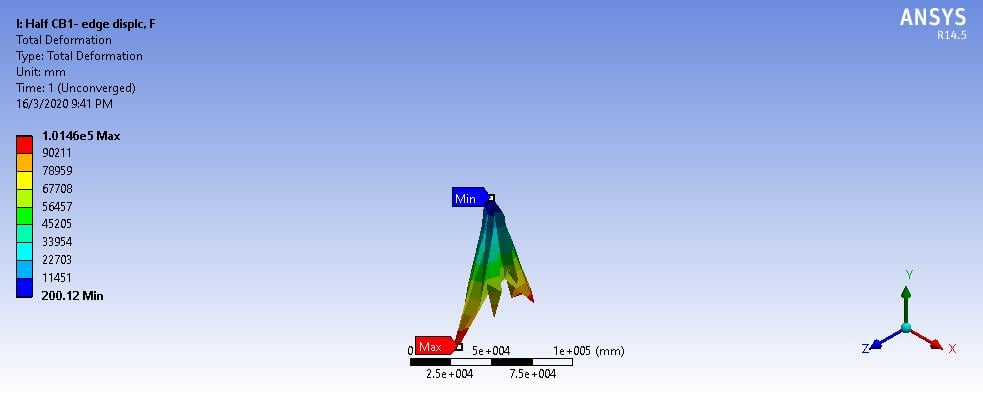

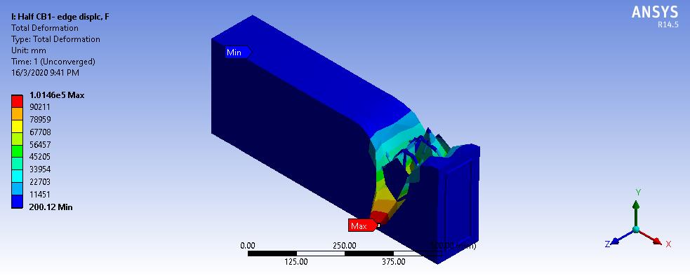

      Above are the details of the model settings, which doesn't yield proper result. Please guide me through my problems. I'm not sure how to rectify the error.
      Below are the deformation response under this setting:
      View in 1.0 (True scale) (above image)
      View in 5x (Auto)

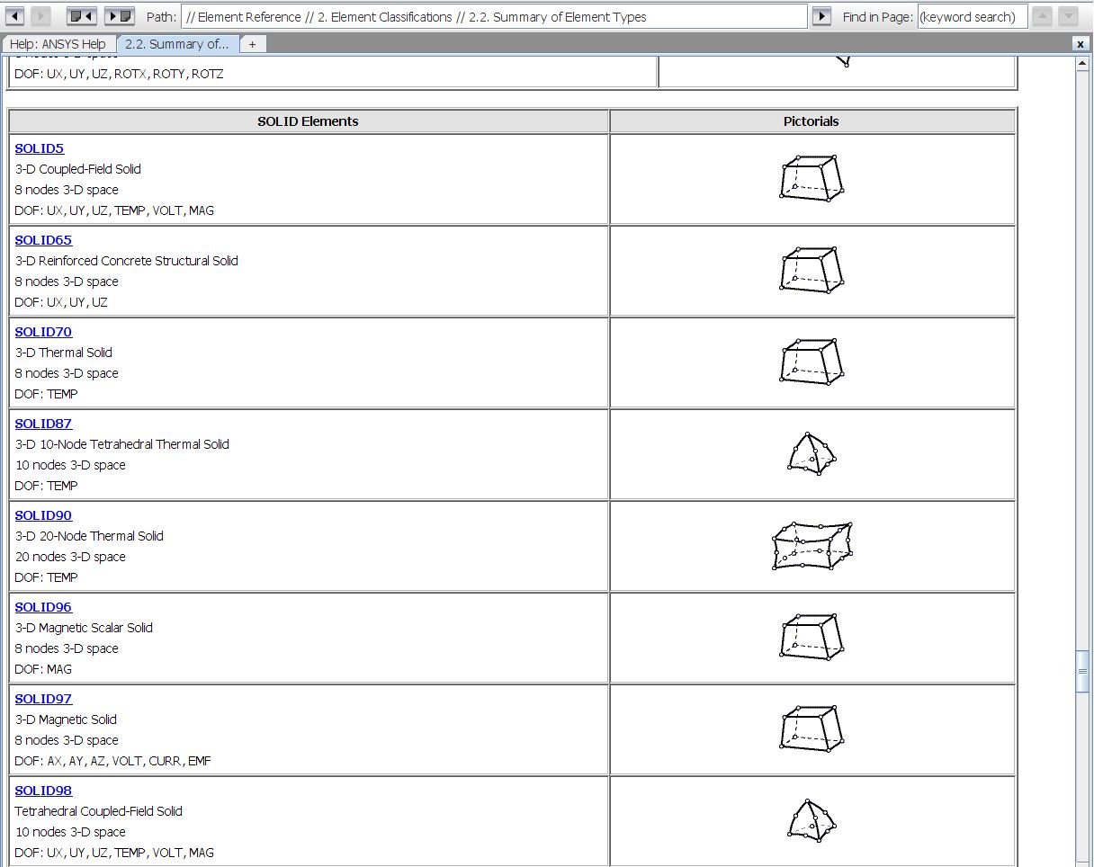

      I'm using ANSYS R14.5.
      Solid65 can be found in Element reference>Element classification>Summary of element type in ANSYS Help?
      SOLID65 is a Linear element so set the Mesh to use Linear elements.
