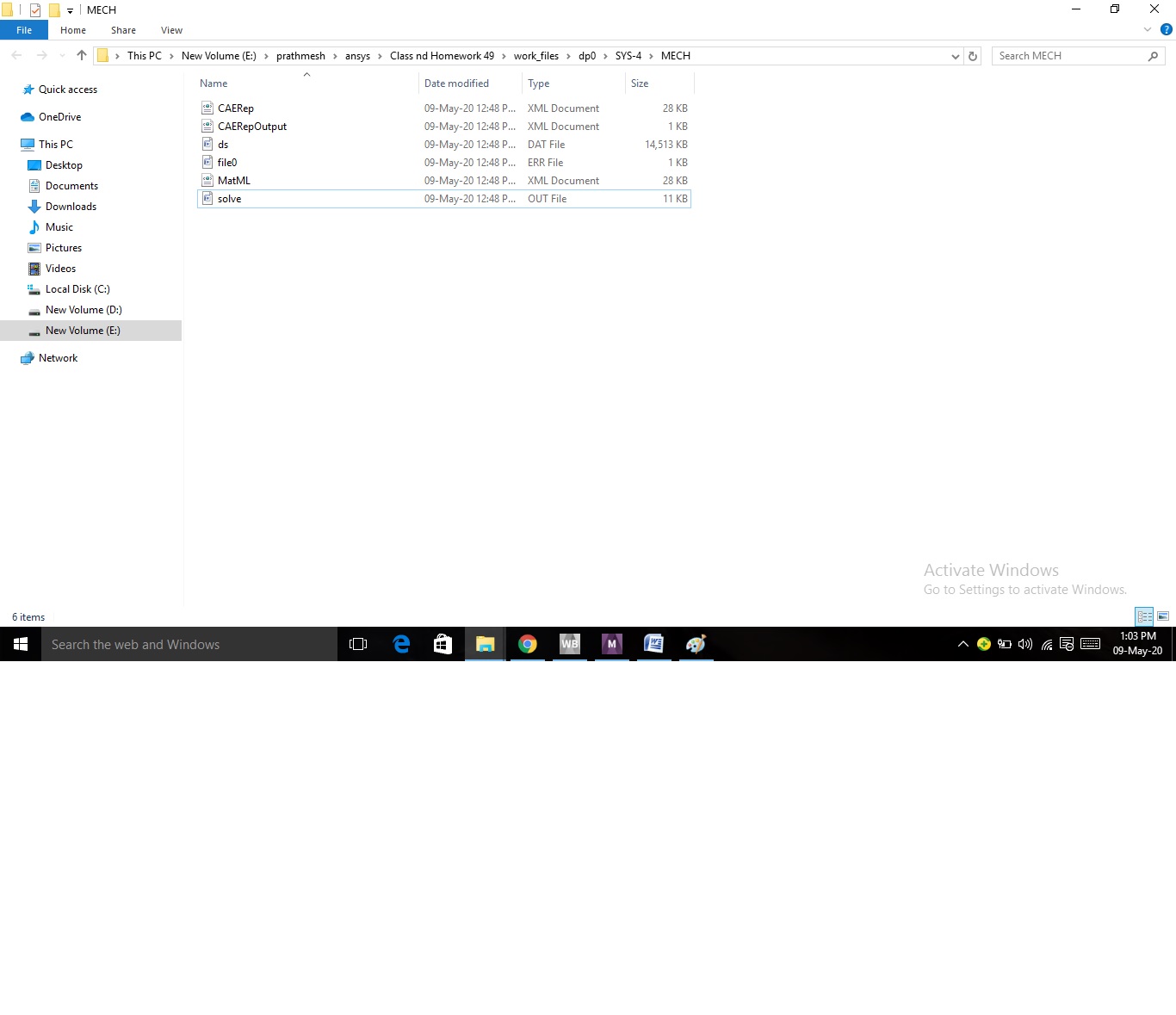

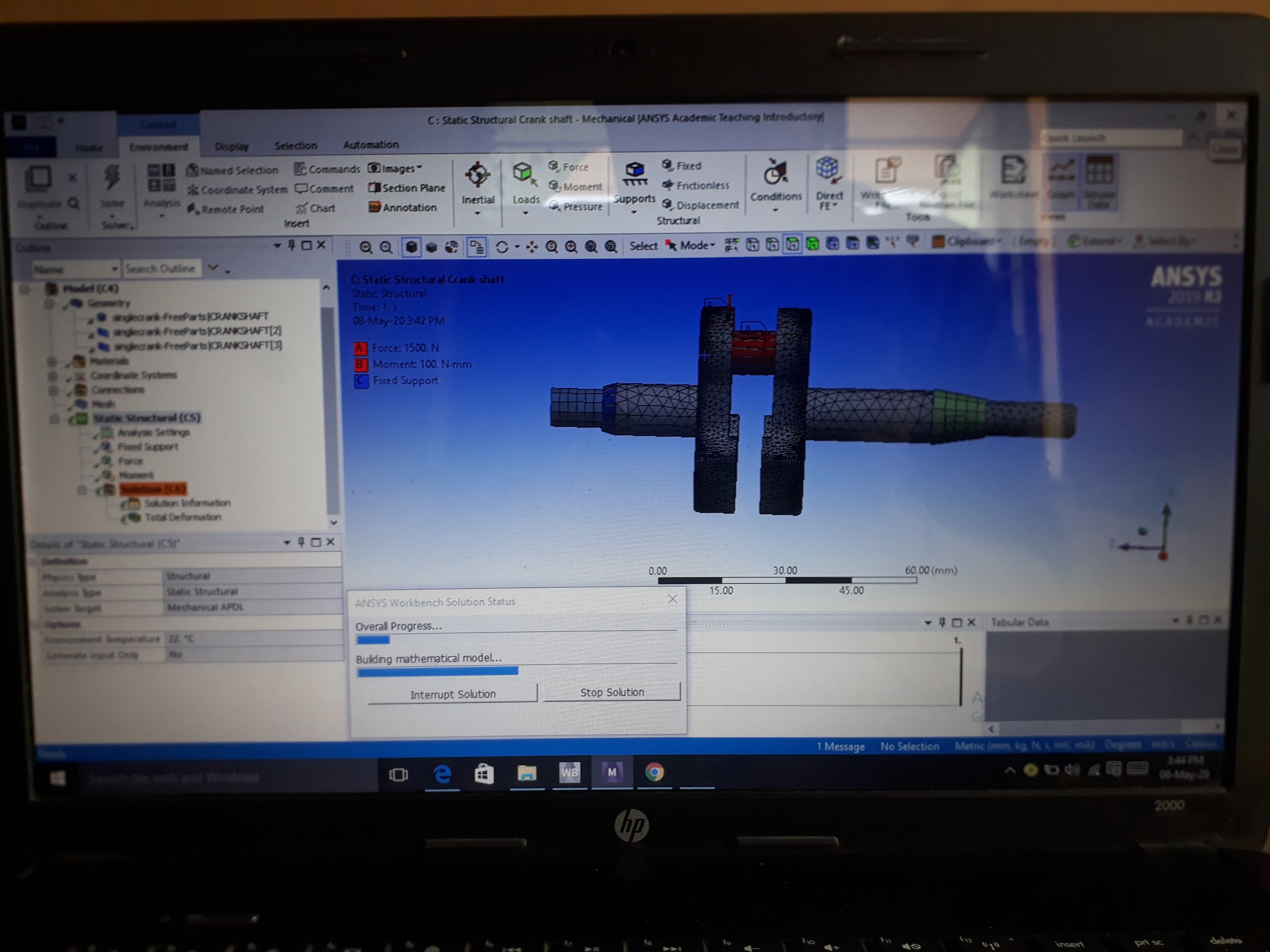

Ansys EmployeePrathmeshsanas2 Please right-click the Solution object and choose to open the solver files folder. Then screen-shot the contents and post it here. Next check the task manager, details looking first for ansys.exe does it exist? If so is it (or they) using a changing amount of cpu/ram/drive I/O ?
The most 'usual suspect' in this type of behavior are security type of applications (anti virus or malware, firewalls, etc) interfering with the proper start up of the solver.

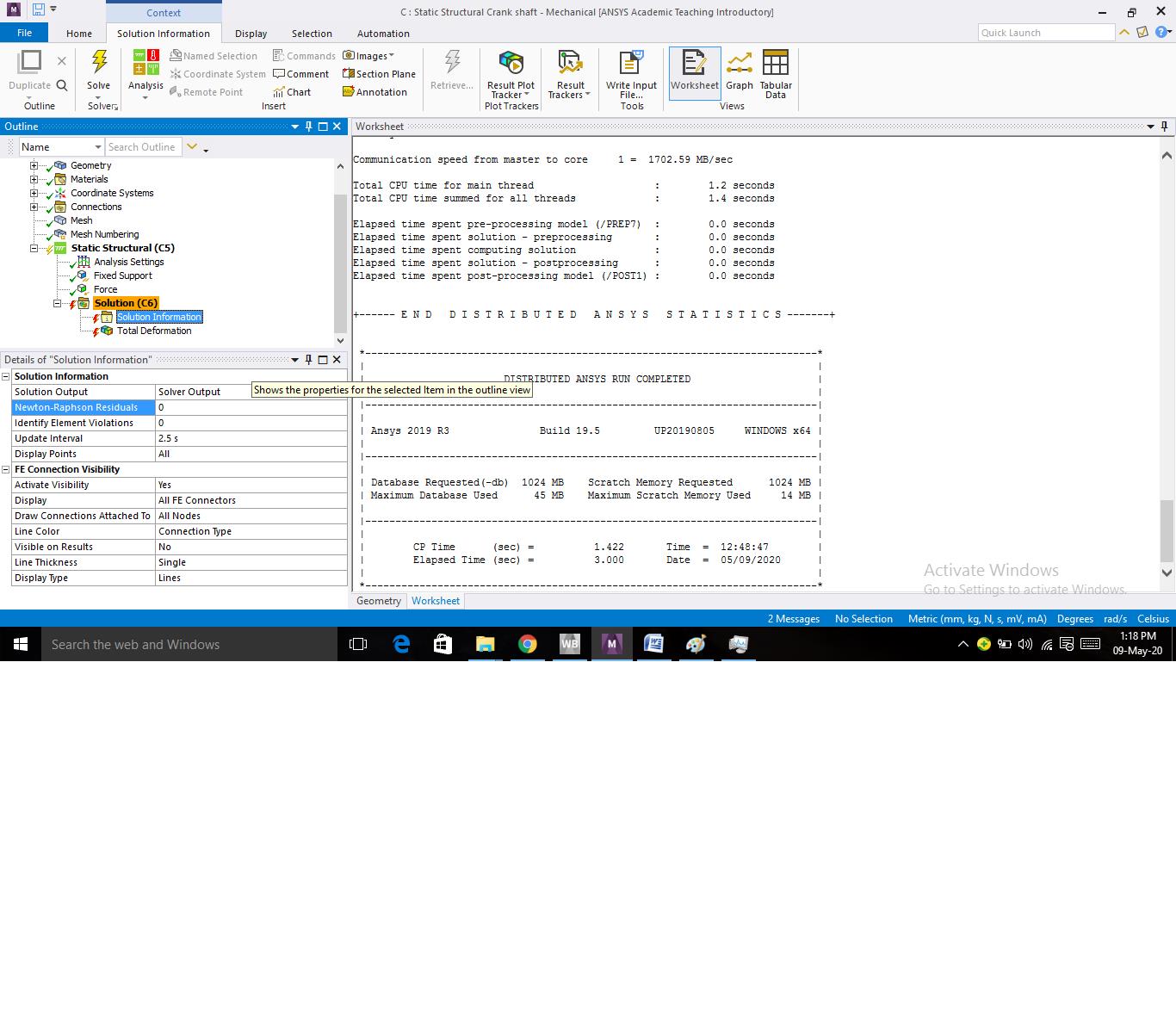

Please also post a screen shot of the output listing in the Solution Information object.

the contents are:-
