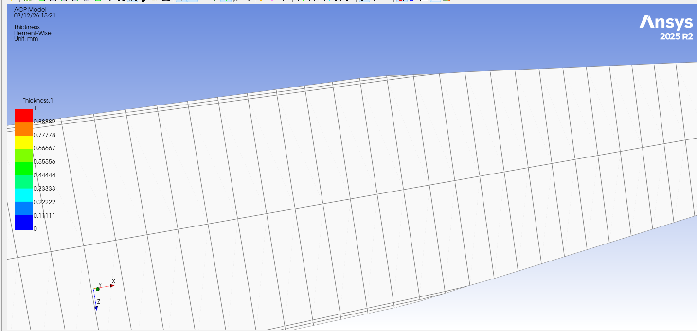

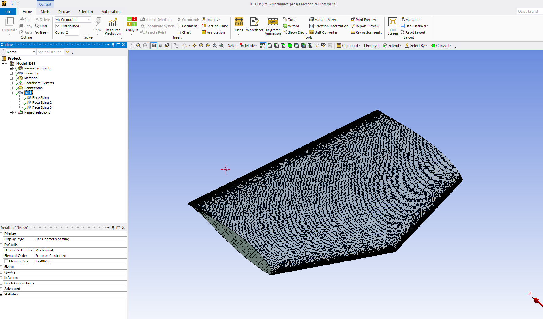

      I am currently working on a hydrofoil model using a NACA 63412 profile. I designed the geometry in Rhino 3D, then imported it into ANSYS SpaceClaim, and proceeded with the laminate definition in ACP (Pre) using shell elements for the foil surfaces.
      After defining the plies and generating the ACP solid model, I am facing an issue:
      • The top and bottom solid models are not properly connected
      • There appears to be a gap/opening along the mid-plane region
      • When transferred to Static Structural, the solid behaves as two separate bodies
      • Under load application, the structure does not act as a single connected foil
      My modeling workflow was:
      1. NACA 63412 geometry created in Rhino 3D
      2. Imported into SpaceClaim (STEP format)
      3. Shared topology applied
      4. ACP shell model created
      5. Cutoff plane defined at mid-surface
      6. Solid model generated using extrusion guides
      However, during solid generation:
      • I receive intersection and tetrahedron decomposition warnings
      • Some bad elements are deleted automatically
      • The final solid mesh shows separation along the mid-plane
      As a result, the structure is not continuous when transferred to Static Structural.

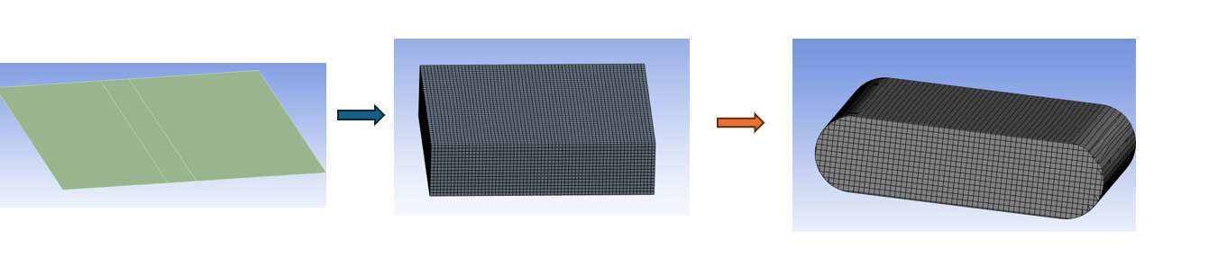

      Since this is a solid aerofoil structure, please start with a center shell plate and lay plies toward the topside and bottom side.
      While generating the solid, you can use either the cut-off geometry or the snap-to-geometry option to capture the actual shape of the structure.
      Please try this approach and let me know how it goes.

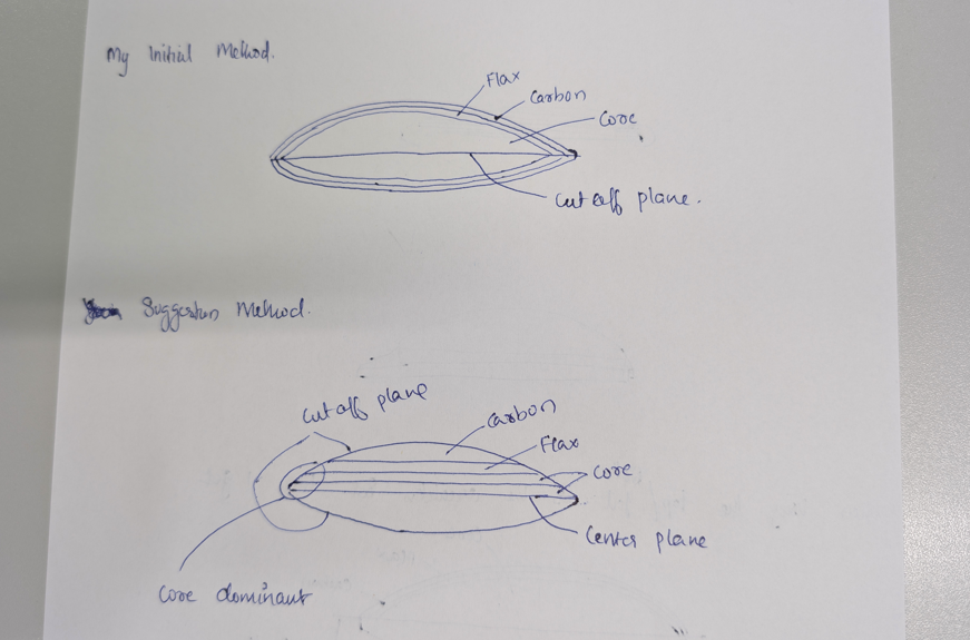

    • hakkeemnazar007
      Hello Raman,
      Thank you very much for your suggestion.
      I would like to clarify my understanding and explain the difficulty I am facing.
      Initially, my workflow was the following: I used the top and bottom foil surfaces as the reference shell geometry, and defined the laminate plies growing inward from both sides. The center plane of the foil was then used as the cut-off geometry when generating the solid model. However, with this method the top and bottom solid parts were not connecting properly, which is why I asked the question in the forum.
      From your reply, I understood that the better approach is to start with a center shell surface (mid-plane) and then define the laminate layup from this reference surface toward the top and bottom directions, using the foil outer surfaces as cut-off or snap-to geometry when generating the solid.
      However, I am facing a conceptual issue with this approach. In my case the laminate is a sandwich structure (carbon/flax skins with a foam core). If I start from the mid-plane and define the core layer first, it effectively becomes a solid block in the middle, and near the leading edge and trailing edge the core may reach the outer boundary of the foil geometry.
      In reality, the outer aerodynamic surface should be the carbon/flax skin layers, not the core material. Therefore, I am unsure how the correct skin-core-skin structure should be preserved near the leading edge and trailing edge when using the mid-plane approach.
      I have attached a simple sketch illustrating the two approaches I described for better clarity.
