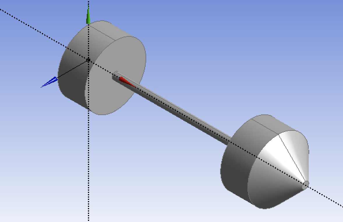

I am attempting to model combustion through a fuel grain and nozzle combination. I made the model in SOLIDWORKS as a solid, but during meshing and the rest of Workbench software the shape becomes hollow. I have tried unfreezing the geometry and adding material instead of adding frozen as seen in other forum posts, but this has not worked for me. Attached is the solid in isometric and section views. Any help would be appreciated.
-Nick
May 31, 2021 at 7:38 pmm.nikjah
SubscriberHello In DesignModeler, use "Fill" tool from "Tools" menu.
