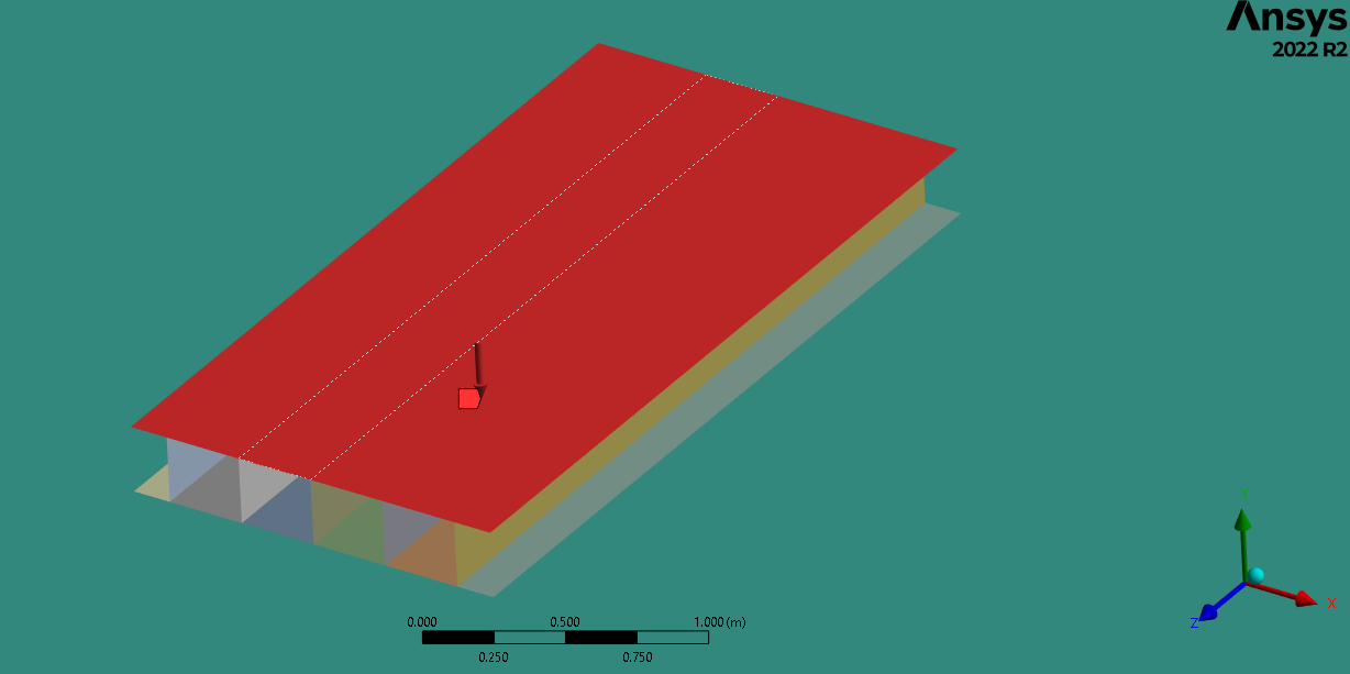

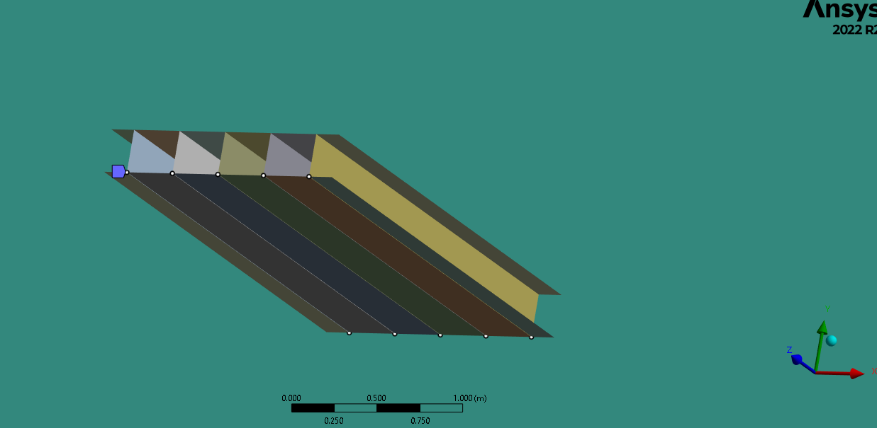

    • reymart laranjo
      Hi Peter,
      Please see below my model with supports and loading.
      My load is a pressure on top of I beams I have vertices as supports.
      rgds,
    • reymart laranjo
      I tried it on the solid model. It worked. But is there a way to do it on surfaces only?
      rgds,
      Attach a Modal analysis to the Static Structural model of the surface. Apply the same constraints to the Modal analysis. Solve the Modal and see if you have almost zero natrual frequencies. Watch the animations of those to determine which surface is not connected.
      Open the Surface geometry in SpaceClaim and on the Workbench tab, click the Share button. This will cause all coincident geometry to share nodes. Then rerun the Modal and you should get a non-zero first mode frequency.

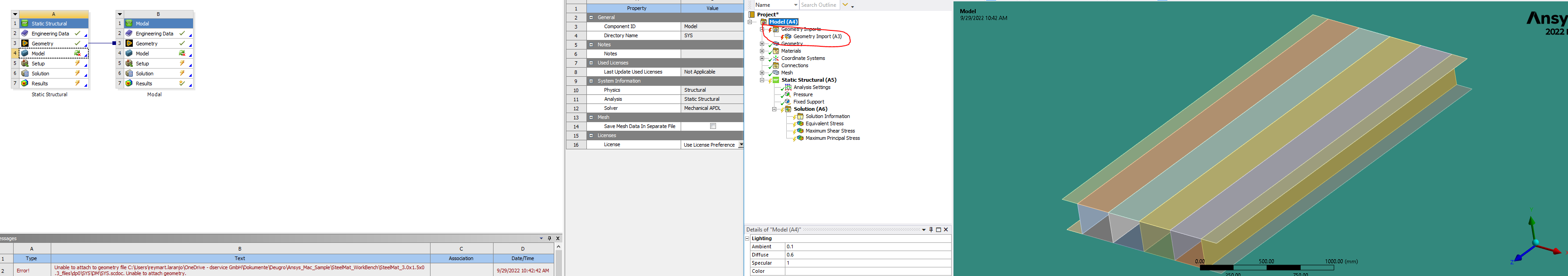

    • reymart laranjo
      Now i'm having this problem.
      Yesterday it was all good.
      In modal if i have 0 frequencies that means nodes are not connected right?
      Does the discovery has the same button as well share button? after clicking that button i'll just exit the space/discovery then that's it all nodes are connected?
    • reymart laranjo
      Hi Peter,
      Clicking the share button really helps it worked now!
      Thank you so much.
