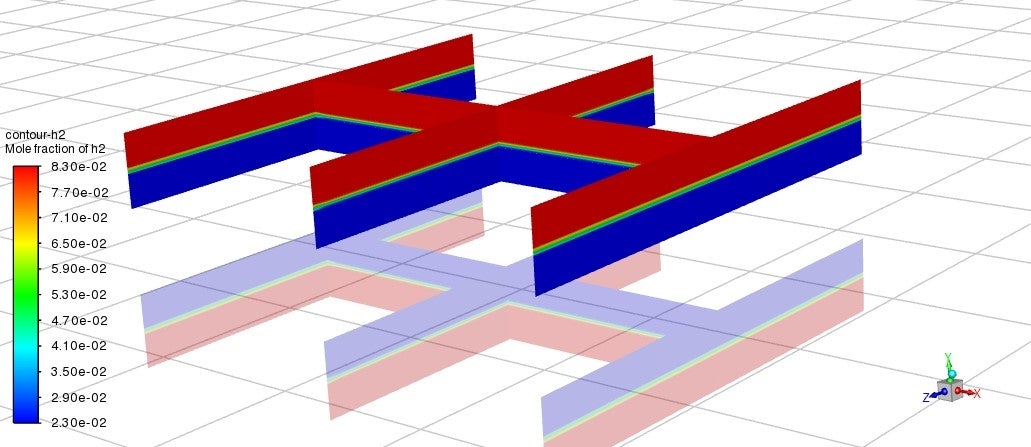

- Model 3 electrolysis (3D) is running and converging, but does not show any change to the H2 fraction (it remains close to the value set at the inlet across the whole gas channel length), as shown in the contour plot below;

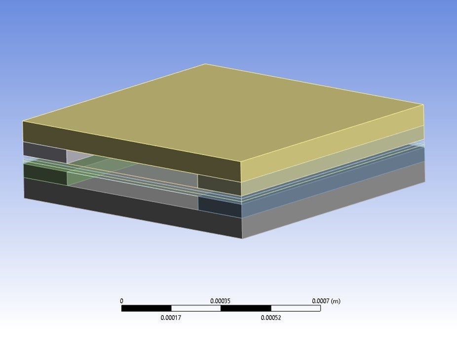

Could you explain, please, how to avoid the sigsegv error when working with my own geometry?
I have tried the SOFC tutorial geometry in the electrolysis mode, and it is possible to initialize the solution and get some results. However, when I draw my own simple planar cell geometry (CC-GC-CAT-ELE-CAT-GC-CC) and set the electrolysis mode, following all tutorial steps, except loading the user expressions (because they are for SOFC), what I get is sigsegv error after the initialization, and Fluent shuts down. If this is Standard initialization, it is just the error code in the consol and shut down. If this is the Hybrid initialization, Fluent spells in the consol “Hybrid initialization is done.”, then SIGSEGV error and shut down.
I understand this likely means that some physics is defined incorrectly, but it is not apparent, unfortunately. The last thing I tried: I followed the meshing guidance, specified in details in the PEMFC tutorial, so this is not the mesh accuracy problem. It would be good to have your perspective on this.

Please let me know what was the error message with the standard initialization. If you patch each solved variable individually, do you have the same error? If so, at which point?
For the hybrid initialization, SIGSEGV is a segmentation violation error and it means that something is either missing or being specified inconsistently. I presume you are using the "Fuel Cell & Electrolysis" module. The first thing that catches the eye is the (CC-GC-CAT-ELE-CAT-GC-CC) sequence. I'd assume that CC stands for Current Collector, GC - Gas Channel, CAT - catalyst and ELE is the Electrolyte. Where is the porous gas diffusion layer that connects the current collector and the reaction zone (catalyst)? Can the current flow through it?

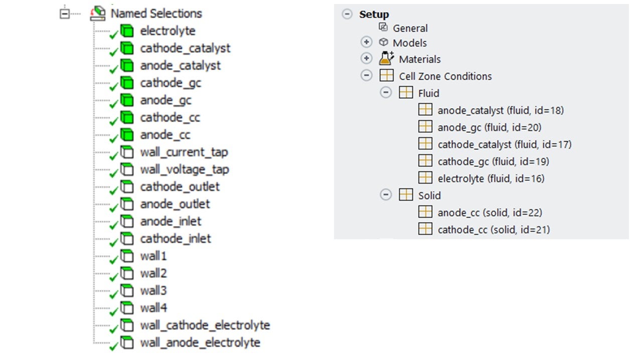

Ok, if the Unresolved Electrolyte SOFC module is used then the catalysts and electrolyte cannot be specified as designated separate cell zones. This is the simplification of the module. This is likely to be the source of the problem. There should be a way for the electric current to flow from the reaction zone to the terminals.

Could you, please, reiterate about the cell zones? Currently, at the Mesh, I make the Named Selections for the planar cell, as in the image below. Do you mean that some of them should be deleted from Mesh for the Model 4 to work?
Currently, the list of cell zones (in the other image below) appears to be consistent with the SOFC tutorial, except there is an extra “electrolyte” layer. I have tried not to name-select the electrolyte body at Mesh, but the Model 4 in this case will create this layer on its own in Fluent, so I am trying to keep naming everything myself, just not to be lost in names.

Yes, partially, thanks to Aleksey. The main mistake I was making was _drawing_ an actual electrolyte layer for the Model 4 (unresolved electrolyte). You have to draw cathode to anode as surface to surface, with no gap between them, so, basically, you split the electrolyte between these two layers. Then you make sure to define them as proper boundaries. So there is no electrolyte layer there, just surfaces.
If you keep trying with Model 3, you need to _draw_ electrolyte as a layer.
I hope that helps.

You mentioned in the post with your problem, that the simulation produces the hydrogen. This means, that electrolysis is working. What I do not see in the description of your problem is if you made any attempts to refine the mesh? You may try to check whether the current density and the H2 fraction change much with the mesh quality. Also, may be, the location/position of surfaces used for a display is different from the paper? Not sure, sorry.
