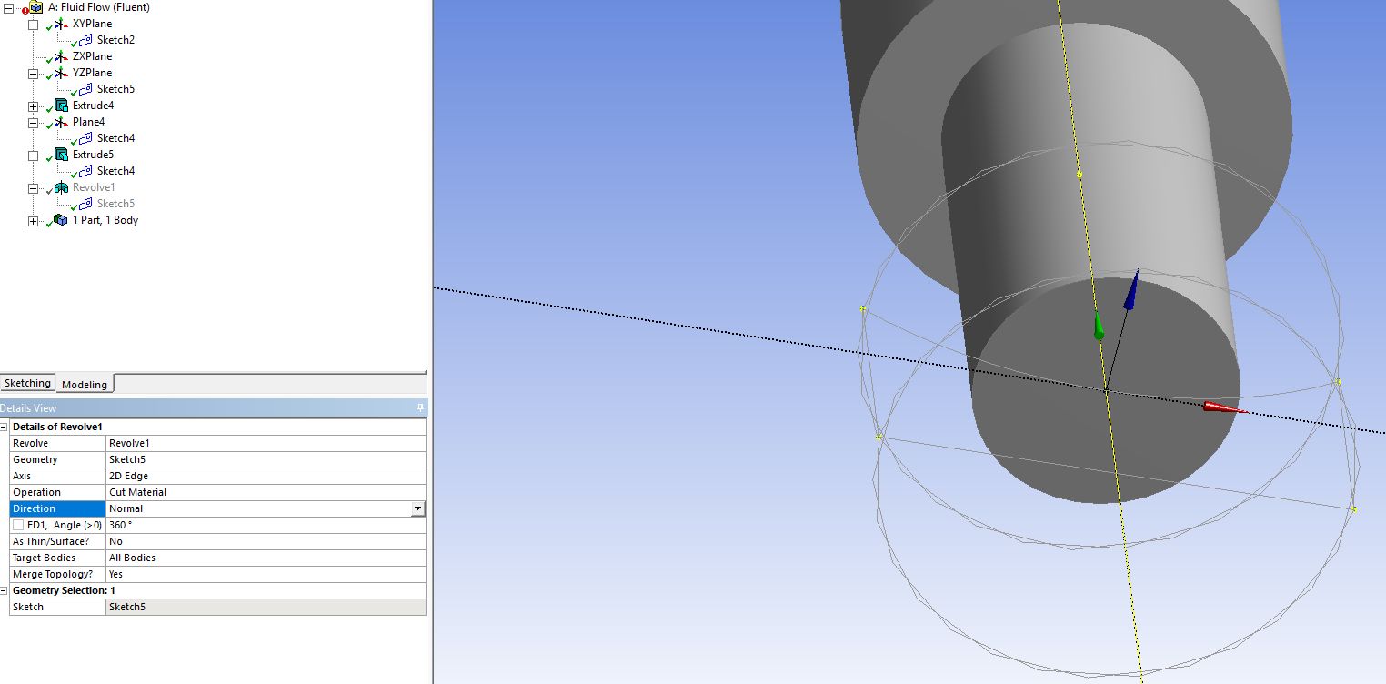

      So I have serious problem with one nut for engine and it does not want to create a sphere feature. So when I do a feature of Extrude, I do not have a problem to finish it with no problem, but with a revolve or feature of pherical object, it is not possible to finish it. This is needed to finish the featrue, but it does not accept feature, which I have there. So if you tell me what shall I do, it will help me a lot. Thanks You can see the feature with no effect of surface feature and with an effect which I tried on one cylindrical object and it has been done without any problem. Thanks Jiri

      You need a sketch of the part you want to revolve and an axis (either the coordinate system or a line in a sketch) and it should work. Please can you add a screen shot of the Revolve6 showing the settings (right click and edit).

      And view for the Revolve6 as mentioned. Thanks
      Which edge do you have selected, and is there an error message? Try extending the bolt by a small amount too: if the highlighted sketch isn't quite overlapping that can cause non-manifold bodies to be created (or rather it'll complain and not do anything).

      Right, now you've shown the graphic I think you need to change the sketch about 3 posts up. If you're revolving the (yellow) sketch what will happen to the material as the two parts revolve around the centre line?
      Remove the lower half of the sketch (ie the part below the axis) and try again.

      No, the sketch you're revolving crosses the axis: alter the sketch so this doesn't happen.

      The sketch is the thing being revolved around the axis. Either sketch your entire closed sketch on one side of the axis, and revolve it 360 degrees, or revolve the sketch you have, 180 degrees.

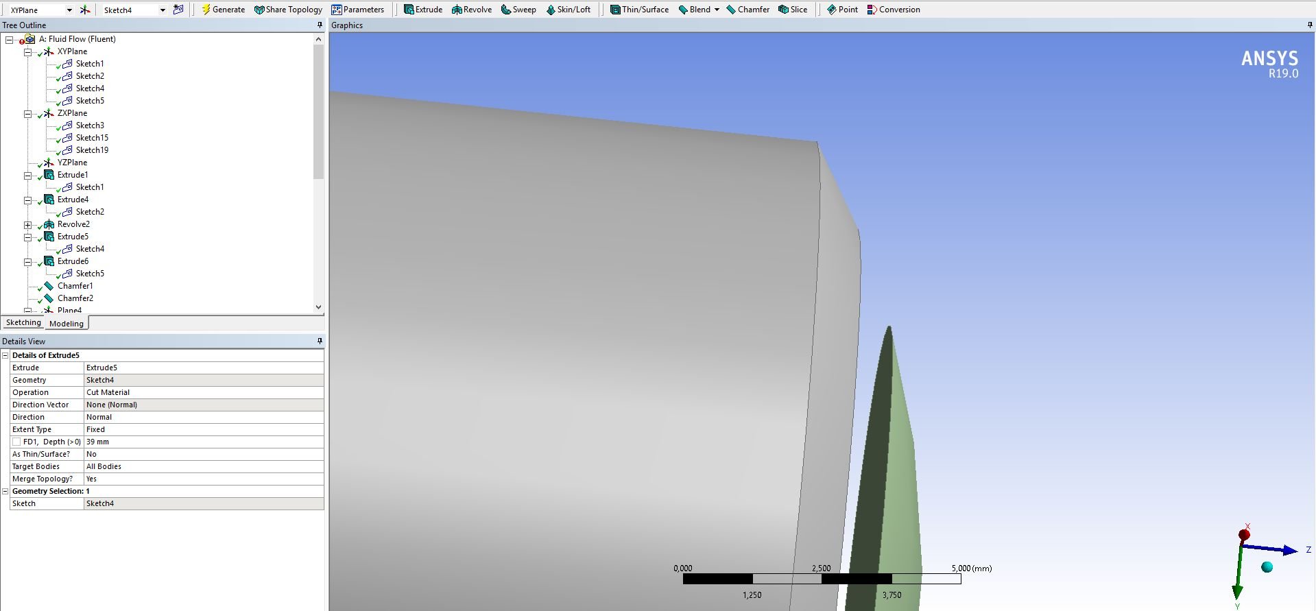

      Hello, in order to have a look at my model, please I can show you what is happening. You can see that I can be creating the revolution there, however I cannot to finish it, there is nothing afterward this. So would you know what is the problem? It is to cut it with revolution, but afterwards nothing is happenig. So please let me know what is the problem. Thanks Jiri

      How many degrees rotation have you applied in the above image?

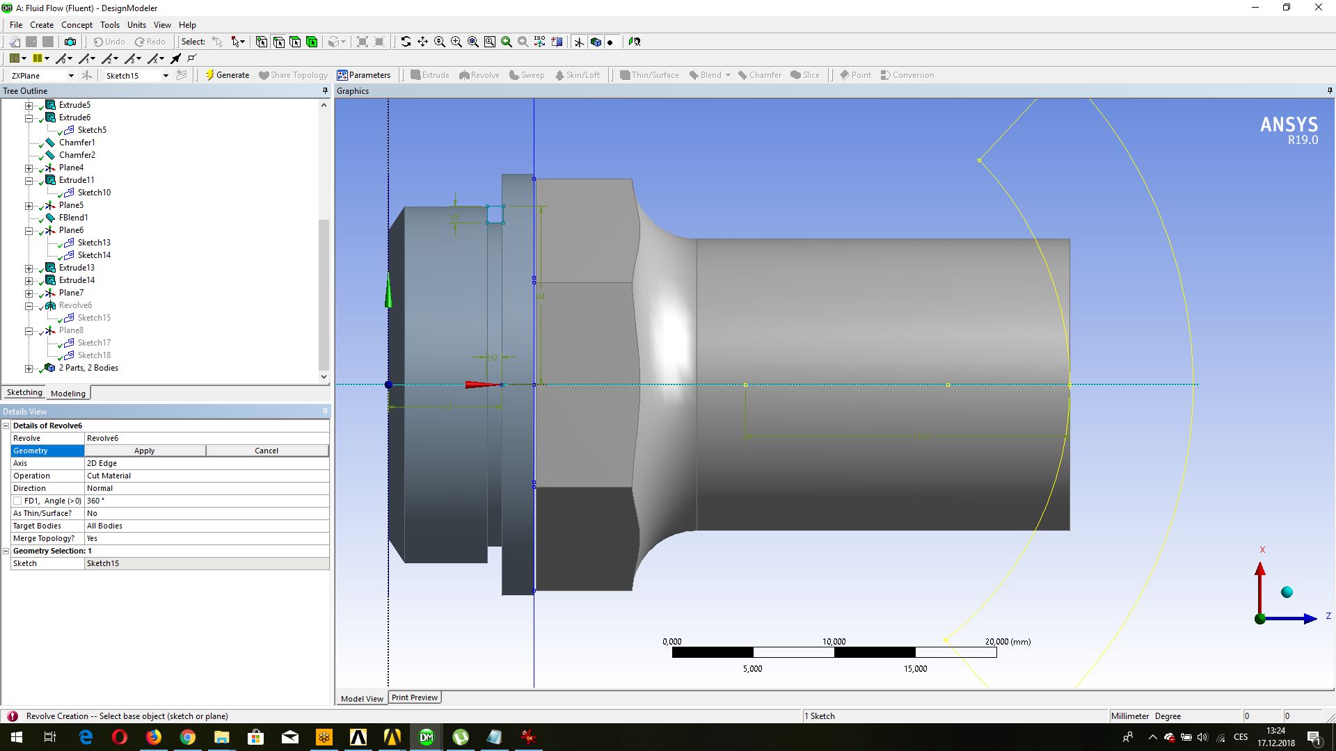

      The problem that I have made again you can see now on the picture and the same problem, the result should be as it is shown on the picture, but not possible and why - you know it very well, so please give me recommentation. Thanks. It shows that it can do it, but in reality it cannot!

      And if you just start to think a bit about this issue you will see that I have made the removal in the revolve position and you can see in the picture, that it does not have the whole wolume, but only for the added material and it is only plane, not a volume at all, so there is something wrong and I do not know what it is. So please start to think about this issue. Thanks
