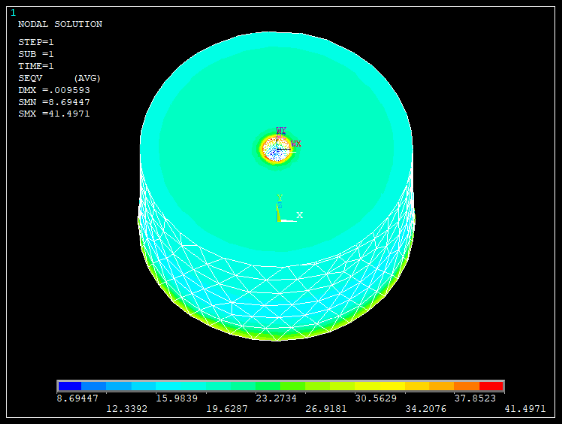

SubscribernHello Keyur,nyes I can provide some pics if this helps. Since the spherical void is the region of interest, the mesh there should be fine. In order to use fixed sized mesh, the element size have to be very small and I can only use 8gb. I have used the smartsize command [smrt,1] for this problem, which gives good results and the void region mesh is also fine. I can find out the number of elements used ( LIST -> elements), but I also wanted to know the smallest element size used after the calculation. If there is way to find that out, i would be very thankful. The script with the commands are the following:n/clearn/prep7nET,1,solid187Â Â Â Â Â Â Â Â Â Â Â Â Â Â Â nMP,EX,1,205000Â Â Â Â Â Â Â Â Â Â Â Â Â Â Â nMP,PRXY,1,0.33Â ncyl4,0,0,50,,,,100nlocal,11,0,0,0,50nwpcsysnsph4,0,0,5nvsbv,1,alln!ESIZE,2.5nSMRT,1nVMESH,3n!EREFINE,ALL,,,1nSFA,2,,PRES,-20nDA,1,ALLn/SOLUnSOLVEnFINISHn/POST1nWPOFFS,,,2n!WPROTA,0,0,0n/CPLANE,1Â Â Â Â Â Â Â Â Â ! Cutting plane defined to use the WPn/TYPE,1,5Â n/EDGE,1,1,45nn
