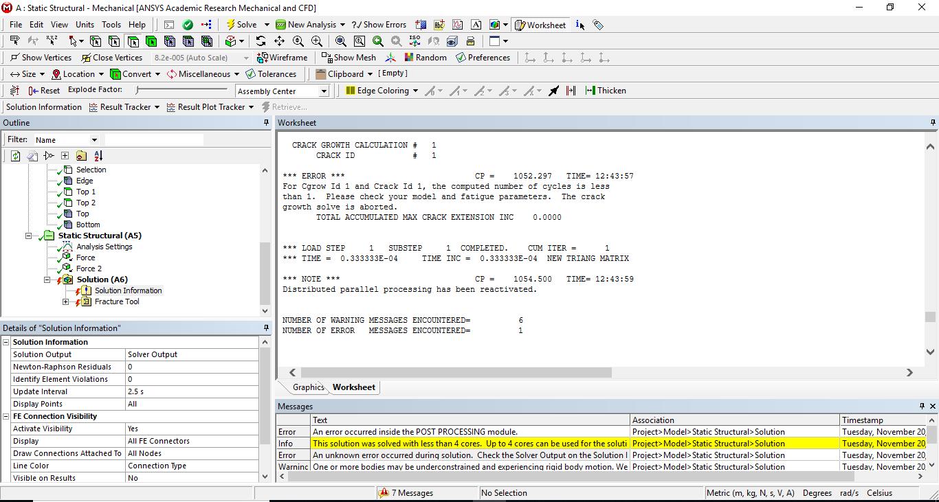

 *** ERROR ***                          CP =     43.484  TIME= 20:47:26
 For Cgrow Id 1 and Crack Id 1, the computed number of cycles is less  Â
 than 1. Please check your model and fatigue parameters. The crack   Â
 growth solve is aborted.                                              Â
       TOTAL ACCUMULATED MAX CRACK EXTENSION INC   0.0000  Â

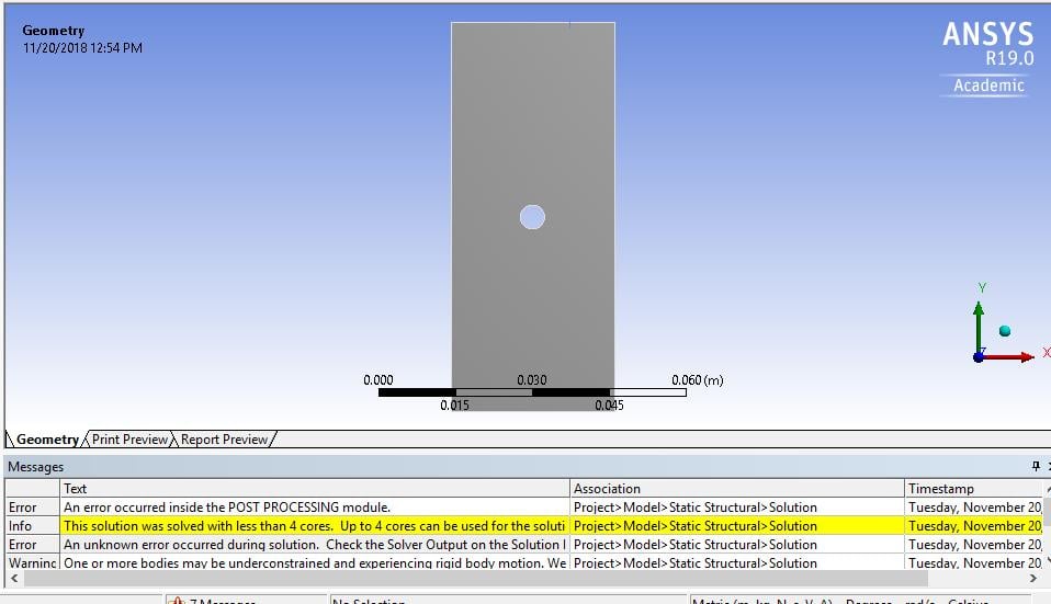

I am running Analysis on a specimen that has a rivet hole in the center and a small notch that Is cut into the right of the hole where the crack is suppose to start and propagate the material is Aluminum 7075-t6 .force is applied to the
top and bottom faces of 5000N. I am basing this Analysis from experimentation. In the experiment the forces were applied over 30000 or so cycle and the crack length was monitored. I am trying to simulate this fatigue test in ANSYS. I also do not know if I am inputting the number of cycles that I need ran correctly. I turned on the weak springs feature to give the structure some type of constraints.Â

Ansys EmployeeHi,
The message indicates that due to either 1) the magnitude of the applied load or 2) the Paris' Law constants, the analysis produces a solution that is not fatigue-driven (where crack growth evolution occurs over a large number of cycles), but rather sudden crack growth is occurring. Looking at your Paris' Law constants, I would check the literature or other sources to make sure that these are appropriate. Typically, for the material you're using, C is reported as being much smaller.
