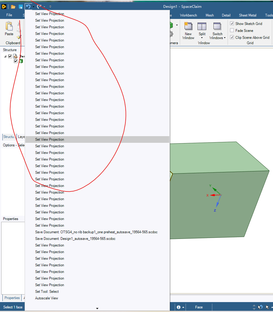

      I have used SC for a long time but recently I found something wrong with SC navigation.
      When I use mouse wheel to zoom in and out, the model visualization panel acting like frame by frame. And I found the zoom in/out behavior is recorded in history by CTRL + Z as shown below.
      It's quite puzzled. Any suggestions would be highly appreciated!!

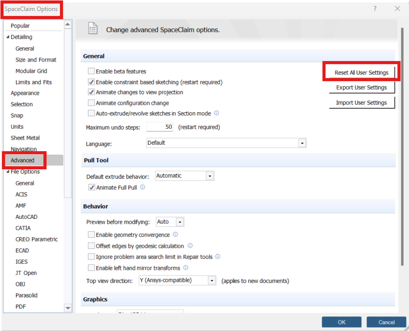

      Hi Dato,
      Please try resetting SpaceClaim to see if that helps:
      Devendra
      • Dato
        Hi professor,
        It doesn't work. I have rebuilded the geometry manually in another file since it's a large assembly with thousands of bodies. It worked but it's quite time-consuming.

        • Dato
          Oh, The problem occurs again for new manually created models and I haven't changed setting in SC. It seems like a bug. Crazy.
        • Dato
          I found that the problem occurred when I turn on the visibility of a component. It’s rather strange.
          Are there any possible solution? The problem make orientation react slowly when zooming using mouse wheel.
