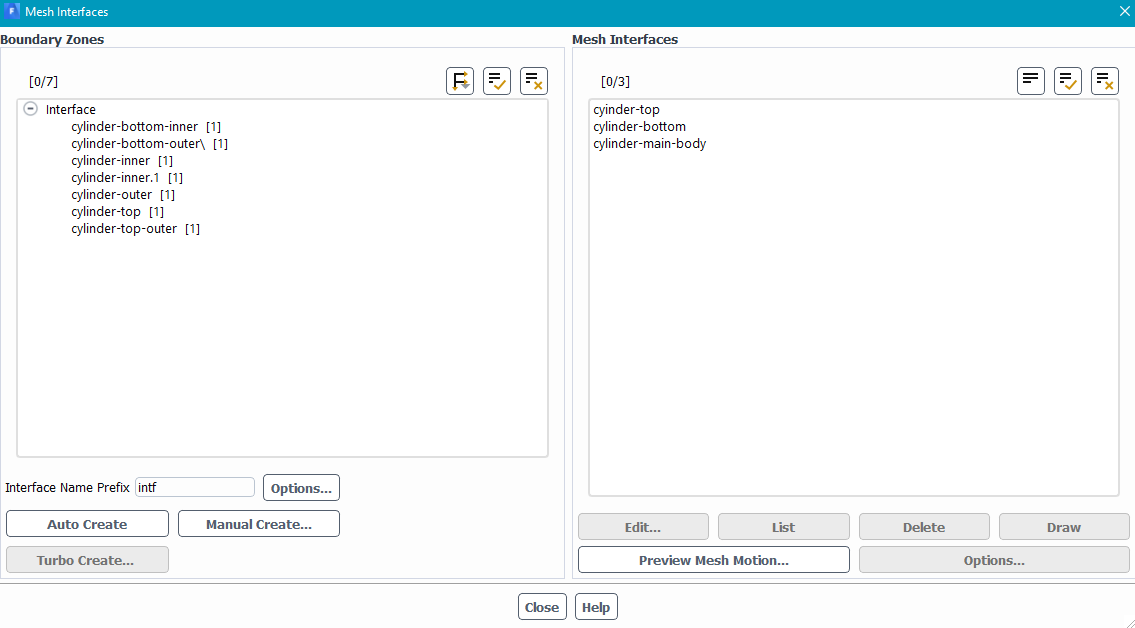

      Please can you share a screen grab of the boundary condition part of the tree and interface panel?
      • Thodorisdm
        I am not sure whether I included exaclty what you needed. If not, would you please elaborate more on the tree panel?
        Cylinder inner--> the interface of the rotating zone. Cylinder outer--> the interface of the stationary zone which coincides in the beginning with cylinder inner. Cylinder top and bottom are the interfaces on the top and bottom of the cylindrical cell zone.
      That'll do. The tree menu (left side) would show that you have interface zones: it's a common beginners error to think an interior is an interface. Those all look OK, my only concern is the precision of the axis definition. Depending on the overall scale I suspect you're off by a fraction, but that should just cause the moving zone to drift around and not effect the cell quality.

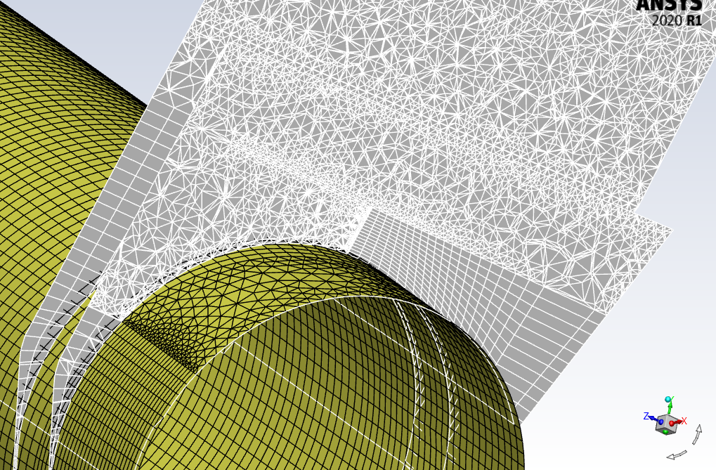

        The interface consists of both structured and unstructured cells because the cylindrical interface is enclosing an archimedes screw and it wasnt possible to create a structured volume mesh in all locations inside the cylinder.
      If the cylinder is eccentric it'll not give left handed faces as it'll just not overlap in places.  Carefully check the outer edge of the screw aren't part of a different surface (or interface) as if they're in close proximity in the CAD you might have either mislabelled or have a CAD tolerance issue.

        The outer edges of the screws are well distanced from the interface (picture attached). I also check it while in mesh preview; it doesnt intersect with the interface at all.
      How far are the blades from the interface?  Turn off perspective on the views as it only confuses things!

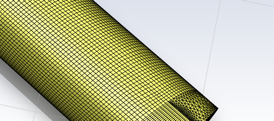

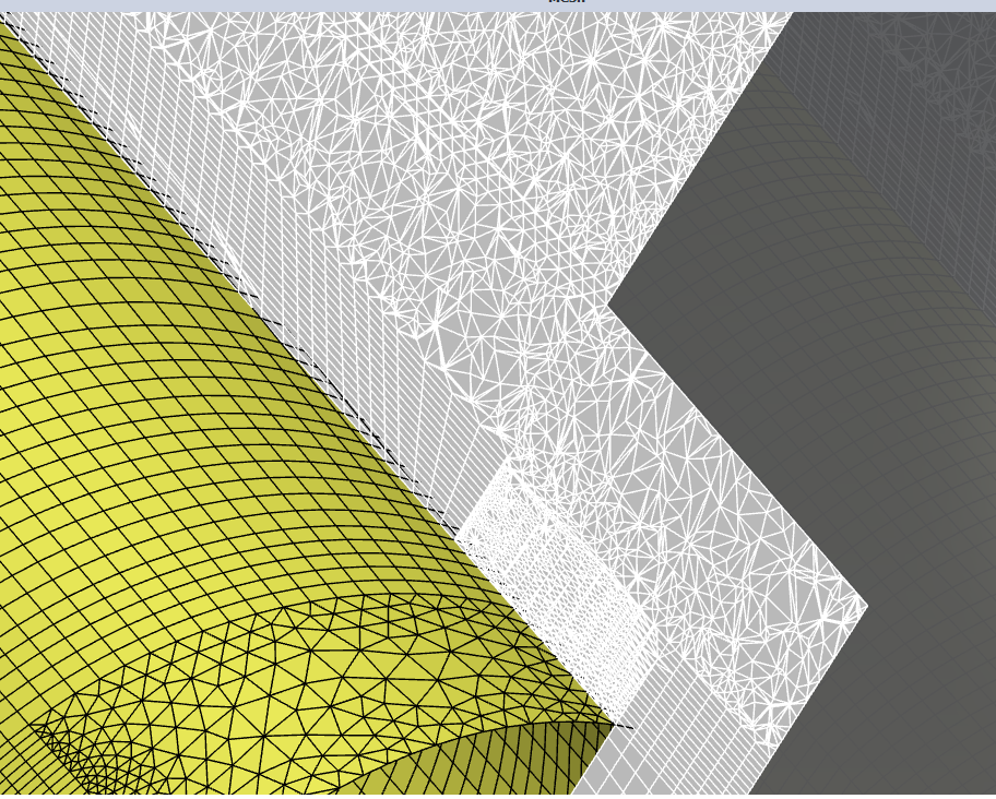

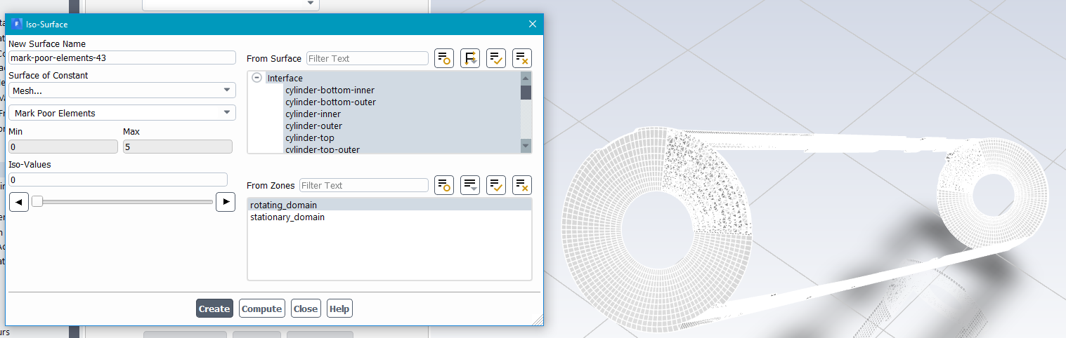

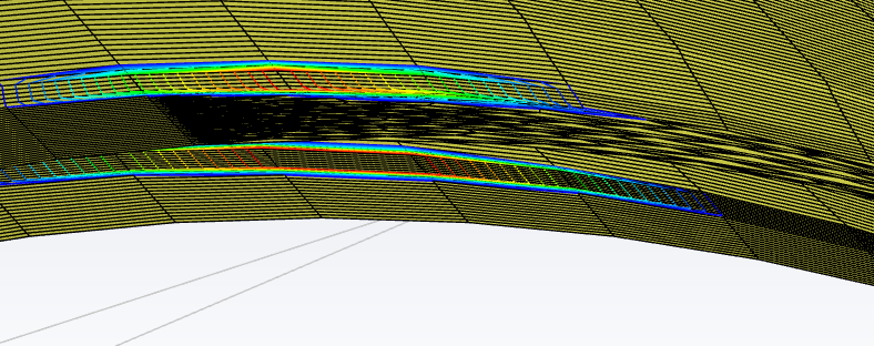

    • Thodorisdm

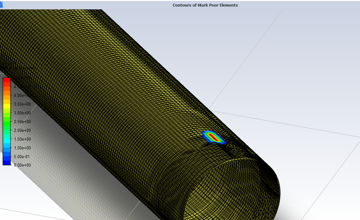

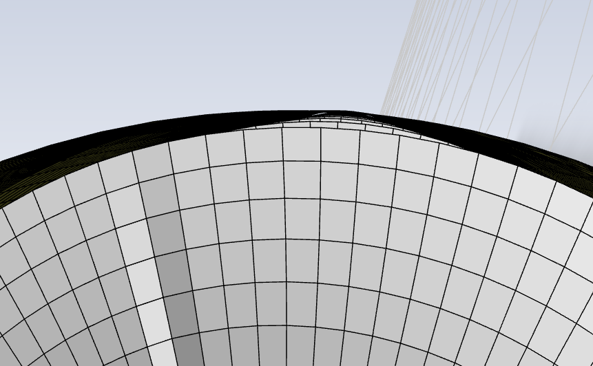

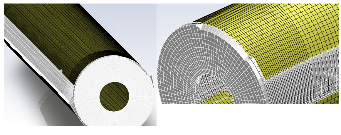

      I would like to give an example of the locations these left handed faces are created.
      In the first picture you can see the poor element at the outer part of the interface (stationary domain). In the 3rd picture you can see the poor element at the inner part, right below of the location of the poor element in the outer part.
      There is no corner, or sharp angle, I dont know what has gone wrong.
      It looks like something is twisting. How many rotating fluid zones are there? If you separate the stationary zone by region does anything happen (use report in that panel).

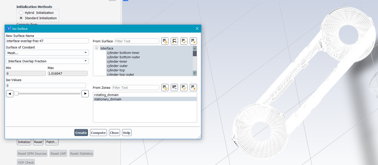

      That's interesting. As you are picking one of the cell zones, and you only have two labelled I'd not expect any separation. Create an isosurface of mesh that cuts through the axis of the rotating part, make sure you select the rotating zone when you create it: that'll give you a plane through the rotating zone. Repeat, but pick the stationary zone. How do they look?
    • Thodorisdm

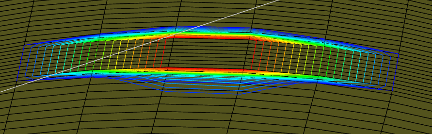

      Thank you for your reply. I chose for the iso surface the constant to be the interface overlap fraction.
      In the first images you can see how it looks in the stationary and in the last images you can see the rotating cell zone. It seems that the cells in the interface are distorted (I cannot explain by what). One initial guess would be the fact that I have interface in the top and bottom of the cylinder instead of having an interface only in the body of the cylinder, would that be valid?
      Stationary domain :
      For the rotating domain:
      I'd use constant x, y or z and make sure no surfaces were picked.  The intent is to see whether you've got any overlap or duplicate cells.

      Okay I did exported the iso surfaces at the locations where I get the left handed faces warning.
      Other than some suspect jumps in cell size it looks OK from an interface point of view.

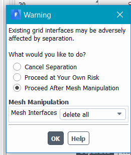

      Followed your suggestion, I deleted and appended the two fluid zones but I still get the left handed faces.
      While I was deleting the cell zones in my case files I got the following in the console:
      If you're deleting cell zones how are you retaining both inner and outer surfaces? The interface bc should be unique to each fluid zone.
