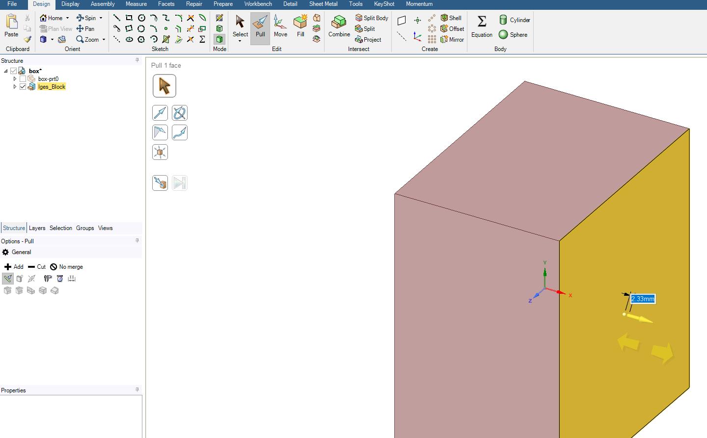

Sandeep Medikonda
Ansys Employeeeman,
 You can edit an IGES geometry in SpaceClaim just like any other using the Edit tools. Below, I show this for a simple cube using the Pull tool.
