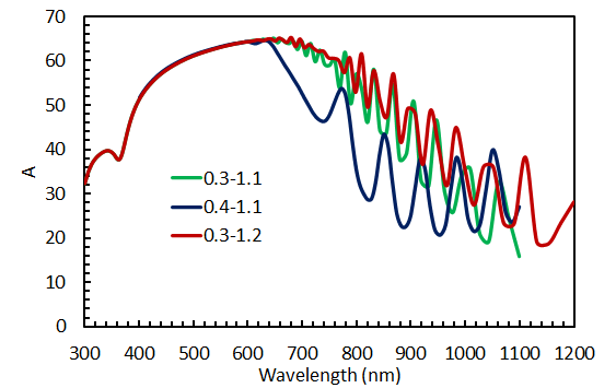

      I am trying to simulate the absorption of silicon with certain thicknesses, with and without surface texture. I started with just flat silicon with thickness 10 um on top of glass.
      First, changing the wavelength range changes the absorption spectrum (as in the figure below: the legend indicates the wavelength range in um). I understand that changing the min wavelength will change the mesh, but how would I know which is more accurate? I did convergence tests as in this link (https://support.lumerical.com/hc/en-us/articles/360034915833-Convergence-testing-process-for-FDTD-simulations) but nothing seemed to make a difference in the results.
    • Guilin Sun
      First, about change of wavelength: When your starting or stop wavelength changes, not only the mesh size may change, but the material fitting will also change. This means you may simulate different set of material data since fitting range is changed and Maxwell Equations only know the permittivity. I would suggest that you only simulate the spectrum range you are interested in, no need to change the wavelength.

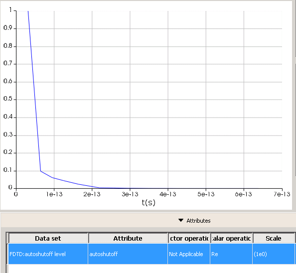

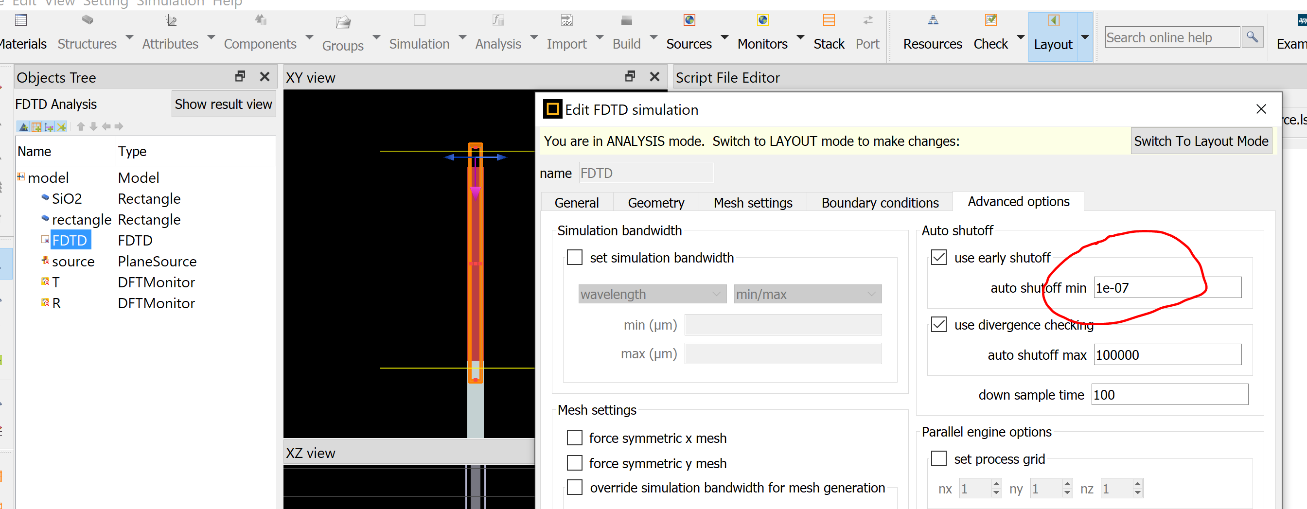

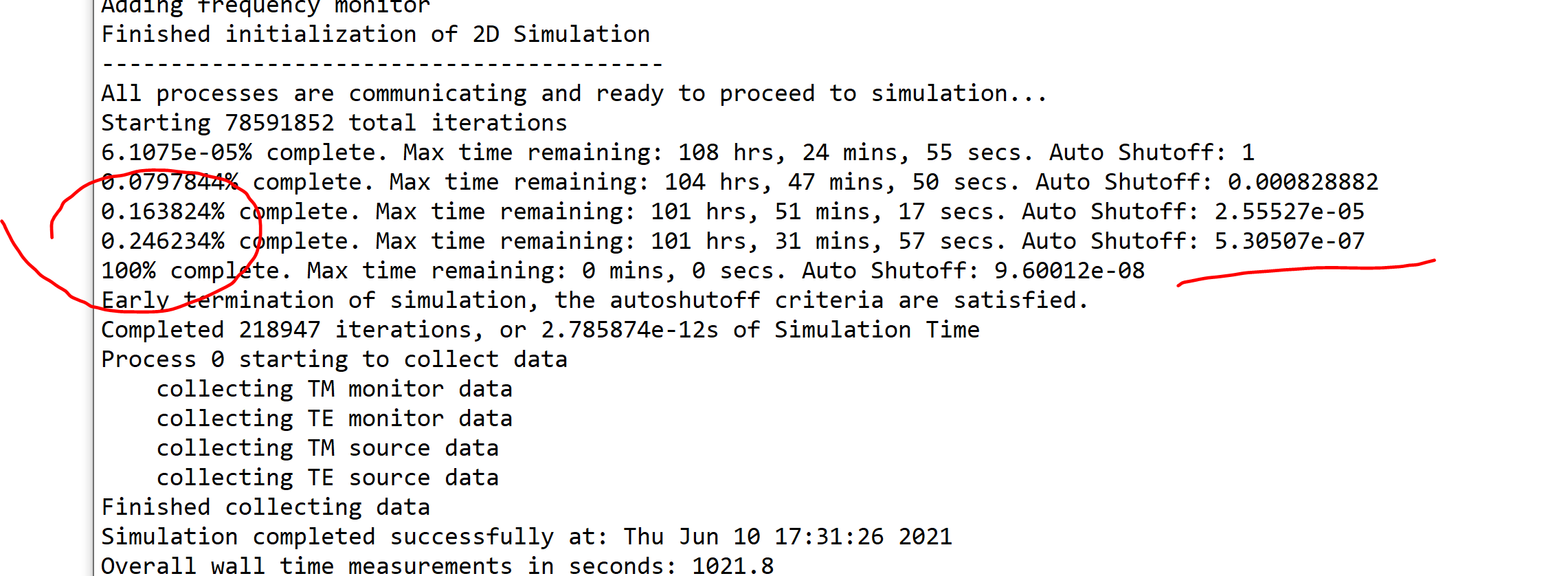

      The simulation does run to autoshutoff. I am not sure exactly what you mean by "autoshutoff min is small enough" . This is how the autoshutoff level looks like:

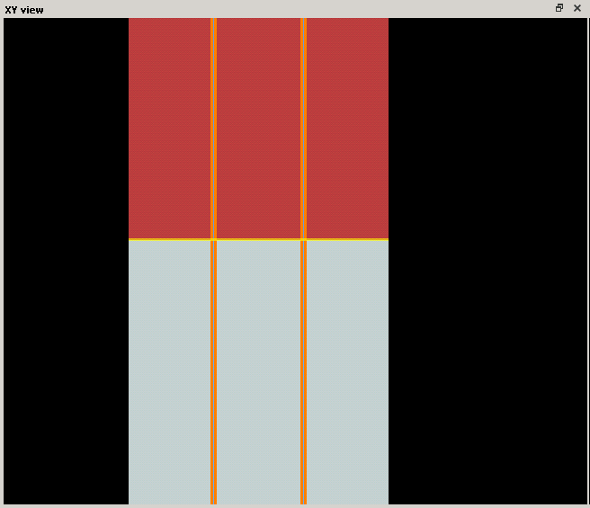

      Both the silicon and the glass substrate, as well as the monitors extend beyond the periodic boundary condition. this is an image of the interface:
      I also tried to put the transmission monitor slightly below the interface (into the glass substrate) but it did not make a difference in the results.

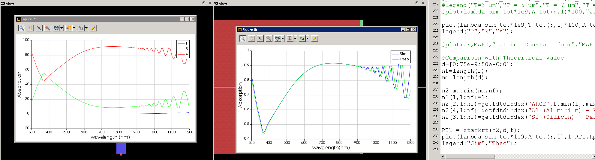

      I would suggest that you use stackrt to get the theoretical value and compare.
      I set up a simulation file by use of your data, and got
      Please make sure the simulation time is long enough that the simulation terminates before reaching 100%.
    • Sara91
      My simulated absorption is almost identical to yours. So at least for now, I am more confident in my simulation file/parameters.

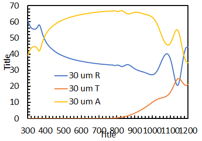

      I still have some problems with the results. I want to study a certain texture as a function of c-Si thickness, but first doing my calculations for flat silicon with various thicknesses. When I increase the silicon thickness to, for example, 30 um, both the reflection and transmission (especially the transmission) decrease significantly and more than expected. for example, the transmission becomes less than 20% in the NIR. This is not what you would expect from only a 30 um c-Si piece and does not agree with my measurements. I am wondering if you have some ideas in that regard.

      This is most likely due to insufficient simulation time. Please significantly increase the simulation time, eg, 10 times or more, and let the autoshutoff min to terminate the simulation, and less than , say 95% in the Progress status. After simulation you can check the log file if you do not watch the simulation progress.
    • Sara91
      I increased the simulation time from 3000 fs to 50,000 fs and the autoshutoff min from 1e-7 to 1e-10, but the results are the same in all cases and in all cases the simulation is terminated by the autoshutoff criteria (FDTD status is 2 and the log file indicated that "Early termination of simulation, the autoshutoff criteria are satisfied."

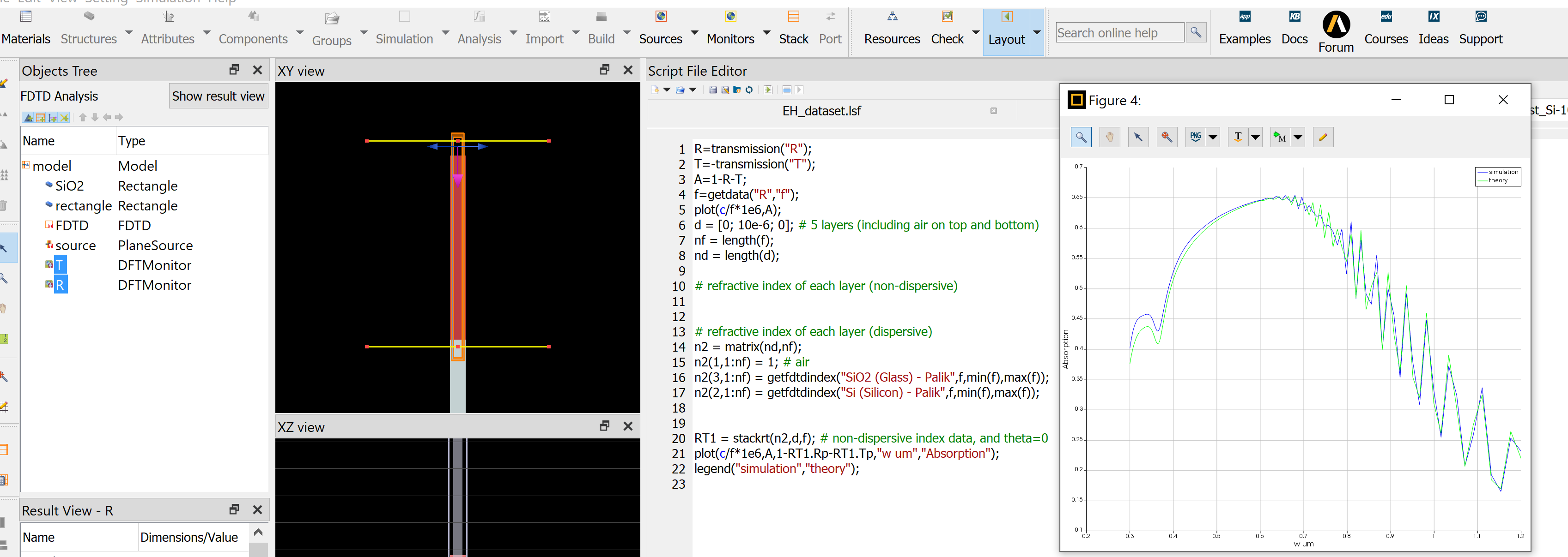

      HI, I used autoshutoff min 1e-7, simulation time 1e+6fs (too long,. You can use 1e+5fs), and got reasonable agreement with theory:
      So your simulation time is not long enough!
    • Sara91

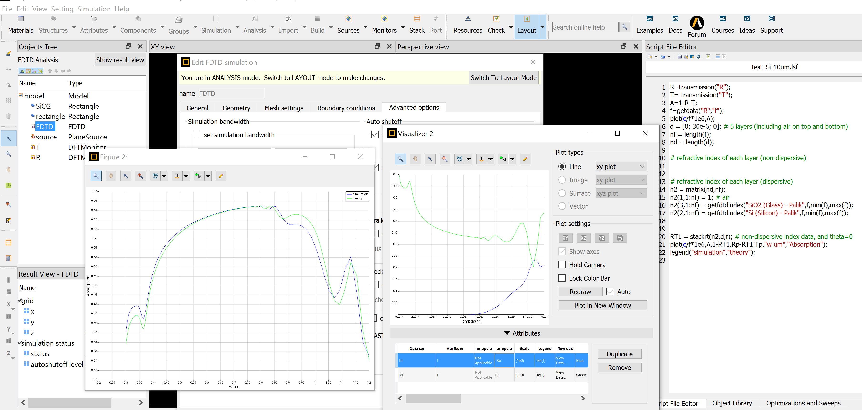

      These results are actually very similar to what I have:
      However, I still think there is an overestimation of the absorption in the long-wavelengths here.

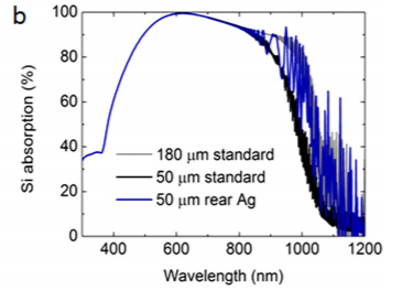

      For example, in this paper (also using Lumerical: https://www.ncbi.nlm.nih.gov/pmc/articles/PMC4018607/pdf/srep04939.pdf) the absorption of 180 um of silicon (with back reflector) is zero at 1200 nm. So it is unclear to me why I have this high absorption at long wavelengths.
      From the paper:
    • Guilin Sun
      Please note that for a cavity, its performance strongly depends on the cavity length and the mirrors. In the example you give, it has AL and SiNx layers as mirrors. Do you know their thickness? If you know, please use analytical method first.. I have verified my simulation result with this analytical method. We need to assure the result with solid theoretic base.

      The SiN thickness is 75 nm and I put the bottom PML boundary through the back aluminum. I compared the Abs to the analytical absorption and they do agree (as in the screen shot below). But still the absorption is very high in the NIR.
    • Guilin Sun
      It will be difficult for me to answer why the NIR region has high absorption. However as you have verified using theoretical method, I would suggest that you trust the theory. Do they use Al as substrate or it is part of the cavity? I would suggest that you only use analytical stackrt to justify your speculation. You can also find a formula from text book to do your own calculation.

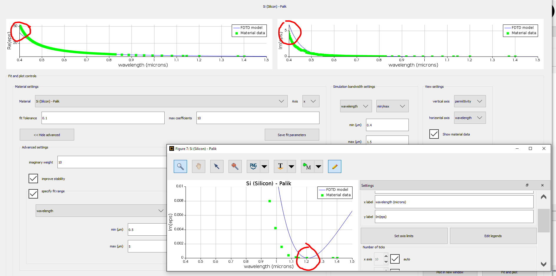

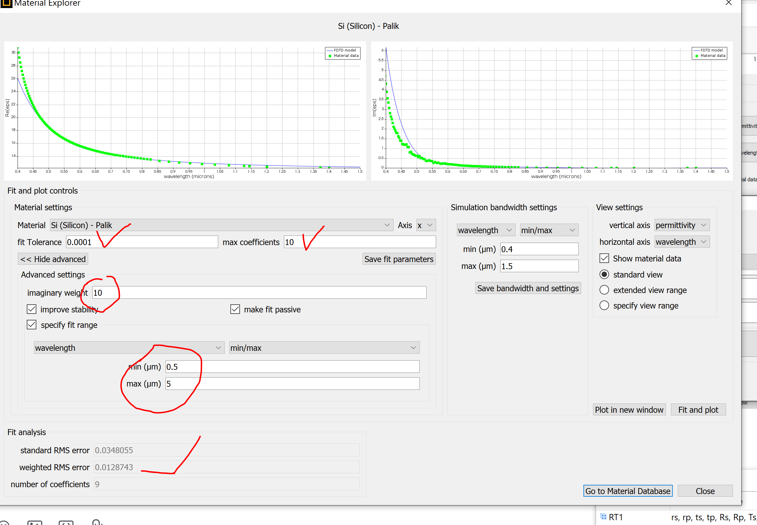

      My colleague @Kyle Johnson reminds me that, the higher than expected absorption may come from the material fitting model, where from the experiment the imaginary part of permittivity is practically zero. However the material fitting gives small yet non-zero values. You can play around for the material fitting parameters and try to find a better model. I found it is very difficult to get zero without sacrifice the overall fitting accuracy in this broadband. Depending on your specific goal, you may choose fitting parameters to stress the importance of the infrared regime, by specifying the fitting wavelength range and the imaginary weight:
    • Sara91
      I did what you recommended for the material fitting and it does make the results better in the long wavelengths range. However, as expected, it sacrifices the accuracy at short wavelengths. I understand that I am trying to simulate a very broadband range at once, do you think it is a good idea to split the simulation into two wavelengths region? for example, one simulation from 300 to 800 um and one from 800 um to 1200 um? I tried to do something like this previously, but I was encountered by the problem I was talking about in my first post (i.e. I get different results when I change the wavelength range).

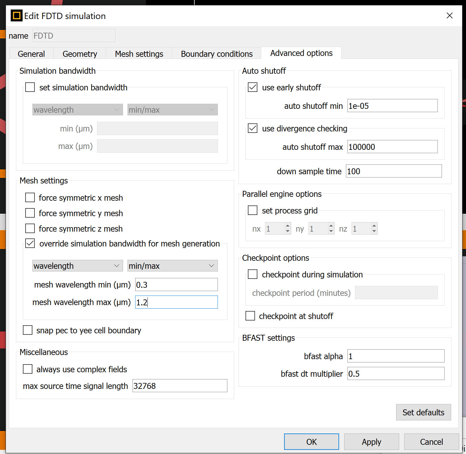

      You can do so but as mentioned before, if the bandwidth for simulation is not fixed, then the result is not continuous, since the material property and the mesh accuracy is not the same, But you should not get the result similar to the first post, as you will have 2 or more simulation begin and stop wavelengths. For example, you can simulate 0.3~0.7um and 0.7~1.2um. The only drawback is at 0.7um the result is different, due to known reason. So in many cases there is always a kind of compromise that you can choose to alleviate some issues but create other issues. I would suggest that you can fix the mesh generation bandwidth:
      this can make sure the mesh is the same, so to leave only the fitting that causes such discontinuity. Sometimes such discontinuity can be small.
    • Sara91
      I tried it manually (dividing it into two wavelength range) and the results look good so far, and fixing the wavelength for the mesh as you suggested helped to make the discontinuity very small.
