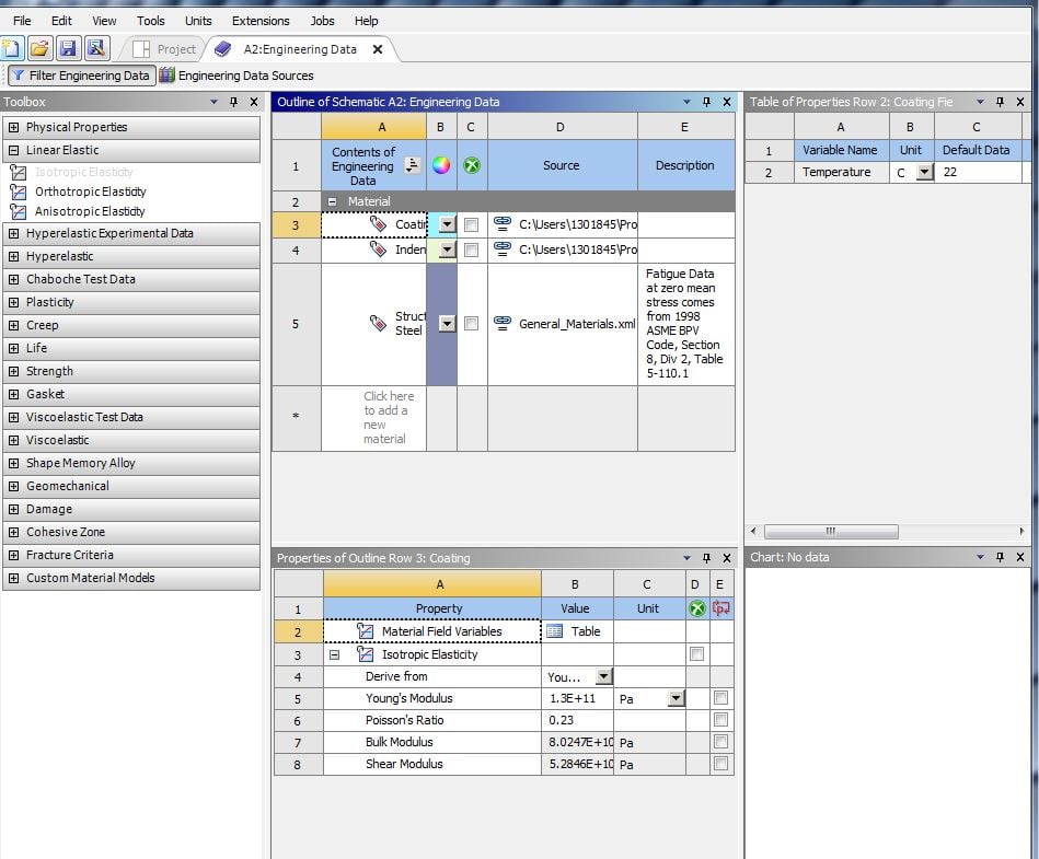

      (4) You must have plasticity in the material model for the sample, preferably Multilinear Plasticity.
      Question:
      What do you mean by this and how is this done? is it something to do with the properties of the material in engineering data?

      In order to have permanent deformation in the simulation, you have to have a plasticity material model.  Without plasticity, you can only create deformations that are elastic.  To limit the deformations to the elastic range, you can't have an infinitely sharp point on the indenter, since that creates an infinitely high stress (zero area). You could have a ball indenter.
      To add plasticity to a model, you just drag a plasticity model from the toolbox onto your material, but you have to have the data to fill out the parameters.

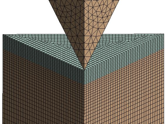

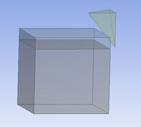

      Here is a small model with 1/4 symmetry.

      In ANSYS, when there is a bond between two materials such as a substrate and coating, they can each have their own material properties, and the two bodies which share a common surface can be meshed so that they are sharing common nodes on the shared surface. That means there is no need to use contact elements to connect the two bodies. You can post-process the stress for each body without averaging across the bodies.
      I duplicated Coating and Structural Steel, appending EPP to the names.  I added Bilinear Kinematic Plasticity to each EPP material and entered a yield strength of 250 MPa just for the purpose of a demo. You can type in another value. By typing 0 for the Tangent Modulus, that creates an Elastic, Perfectly-Plastic material. As soon as the material reaches its yield stress, the material flows plastically.
      When I get a model that makes some progress, I will attach it for you to use.

      That would be extremely helpful if you could send me the model. Also, when you when you said "By typing 0 for the Tangent Modulus, that creates an Elastic, Perfectly-Plastic material". Does this mean elastic plastic?
      Elastic Plastic and EPP mean the same.  When you replace the 0 with a slope, that is defining a strain hardening portion of the stress-strain curve and the material increases stress while building up plastic strain.

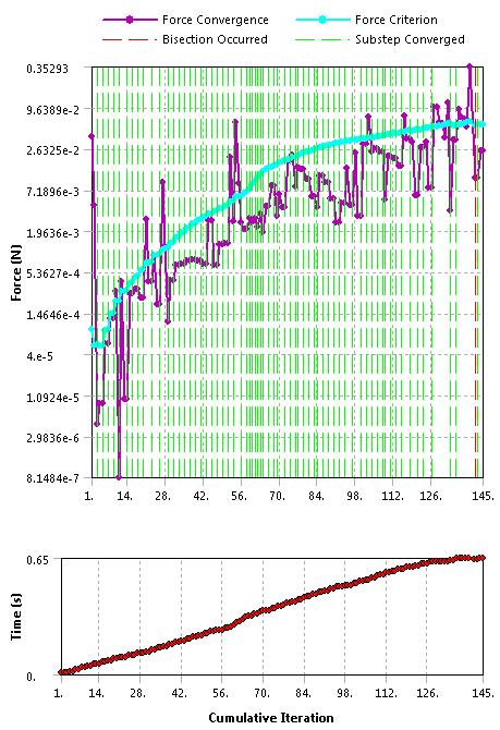

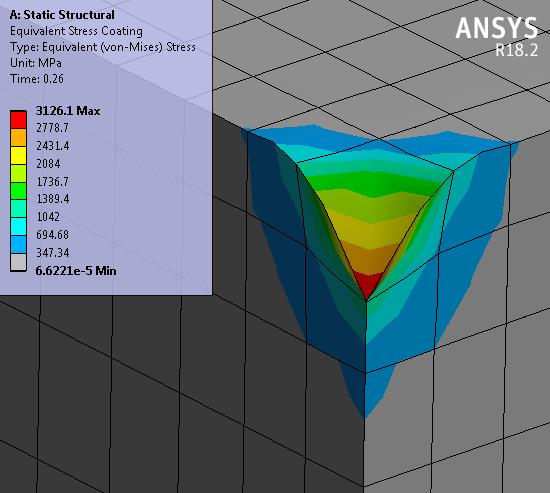

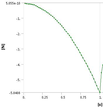

      Here is the convergence plot for the attached model.
      It gets nearly 10% of the way to the displacement of 0.8 mm before having problems with element distortion. That is typical of the workflow necessary when including large deformation plasticity.
      Here is the stress in the coating.
      Notice that the maximum stress is about 250 MPa. It's not going to get any higher than that because that is the yield strength for this elastic plastic material.
      I need smaller elements to get the solution to go further, but that will take longer to solve.

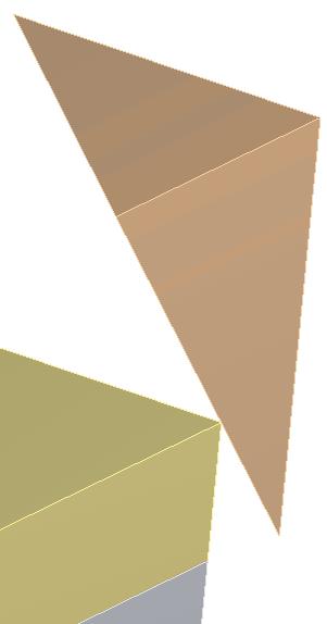

    • libin

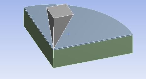

      Unfortunately, the last archive came with the geometry distorted as you can see here.
      The indenter is off set from the coating and substrate. Would it be possible for you to send a new one please?
      Thanks
      If you look at it from a good angle, you can see that the corner is just touching the face of the indenter. You can double click on Geometry to open DesignModeler then File, Export, and select Parasolid as the type. Then you can open the Parasolid file in SolidWorks to check it there.
      I deliberately extended the side faces of the indenter to potentially help the contact algorithm.

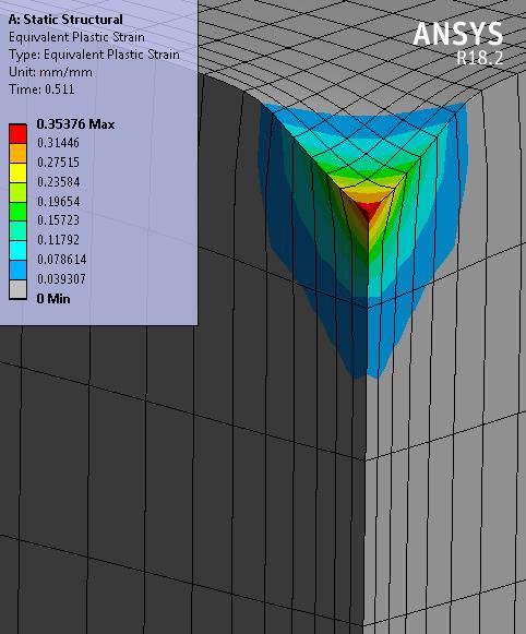

      On the other hand, the element has exceeded 100% plastic strain.
      I could turn off plasticity, but then there would be no indentation when the indenter was raised up.
      Instead, I will increase the Tangent Modulus and rerun the simulation.
      Now the model has made it 65% of the way to 0.07 mm and has shown the first sign of trouble.
      The solver needed 13.5 GB of RAM to run this model and ran for 9.2 hours on 8 cores to get here.
      I set a minimum of 100 substeps but it looks like I could cut that in half and the solver might get to this point in half the time since there are many increments that are below the Force Criterion line and few that are above.
      The plastic strain is at 50% and elements not yet in contact are deforming elastically. These will spring back after the indenter is removed. This model must eventually consist of 2 steps, the first step is to move the indenter down 0.07 mm, the second step is to move it up 0.07 mm so that the indentation can be measured after the elastic strain springs back to a new indented equilibrium.

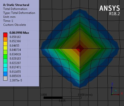

      At last, 100% of the 0.07 mm displacement was applied.
      There was some residual stress when the indenter was retracted, but not much of an indent.

      The indender as pushed down 0.07 mm per your earlier specifications. Using the material with the Tangent Modulus of 5,000 MPa, the deformation of the 1/4 model at the maximum displacement is plotted below.

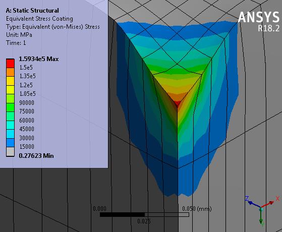

      After the indenter is removed, there is some permanent deformation.

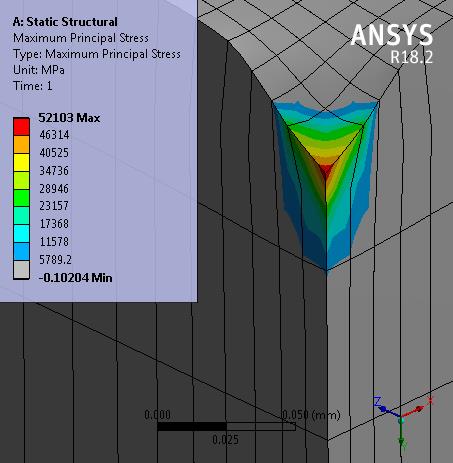

      Below is the Max. Principal Stress of 8.4 GPa at maximum load.
      Note that the stress will be much higher for a linear elastic material with no plasticity.
      I used a Tangent Modulus of 1E5 MPa, which is so high, it's almost linear elastic.
      Below is the Max. Principal Stress of 52.1 GPa from that simulation.
