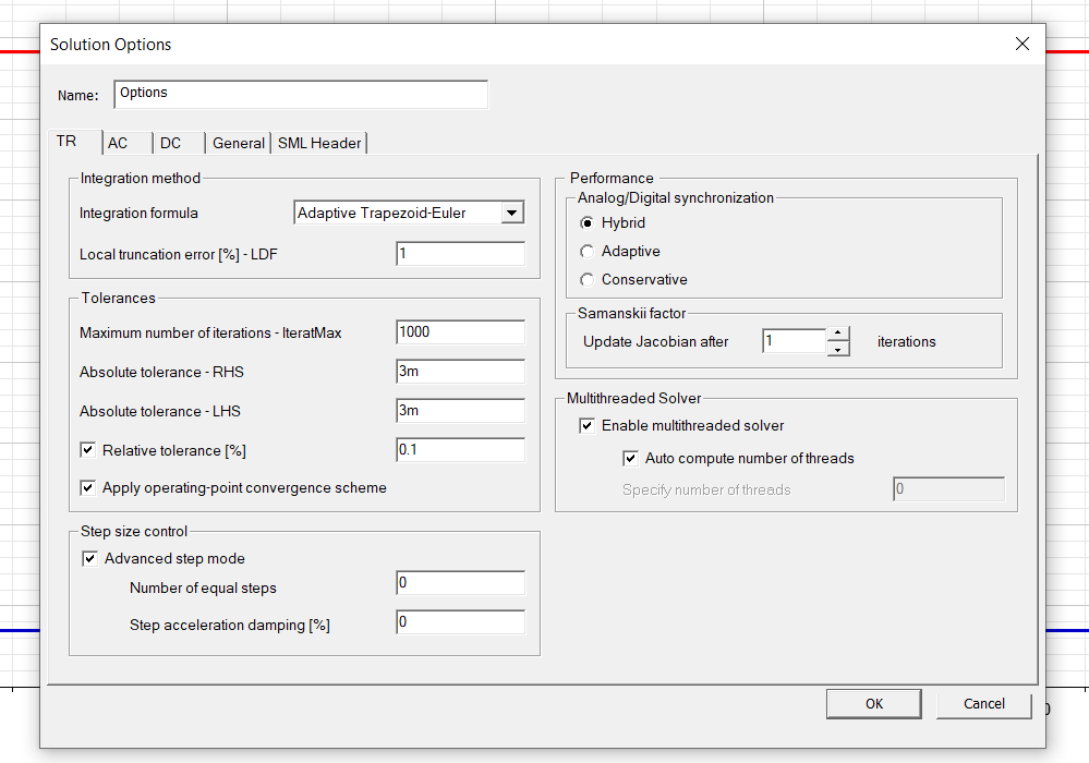

SubscriberI build a 600Hz medium frequency transformer in Ansys Maxwell (transient simumation). I woul like to give input from a PWM inverter. So I interconnect transformer with PWM inverter developed in Ansys simplorer.Â
Since the out put frequency is 600Hz, I have chosen a switching frequency of 24,000Hz (40 times of fundamental frequncy).
I have chosen 2ms as the total stop time and 5micro sec as the step size, when I run the same, I got an errorÂ
"Warning 10907 - A complete convergence within the maximum number of iterations allowed of <40> could not be achieved for all time steps. Convergence failed on conserved terminal
. Â Node: net_2<%> Â >> Calculate at t=3e-05 s " What is the correct stop time and step size for my simulation for overcoming this warning and for getting correct switching.

Ansys EmployeeThis is a warning about convergence, please refer Simplorer manual for help. Keywords are "TR(Transient) Options", there are serval methods to resolve convergence issue.

Ansys EmployeeFor this warning message about convergence, please refer Simplorer manual for help. Keywords are "TR(Transient) Options", there are serval methods to resolve convergence issue.
