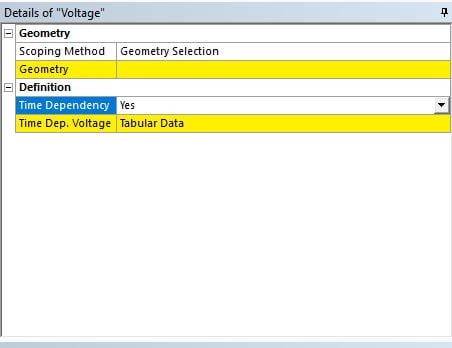

           I am using ansys workbench software for electrostatic MEMS simulation, I want to give step voltage or change voltage as of function of time depending on situation how to do that in Ansys 18.2 workbench. Also how to do harmonic analysis. what is the use of voltage coupling.

      It would be easier to provide advice if you post a complete description of the geometry by inserting some images into the post, show the boundary conditions, the faces that will have voltage applied, whether the analysis is Static Structural or Transient Structural.

      The voltage is applied on hidden face of the beam, The analysis is Static Structural
      Do you have a body to represent the air around the beam?  You have to mesh the air as well as the conductive body. You might want to have a body that surrounds the air in order to mesh a layer of infinite boundary elements.
    • manoj531564
      Yes, there is body representing the air below the beam,(face underneath the air is consider as ground plane by assigning voltage 0). This body is assigned as electrostatic body while meshing. now i want to vary voltage as function of time.
      for example : i want a step voltage signal to see the dynamic response of the system), also want to do harmonic analysis.
