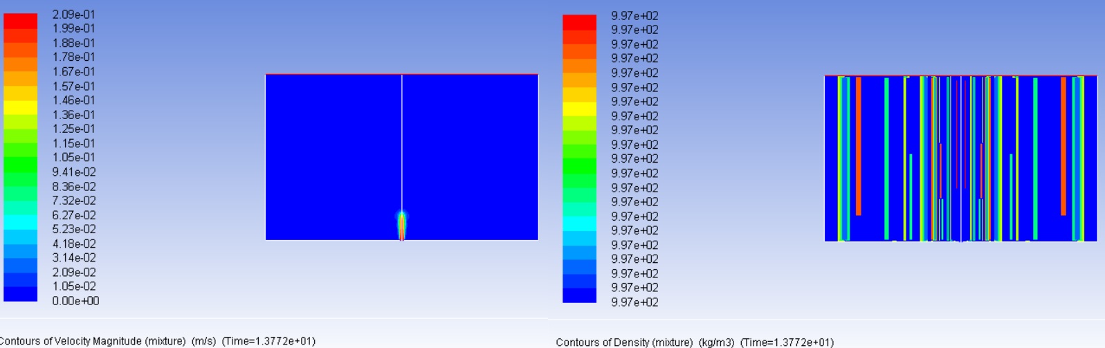

      I wish to simulate development of buoyant jet in a density stratified medium.
      In my system, background density varies linearly from bottom (high) to top (low). Thereafter a jet of medium density is opened from bottom. So it should move up and at a neutral layer, the jet fluid should spread horizontally. Background fluid is water with varying density. At bottom density is 1016 kg/mt3 and at top density is 1001 kg/mt3 . Water of density 998 .3 kg/mt3 is impinged from bottom as round jet.
       I am adding two images to clarify my system.

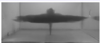

      1st image shows a tank full of water (density stratified as shown by different colours). Then a constant density water jet is impinged from bottom (shown by arrow). 2nd image shows experimental image that should be found in simulation.

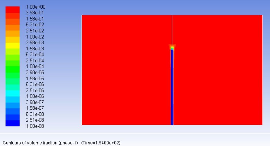

      Can you show contours of Volume fraction of the impinged water n
    • akban
      Please find contours of Volume fraction:nnThe jet fluid does not mix with background fluid.n
    • YasserSelima
      It does mix. Keep the simulation running for some more time.nBTW, 202 seconds in two phase flow is a very large time. What is your time step?n
    • akban
      My time step is 0.002.nnIn experiment, it creates a horizontal layer of fluid at neutrally buoyant height within 120 sec.n
    • YasserSelima
      Plot void fraction of the dense water. (Not impinged) nIn the void fraction contours panel, uncheck the box auto range. Make the minimum 1e-06 and keep the maximum at 1. Then Select color map options and check the box log scale.nThis should give you a clearer view of how much the jet spread is.n

      n
    • YasserSelima
      Make this contour phase with the same setting for phase 2. n

      It should be like:nnn

      Moreover, density contour looks total junk.n
    • YasserSelima

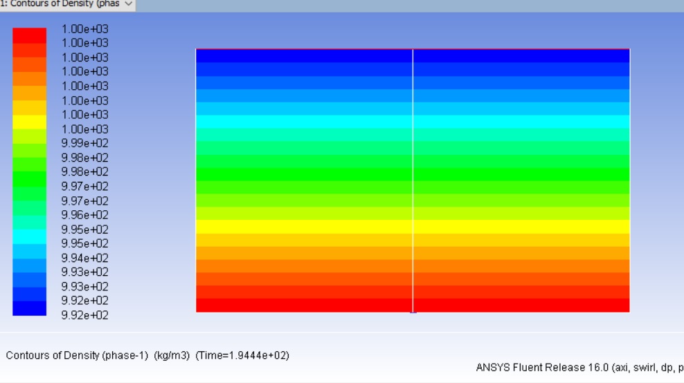

      Why is density contours changing? How did you setup the density at the beginning?.You created UDF, this is what I see at the top. Where did you hookup the UDF?n
    • akban
      n
    • YasserSelima
      yes, that is right. nAnd the density you showed at the top of this post was showing linear distribution. nCan you show contours of density of phase 1 at the current time. Phase 1, not mixturenn
    • akban
      No change. Very strangennn

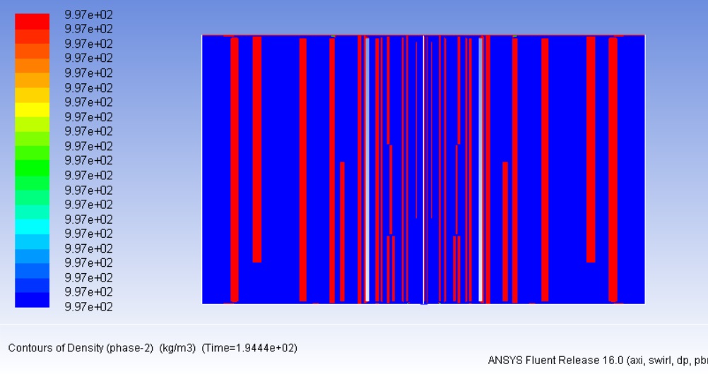

      It should not change ... the mixture density is different. Now before explaining what is in my mind, I need to see phase-2 contours, log scale .. minimum 1e-12 and ...nLast thing, Regarding the experiment ... how did you get the linear density? How did you capture this image? PIV? or what?.
    • akban
      In experiment, linear density was created by using salt. The image is captured by a simple DSLR camera.n
    • akban
      Phase 2 density looks junk.nBTW, what is in your mind?n
    • YasserSelima
      The 2D simulation has an effect in obtaining this difference. Fluent recognises the jet depth is 1 m, which is not true ... To solve this issue, you need to have few cells in the z direction, , then apply symmetry plane. You can actually simulate 1 quarter of the room, and apply symmetry ... nMore smart solution ... make axisymmetry ... having rectangular or cylindrical room will not make a difference if it is large enough.nThe captured photo, the impinged fresh water particles, started to diffuse horizontally when the jet velocity became very small ... may be the salinity played a role.nFinally, I believe, if you left your simulation to continue, you might get something close to the photo .. nThe last density shows that the mixture density is similar to the impinged water density. I can't explain the physics of this ... it does not make sense . Probably this happened when you were running the simulation with wall at the top. !!nnmy recommendation, repeat the simulation ... asymmetric ... outlet pressure on top. And monitor the density in few points away from the jet.n
