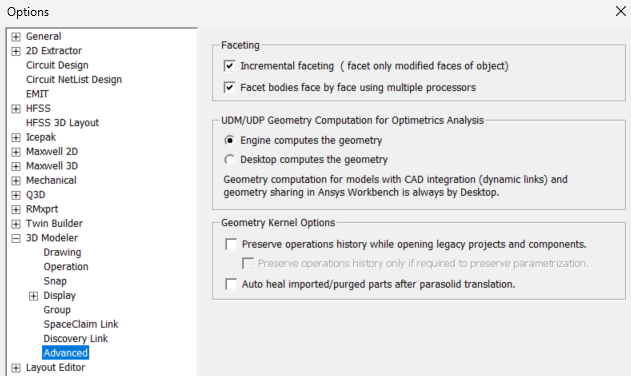

      ALH's 3D Components were created using the 3D Modeler Kernel (ACIS) prior to 2022R2. Until 2024R2, there was a conversion function from ACIS to Parasolid, but this function has been removed starting with 2025R1. Therefore, 3D Components created using the ACIS kernel cannot be imported into 2025R1.
      As a workaround, you can import them directly by using 2022R2.
      Additionally, while it is possible to import using 2024R2, which has the conversion feature, conversion may not be possible in some cases. In such cases, select Tools > Options > General Options from the menu, then uncheck the Geometry Kernel Options checkbox under 3D Modeler > Advanced. Note that unchecking this option will erase all creation history of the 3D Component, including variable settings.
