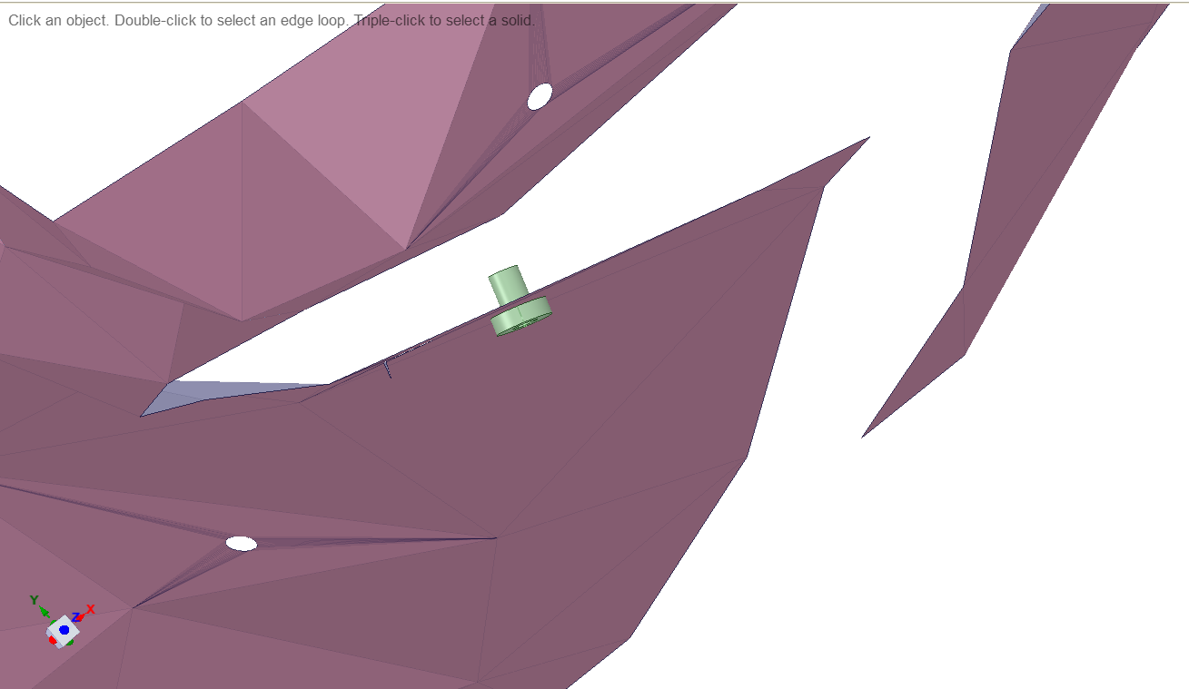

SubscriberHello Array,nThis is a body brace and unfortunately we do not have the patient's body model to attach as the constraint.nThe cylinders are just to mimic the screws. We would like to analyze if the forces acting on the straps (and therefore the screws) would cause any failure on the brace when used in the long run. Is it still realistic to just apply a force on the 'Hole' edges?nIn addition, I CADed out an M4 by 5 screw on the brace last night to replace the cylinders. However, i cant seem to create a hole on the surface of the brace. I couldn't use the hole option in spaceclaim for whatever reason??nThus, I drew out a screw and duplicated it. n

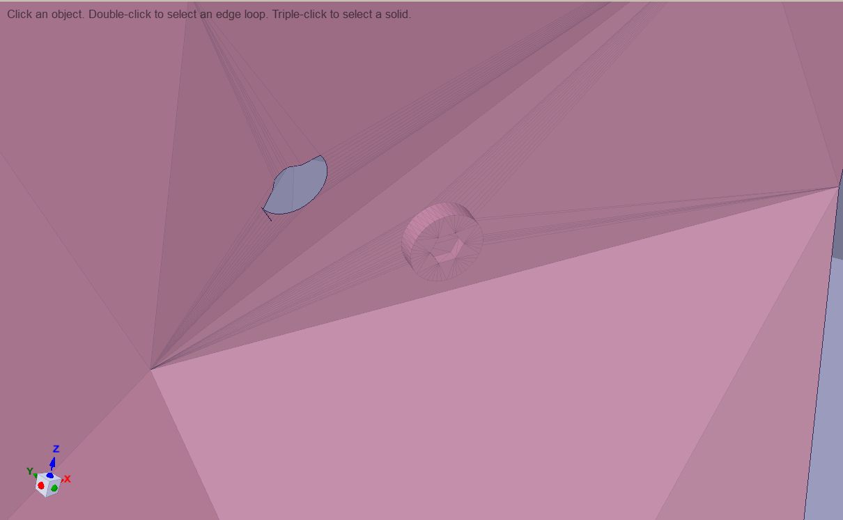

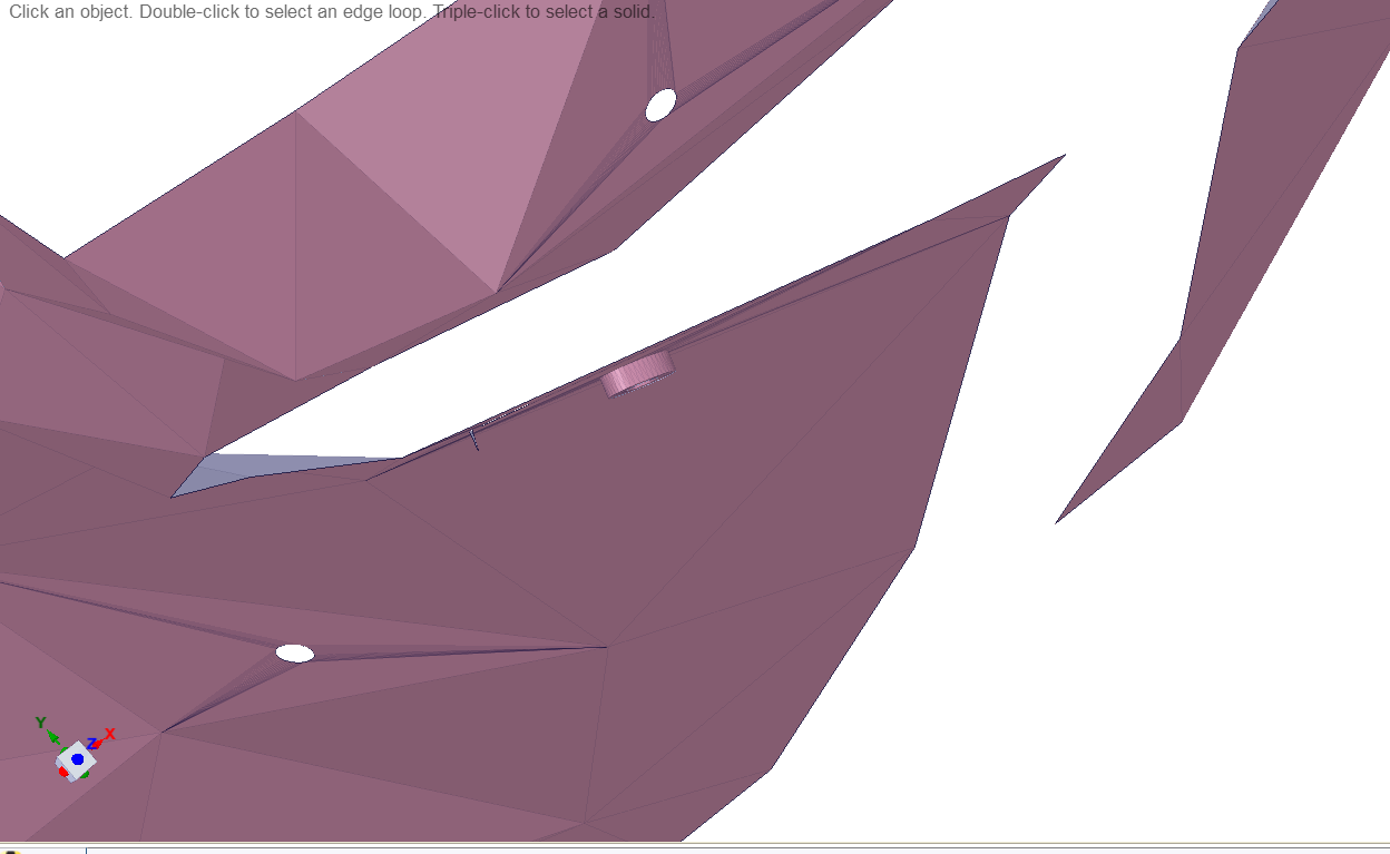

I used 1 of it to subtract from the brace, expecting to get a hole out of it. However, since it was a surface brace with triangulations, I had to delete some triangles that appear after the subtraction. I do not know why it only appears on one side of the brace and not the other.n
But even after deleting, the existing triangles merged with the circle to produce something like this:n

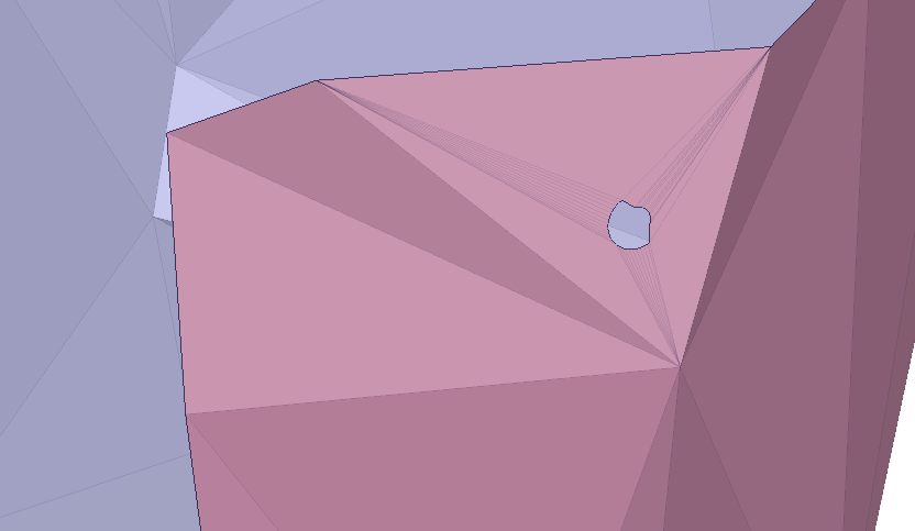

However, some other circles look perfectly shaped like this:n
nnHow can i fix this?.Thank you.n

Ansys Employee,nYou could add a plane in space claim (normal to axis of the screw), draw a circle on it and use the pull option to remove material and create a hole in the brace. To constrain the brace what you could do is add a cylindrical support at 3 holes (edges) and apply forces to the remaining holes. If the solver still gives you a rigid body motion error add cylindrical joint to one more hole (4 in total). Let me know if this works.nRegards,nIshan.nMarch 11, 2021 at 3:15 pmyappyap

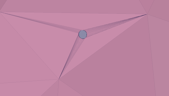

Subscribershould i be using fixed supports on the holes? i tried to use remote displacements on the left holes to have more control of the DOFs, then applied a remote force on the right side to hopefully get an action-reaction force. It didnt work. I then used Fixed Supports on the left holes and applied force on one side. It didnt work too.nShould my remote points be Deformable or Rigid? I am using rigid now.nI have reduced the size of my mesh around the holes using body and edge sizing:n
n
n
March 12, 2021 at 4:34 pm1shan
Ansys EmployeeHelloArray,nThe distorted elements near the holes might be creating the problem (the mesh is bad around the hole). Use shared topology to get rid of the small thin surface edges near the holes. Also use fixed support at first, and when the error is resolved use remote displacement. You could check this for using shared topologyhttps://www.youtube.com/watch?v=4JhDn0V26l0.nRegards,IshannViewing 8 reply threads- The topic ‘Simulation Error with Insufficient supports’ is closed to new replies.
