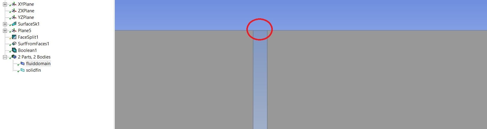

I am going to model a moving rigid vortex generator that moves adjacent to the top wall of a backward-facing step.
Starting with a simple simulation, I want to model a rectangular fin.
I am using ANSYS Fluent to solve the fluid domain. When I draw the geometry, I make two parts, one solid and a fluid.
August 19, 2021 at 10:28 amRob
Forum ModeratorIs it moving along the wall (eg a scraper) or vibrating (ie bending in the flow)?
August 19, 2021 at 5:45 pmSamina
It is moving along the wall with a given sinusoidal velocity.
August 20, 2021 at 1:09 pmRob
Forum ModeratorOK, so a scraper. I'd use layering and non-conformal interface zones. You may need to model the wall as a solid if it need a thickness.
August 23, 2021 at 1:54 amSamina
SubscriberThanks for your answer.
I have surfed the net to understand how to define non-conformal interface zones, but it seems to be practical for two or more adjacent zones that are meshed separately, so we should define their interface boundaries as non-conformal. However, In my case, the solid part is a rigid body and does not require to have any mesh. What should I do in this case?
August 23, 2021 at 11:25 amRob
Forum ModeratorYou may need to rethink the meshing approach to define the shape and then allow it to move. Most modelling needs some planning to set up the geometry & mesh to then use the solver tools.
August 24, 2021 at 12:19 pmSamina
SubscriberThanks for your guidance. I will reconsider the whole approach.
