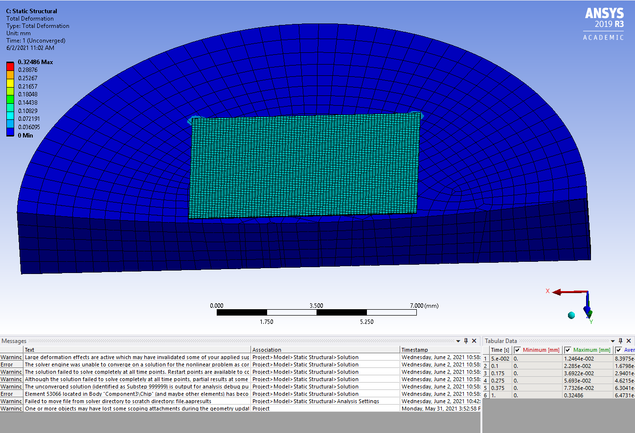

      All my contacts are closed. I am using frictioneless contacts between the components.
      However, I still believe that the corners of the silicon chip in contact to the bottom substrate will try to move up when the tool presses against it. So, I guess bonded/no separation might generate additional stress.
      Also, all the bodies in my CAD are solid bodies, I am not sure if that will make a difference in the end but I am not able to converge on a solution.

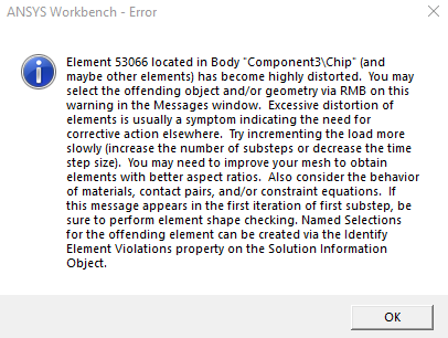

      i see some penetration between the substrate and the silicon which I tried to rectify by using Normal Lagrange formulation but then the solution does not converge because some element become highly distorted.
    • 1shan
      Have you turned large deflection under Analysis settings as 'ON' ? Also, if its a thin sheet a better option would be to use a 2D mesh (or you will need more than one element across the thickness). Also, If you are not interested in the deformations of the lower glass substrate define its stiffness behavior(under geometry) as rigid. The solver will not mesh the rigid body saving unnecessary expense. Have you used a bonded contact at the 4 corners? Looks like the geometry is symmetric. If so just model 1/4th of the geometry and use the symmetry object - https://www.youtube.com/watch?v=RETzoXbbwBA. You could see which elements are distorted by setting a number to 'element violations' under solution information.

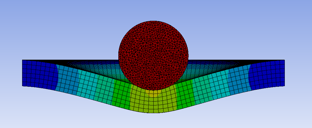

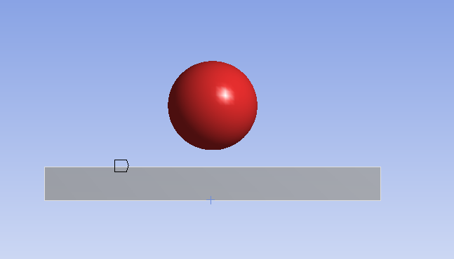

      I have now simplified my model to a base block and sphere that you can see here in the image below:
      I set the contact condition as frictionless.
      The block is fixed supported on the 5 outer faces (expect the one in contact with the sphere).
      The sphere has a displacement boundary condition of 5mm in the Y direction.
      With these settings I see the sphere deforms the block:
      my aim is to deform the sphere (or whatever component is on top of the block, maybe a silicon chip later). Then, I tried to increase the Young's modulus of the block material to be greater than that of the sphere. And I also tried to change the block to be a rigid body and apply Joint in the "connections" settings.
      With the joints settings and the rigid behavior of the block I see that the sphere just moves though the block for 5mm and does not deform. I also change the "advanced: formulation" setting in the contacts to pure penalty and augmented lagrange but there is no deformation, only the sphere passes through the block.
      my ultimate goal is to make the sphere deformed when it comes into contact with the block but what happens is the block deforms.

      Attached is the new archive file. I have archived everything including the results to make sure it work, however it was not solved.
      In the geometry, there are three components. Concave glass dish at the bottom (serves as mould for the chip curving process), a thin silicon chip and a tool on top to press the chip into the mould.
      I am not too concerned about the pressing tool so it can be suppressed. I am more concerned about the stress in the silicon after it has been deformed. There is an intermediary process in the bonding of the chip to the mold by adhesive and heating it which will produce additional stress as it cools down but I think I am getting ahead of myself.
