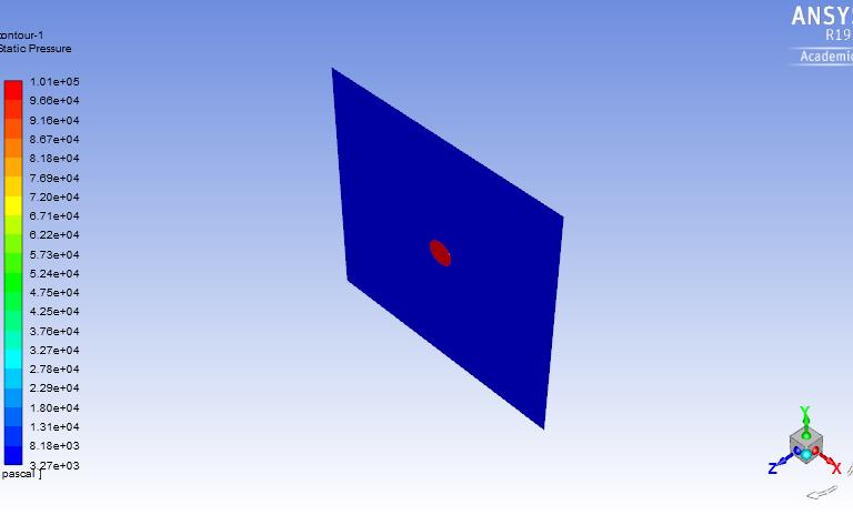

      Currently I'm developing the simulation of the ascension of a high altitude ballon. It basically involves 2 different fuild volumes, one for the air and one for the helium.
      You can see more details of the geometry model here: /forum/forums/topic/meshing-low-thickness-region/
      Or just check this images:
      In my simulation the top cube face is considered as the inlet and the bottom face is considered as an outlet. So the air moves with a velocity of -4 m/s in the Y direction(see precious photos). Also inlet and outlet condictions changes with the time(as it get higher in the atmosphere) so a transient simulation is conducted(those conditions are set with UDFs) . When I implement the model in Fluent, I set ideal-gas model for both helium and air. You see, as the balloon gets higher so does its diameter (untill it finally burst) however, I don´t really know hot to set up that mesh with FLUENT.
      I think it is dynamic mesh related but I'm not quite sure. Here´s some evidence of the Helium mantaining the exact same pressure during the whole ascendent move:
       You can see in both pictures that the helium inside the ballon:
      - Mantains the exact same size
      - Maintain the same initial pressure
      That results in a change in the thermal study which is my main purpouse of the simulation, so help its pretty much apreciated.

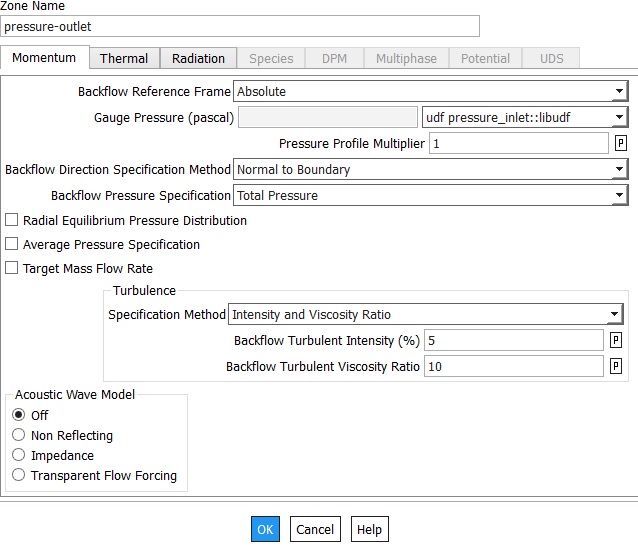

      In the pressure outlet here's what I have (the name of the udf doesn't matter overall it's just atmospheric pressure vs altitude made time dependant knowing the flight velocity):

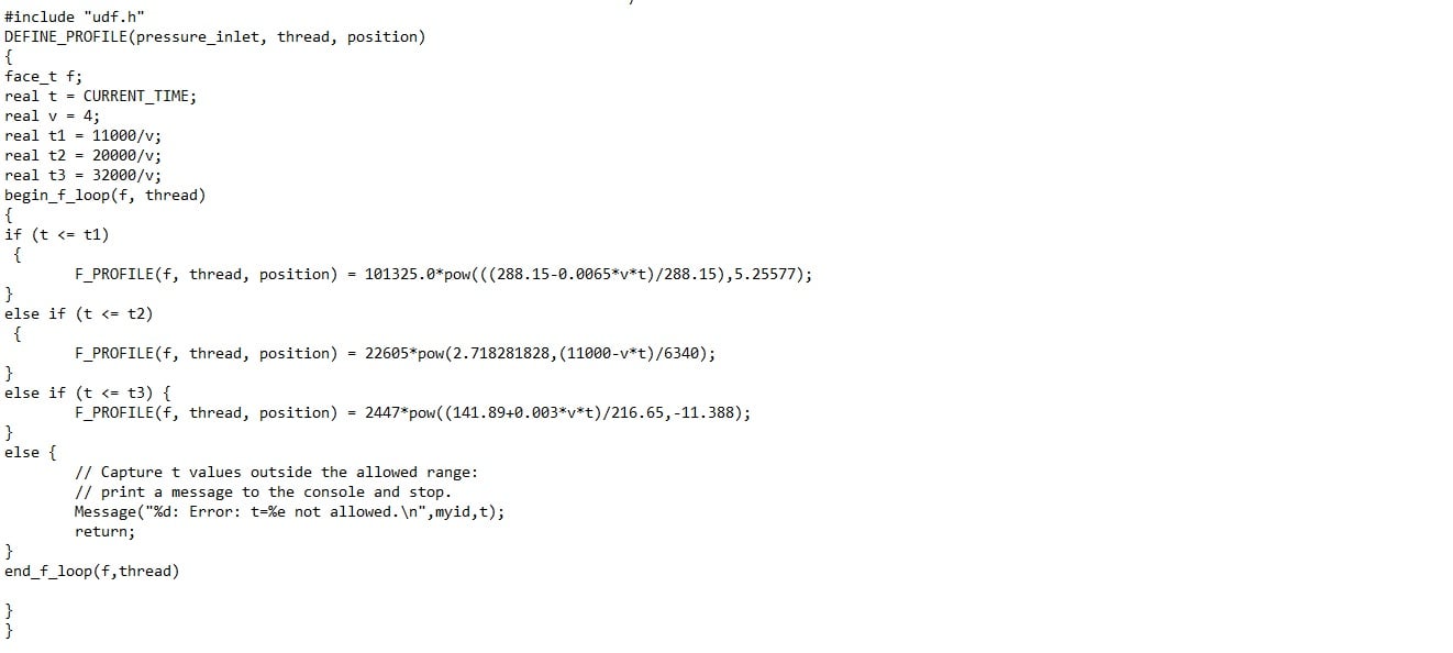

      The UDF is coded as follows having the U.S Standard Model (close to your refference):

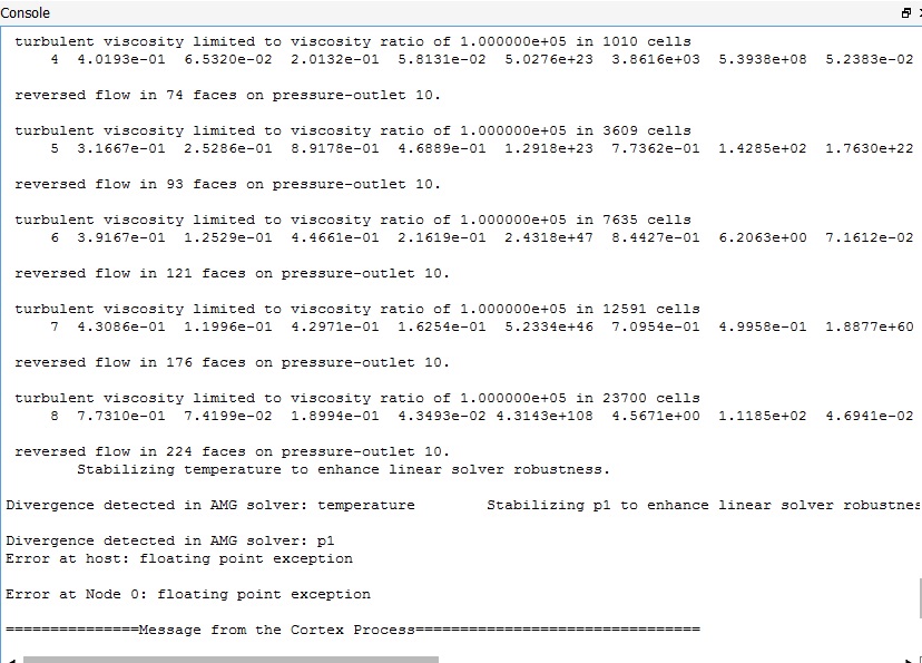

      The problem is that i can't seem to be able to solve the problem, here's what the console log looks like:

      I won't be able to check your case files as ANSYS Stuff.  Just a question: do you need a radiation model in your case? Why are you using explicitely P1 model (generally used for thick media).
      Just help your self by debugging the case by switching off radiation, just applying the heat from solar radiation and paying more attention to the flow dynamic settings. Check the pressure resulting from your UDF. The pressure returned will be the static gauge pressure at your outlet (pressure-outlet).  Reversal flow means that either it recirculate due to non-proper pressure field or it's physical. Turbulence is quite high at your outlet where I assume free-stream (stagnant flow) if the boundary is well far away..
      Be aware this is an open community so everyone would might access your case. I will remove the link in your posting. You will then just share with the community members who wants to help you directly.
      I hope the community will chime in here.

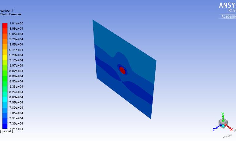

      It doesn't seem to work out, here's what every face (of the cube) looks like now:
      I think the set up should be ok but then again not a result for the first time-step was possible.
    • Amine Ben Hadj Ali
      It would require further investigation and baby sitting of the all numerical methods and solution control. As ANSYS Stuff I cannot do more that I have already done here. I have highlighted some ways how to deal with that.  Last comment:
      1/You said without the balloon inside everything is working fine perhaps you need to investigate in that direction too. Try to setup a moving wall (the hull of balloon) without the helium being inside and check if it is working.
      2/If using pressure-farfield the input for pressure and temperature has to be driven from the isentropic relationships. Your pressure profile and temperature profiles are the stagnation values.
      I hope other community members may chime in here.
