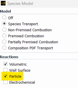

1.Activate the particle reaction option in the "Species Model" dialog box.

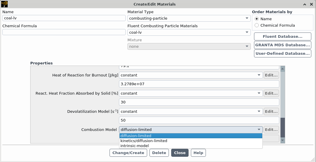

2. Select "multiple-surface-reactions" combustion model for the combusting particle:

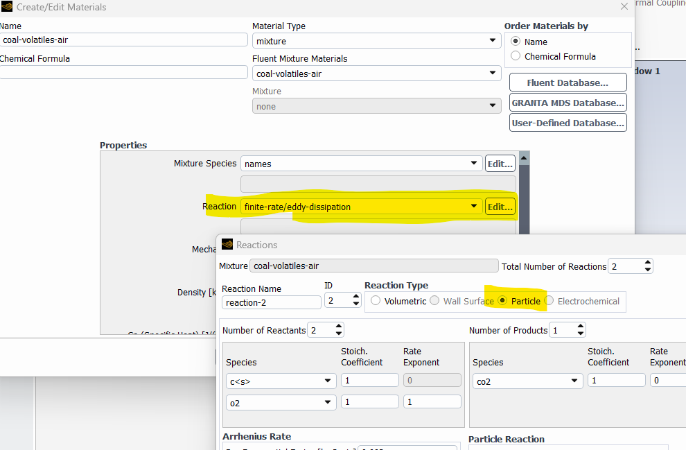

3. Define the particle reaction in the mixture material, e.g.,
