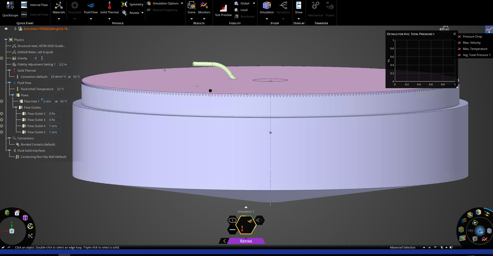

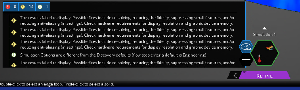

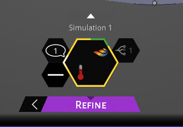

Good afternoon,
I'm not able to simulate in refine mode. The simulation does not advance further than the progress visible in the attached figure. Could you help me please?

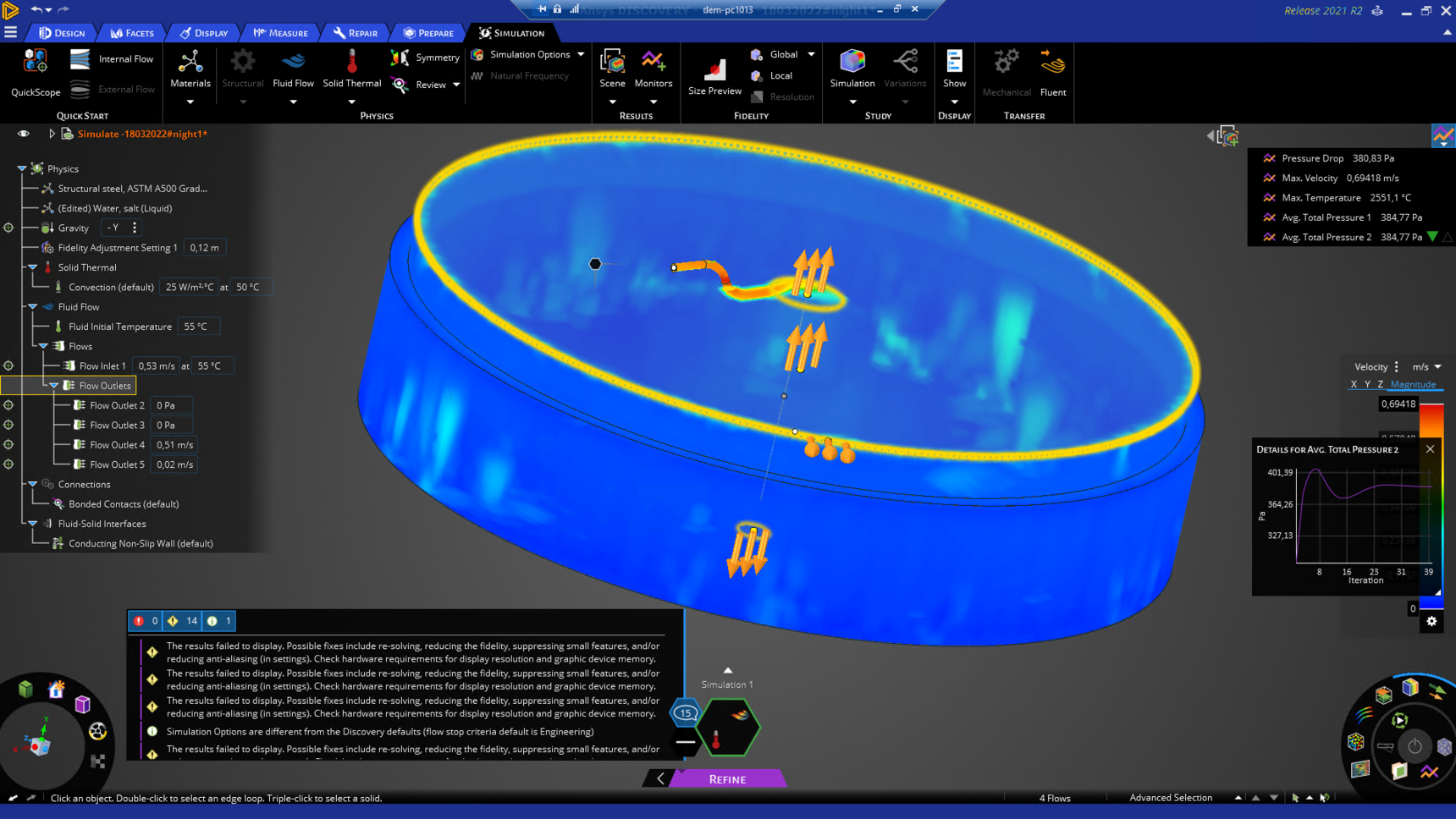

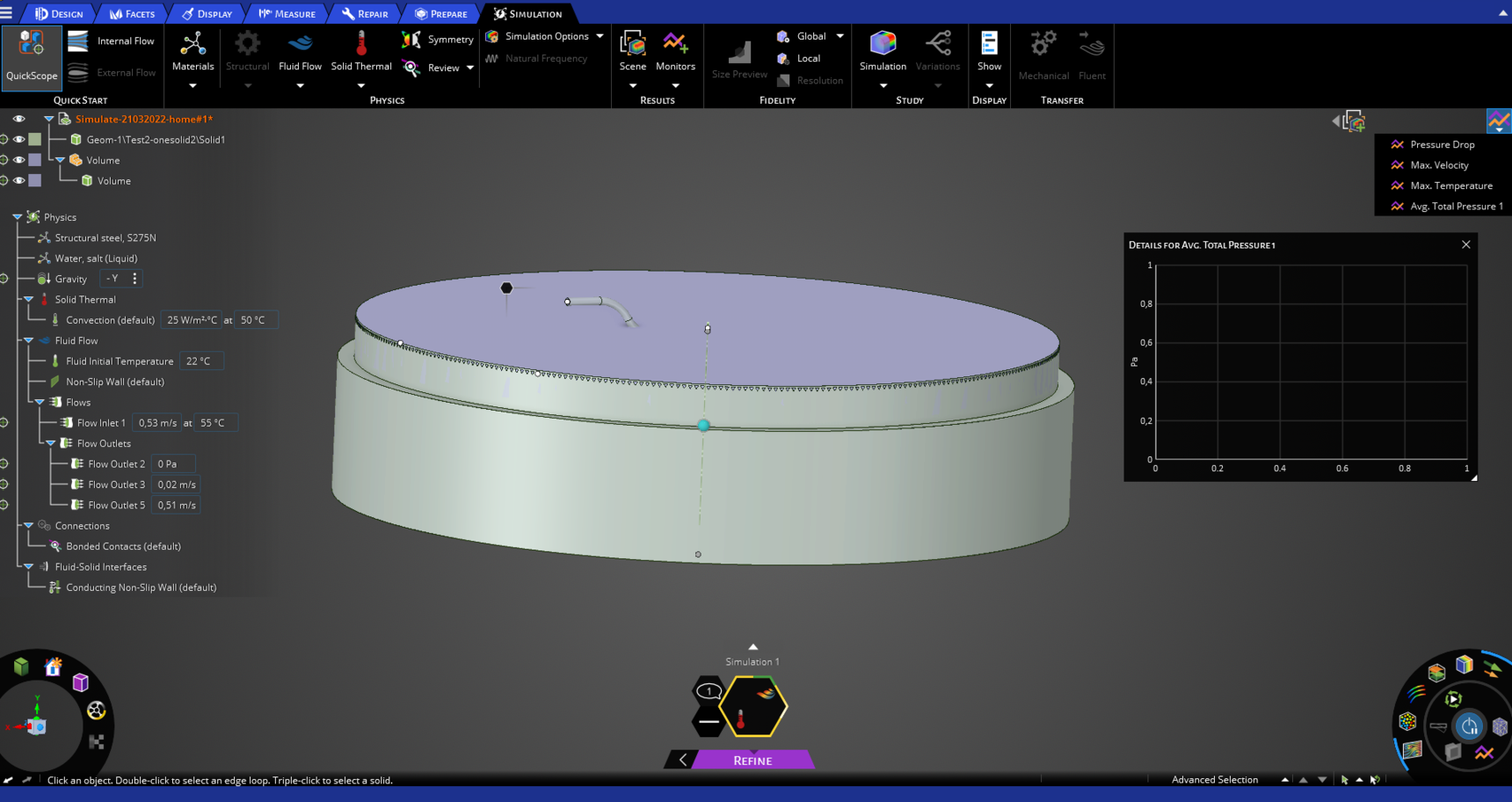

Subscriber🛈 This post originally contained file attachments which have been removed in compliance with the updated Ansys Learning Forum Terms & Conditions
Hi Devendra ,

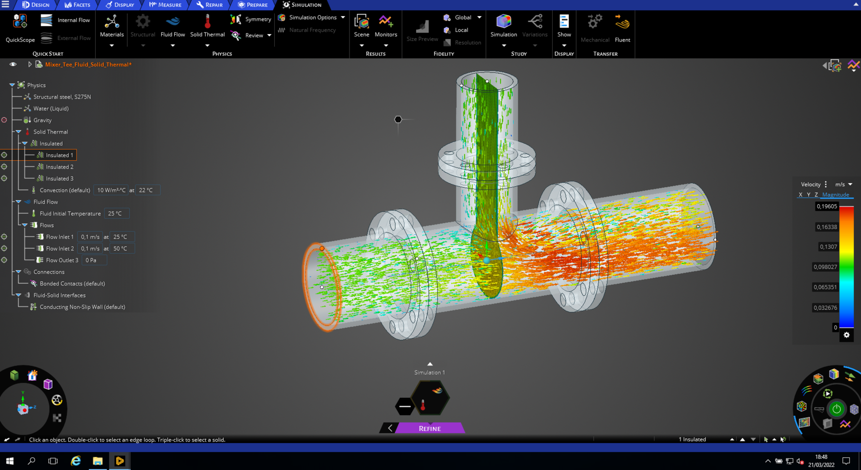

I successfully simulate the "mixer tee fluid solid thermal" example in Refine mode.
For my case study, I replicated all the steps from this tutorial - https://discoveryforum.ansys.com/t/p8hx1nb (including part 2), and the problem persists. The simulation does not progress.
Have you had the opportunity to check out my case study? I re-attach the dsco file.

It seems you are using 2021 R2 version. You can try this in the latest version of Discovery 2022 R1 and check. I am also running this case in the latest version, but was getting the mesh error as it seems that the small features were not getting captured due to current fidelity settings. I will try changing the fidelity settings to capture the small features and will get back to you once it solves.

You will have to use local mesh controls only where you need to like here in the regions having small features. You must have at least 2-3 cells per small gap to capture those regions. Ideally you'd want more but will take more time to solve.
Please try doing this and let me know if this helps.
