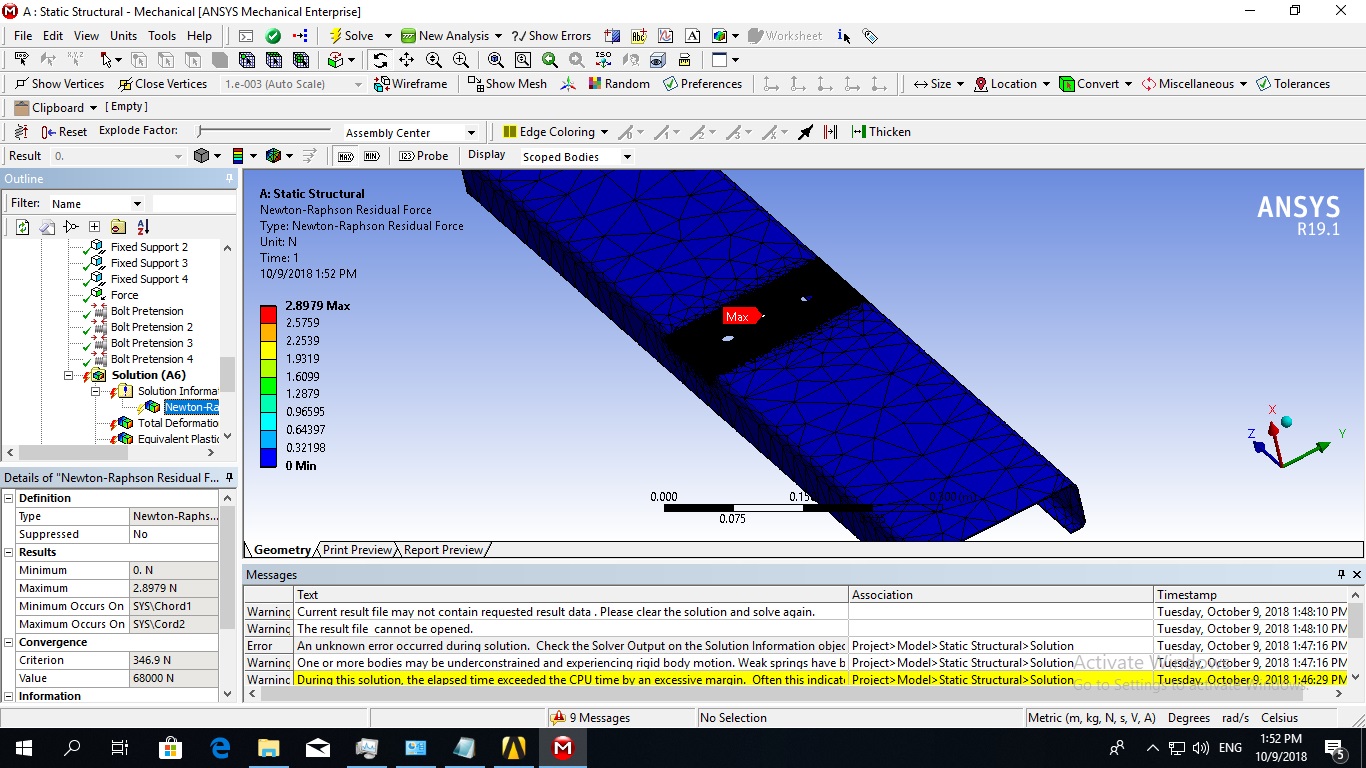

      plz help me to solve this problem. always the solve have errors for convergence
      i want any tutorial for it
    • submero
    • Ashish Khemka
      Looking at the image above - I am not able to see bisections before non-convergence. Can you please check what exactly the error is in Solver Output file. There is rigid body motion indication in the warning. Please see if the model is properly constrained. Also please turn on the Newton Raphson residuals to see the region of force imbalance.
    • submero
      it is the same error
      but when i use smaller force like 10 N instead of 100000 N the error not occurred
      " USE SPARSE MATRIX DIRECT SOLVER "

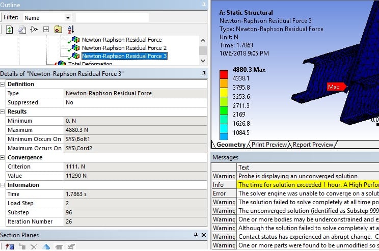

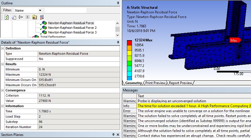

       You added the Newton-Raphson Residual Force plots to the Solution Information details.
      Now there are 3 plots under that folder. Please expand that folder and show us an image of those three plots (or just one if they all look the same).
      Peter
    • submero
      Peter thank you
      The location of the Max NR Residual Force is where you have to add Mesh controls to create smaller elements.
      • Put a Coordinate System near the location of Max NR Residual Force.
      • Add a Sizing Mesh control, and select the solid body as the Scope for the control.
      • For Type, select Sphere or Influence, then select the Coordinate system created in first bullet.
      • Enter a Radius that captures all the locations shown in the three plots.
      • Enter an Element Size that is at least half the current size or smaller.
      • Solve and repeat the process if it still does not converge, but also double the Minimum number of Substeps.

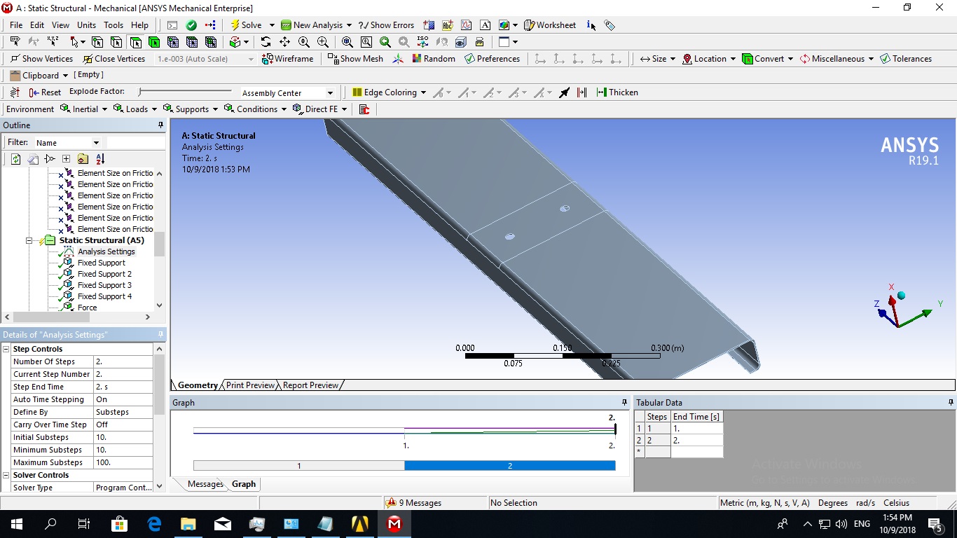

      i make face sizing by t/4 = 0.5mm
      step
      10
      10
      100

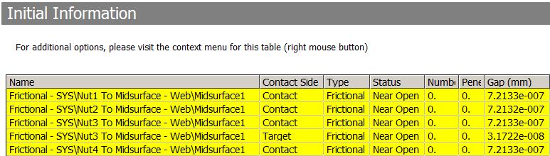

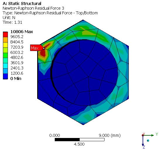

      You were correct to put in the Contact Tool to find out the Initial Contact Status.
      Unfortunately, some of the contacts are Near Open.
      These contacts are only open by a tiny amount, but that is enough to prevent the solver from converging.

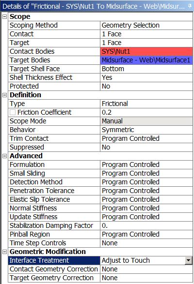

      The corrective action is to select these four contacts and set them to "Adjust to Touch" to close them.  Here is Nut1.
      Change the Interface Treatment to Adjust to Touch. Do that for all four Nuts. You can do four at once if you pick all four.
      After you do that, the solver will fail to converge due to elements that are too large on Bolt 2.
      The corrective action is to use smaller elements on the bolt head.
      There is also a high N-R Residual Force on the beam end where the force is applied.
      You could use a few more elements around the corner, but why is the force only applied to one edge?

      1- I changed four contacts and set them to "Adjust to Touch" to close them but still near open.

      Hello submero,
      I haven't looked at your model, but you didn't fix the problem that causes the model to fail at 1.35.  The elements in the bolt head are too large. You need to add a mesh control to create smaller elements on the contact face of the bolt head. Currently there are 2 elements across the contact face. Make sure there are at least 4 elements across the width of that face. Same on the Nut face.
      After you make that change, if the solver fails to converge, please reply with the N-R Force Convergence Plot and the N-R Residual Force Plots and their details window to see where the solver is having difficult converging. Once you know which part and where on that part, the corrective action is to use smaller elements.

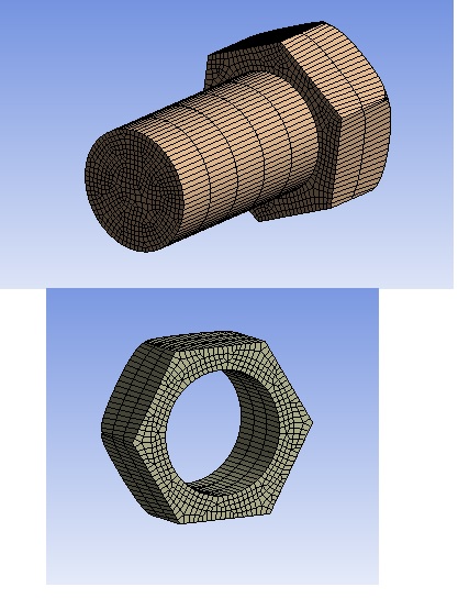

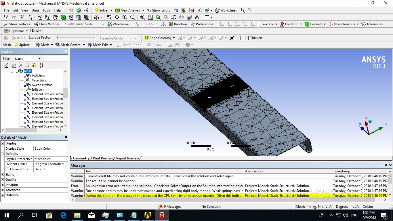

      I meshed all contact parts with 0.5 mm although the model is shell element with thickness 2 mm, resulting in the time of solution reached to 66 hrs.
      1- bolt and nut mesh
       2- I have the same error
      3- I have 6 N. R all the same at this point
