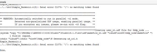

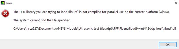

      However, I am extremely new to coding and this code keeps kicking back the following errors in the TUI and GUI when I am trying to hook it to Fluent:
      Can someone help explain what I am doing wrong?
      Best,
    • ALEXANDRE COSTA
      It says is missing  the curly brackets

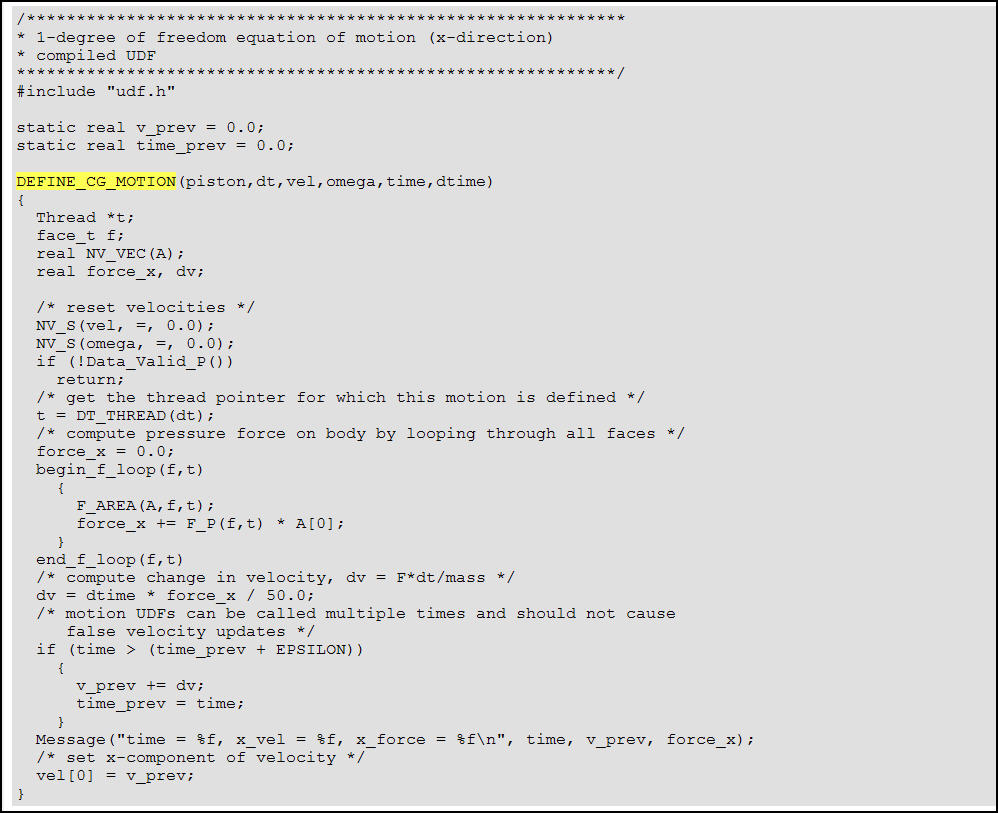

    • Keyur Kanade
      Here is example for this macro.
      Also your error says about parallel. Make sure that you use serial mode for serial udf. If you are using parallel mode then you may need to convert serial udf to parallel.
