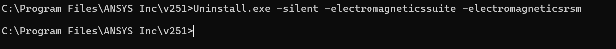

SubscriberI am a sysadmin for a university. We deploy multiple Ansys products across hundreds of machines. I am in the process of upgrading Ansys and Ansys EM to 2025 R1 from 2024 R2. I see that the two are now merged. However, we like to install these separately and be able to remove them separately as well, without removing the entire suite.How can I silently remove just EM without removing other Ansys suites, and vice versa? With 2024 R2, I could go into the AnsysEM folder and run the setup.exe. However, it seems that it is not possible. Also, the product documentation still points back to 2024 R2 as well. I tried running Uninstall.exe -silent -electromagneticssuite but that also doesn't workMaking this silent is imperative as we need to push this to hundreds of machines using MECM and Intune. -

SubscriberHello,
So as I mentioned, I used that, and it did not work. I ran it again with the RSM switch, and it gives an exit code 0 runs for about 2 and a half minutes, but I am still able to access AnsysEM. I’m not sure what changed. In the previous years, I could run the setup.exe in Program Files and pass “/z suppressconfirmation /removeonly”.
To be clear, I install EM by running “setup.exe -silent -licserverinfo 2325:1055:licenserver.domain.com” and it installs just fine.
It also seems to be two Uninstall files "C:\Program Files\ANSYS Inc\v251\Uninstall.exe" and "C:\Program Files\ANSYS Inc\v251\AnsysEM\config\Uninstall.exe". Though the documentation doesn't account for this. Is it possible to escalate this to an engineer who develops this?
