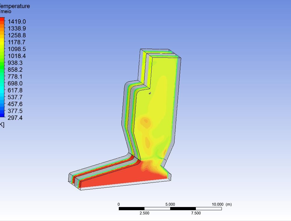

      I have set this Reflection, but at my Results, the "middle part" has a Wall Behavior, like the Figure below:

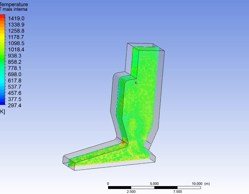

      After that i created a new plane, at the middle point of the half structure:
      Can't i remove this "middle wall interface", to watch interaction between it?
      At NAMED SELECTION: i selected body and consider it all a Fluid
      At SETUP: I set wall thickness for this Fluid
      How to consider this Interface not a wall?
      Thanks
