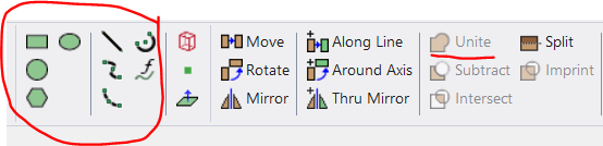

      If the material of both the sensor terminals you want to short is the same. you can use the boolean operations to draw the connection and unite them to implement a short.
