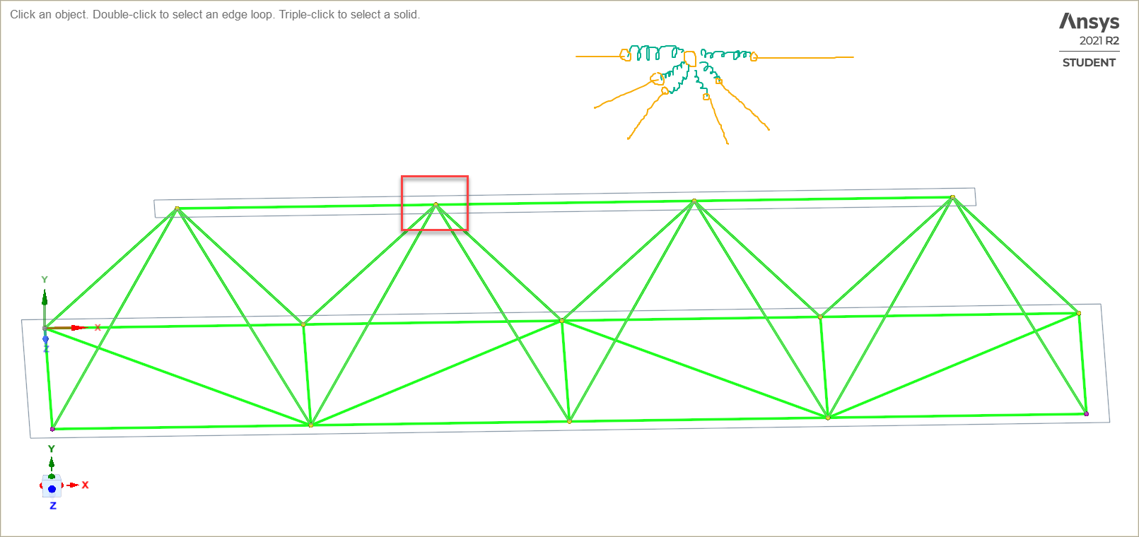

I guess you can create a circular surface (with radius of your choice) at each of the nodes, and then split the line bodies with the edge of this circle, so that the line bodies will be split at the locations where the circular edge cuts them. Then you can delete the small line bodies which you don't want.
