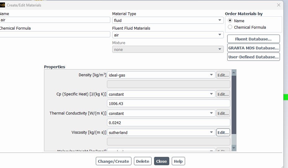

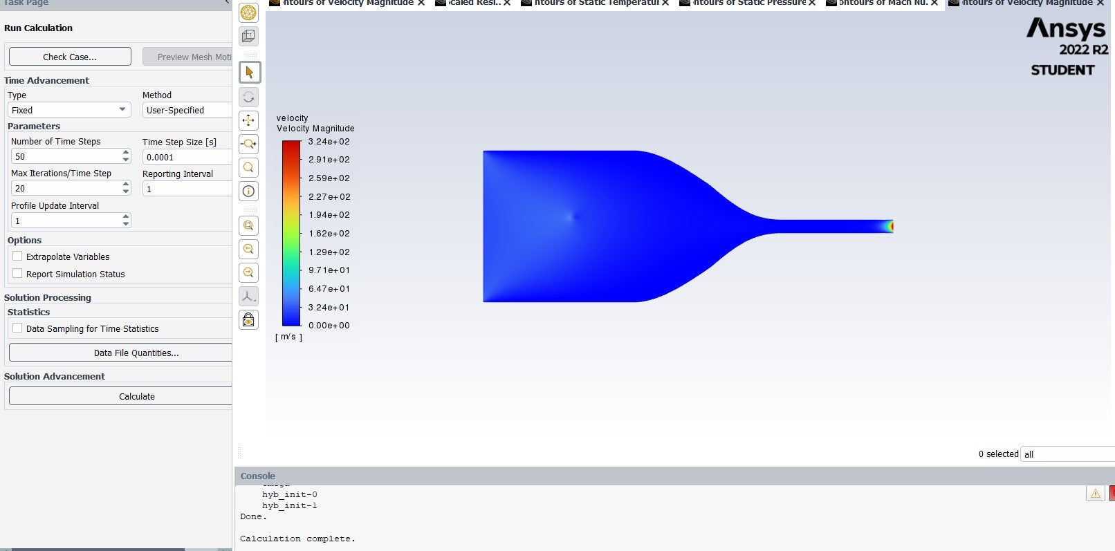

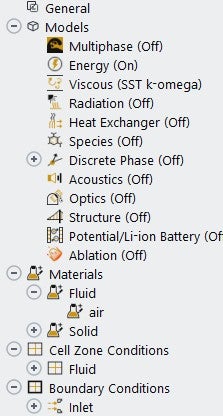

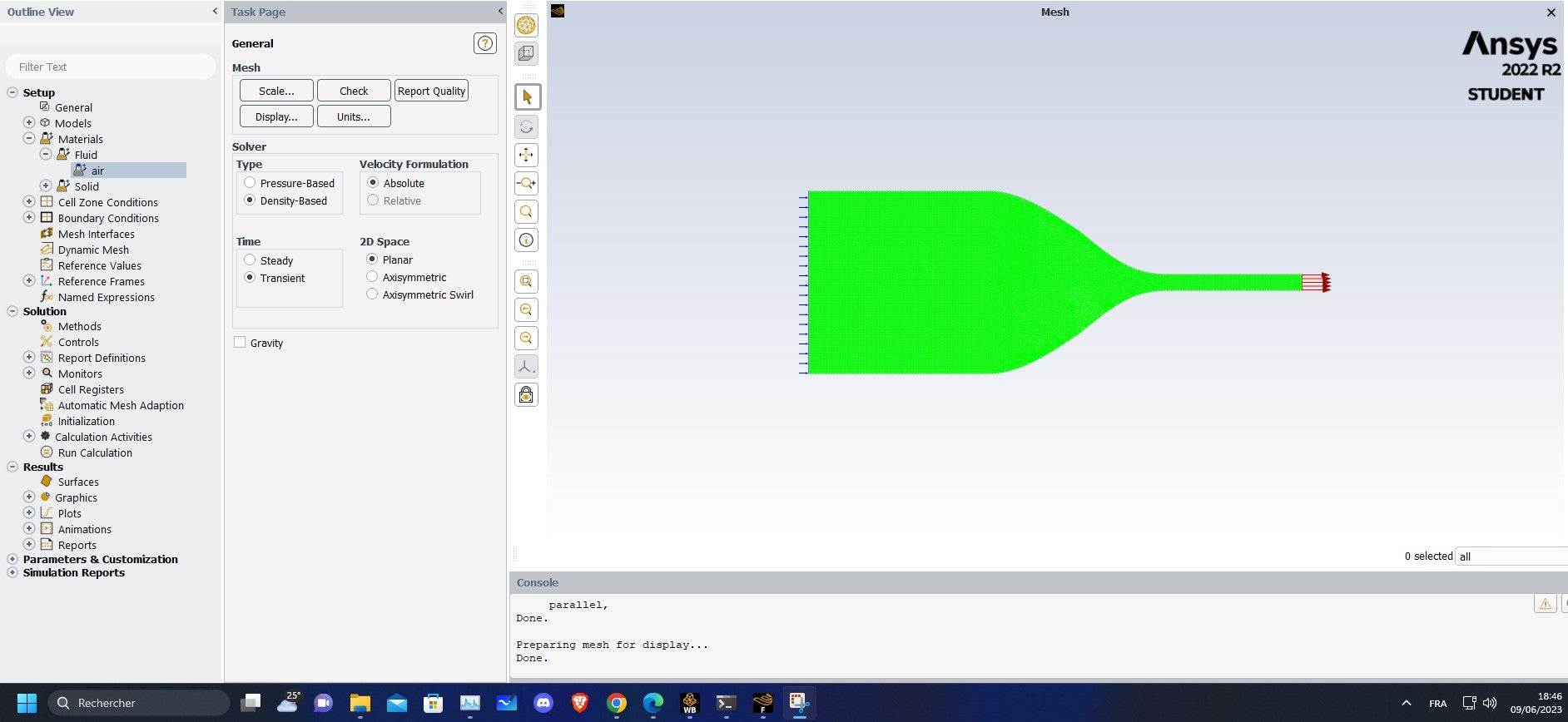

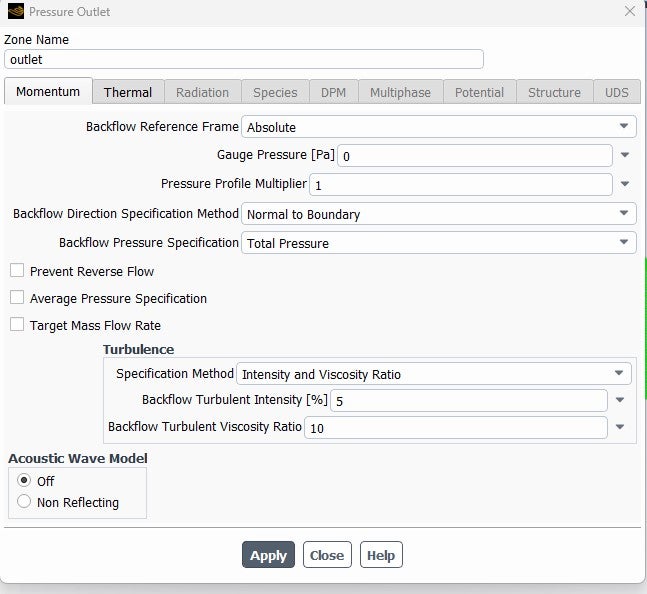

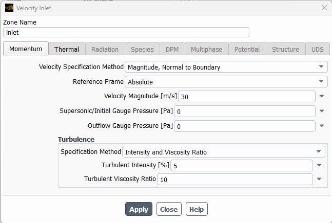

I want to simulate a convergent nozzle with entry diameter of 0.075meter with 30m/s for velocity inlet,and exit diameter of 1millimeter, logically, i have to observe a shock wave on the section of 1 mm, velocity in this section it the sound speed but no shock wave. here some images of my configuration, i begin simulation with hybrid initialisation, i use the SST k-omega model
