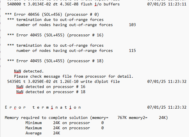

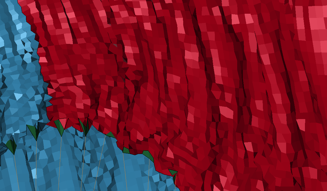

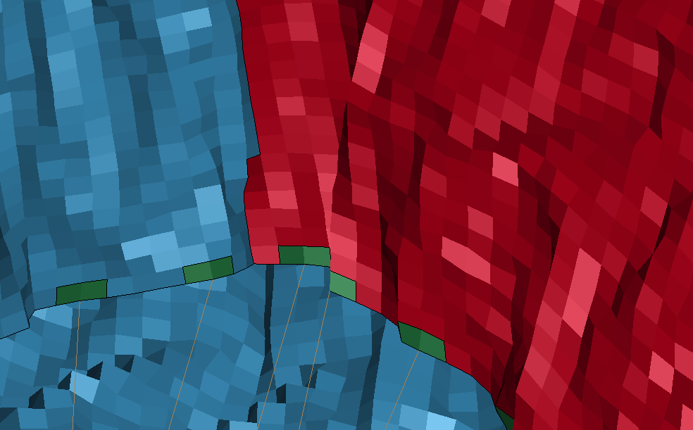

      However, I get loads of hourglassing and the simulation fails. See example of two simulations below:
          à
      Even with using hourglassing:
      *CONTROL_HOURGLASS
      $#     ihq        qh
               4       0.1
      Or even with fully-integrated membrane elements (elform=9) we get failure but without hourglassing:

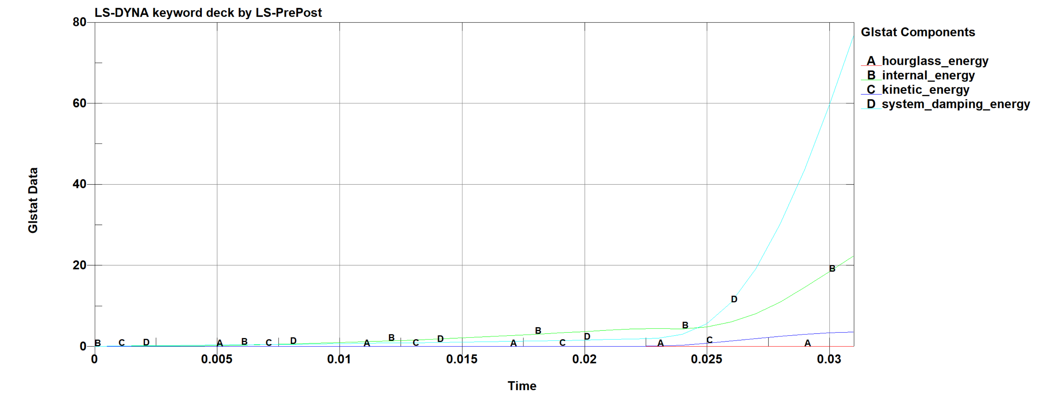

      I moved to TSSFAC of 0.9.
      ELFORM 9 with IHQ=8 looks like it works well. But the shells fail
        24084 t 2.6000E-02 dt 1.07E-06 write d3plot file            07/02/25 15:51:30
        25000 t 2.6985E-02 dt 1.07E-06 flush i/o buffers            07/02/25 15:51:32
        25014 t 2.7000E-02 dt 1.07E-06 write d3plot file            07/02/25 15:51:32
        25952 t 2.8000E-02 dt 1.06E-06 write d3plot file            07/02/25 15:51:34
        26911 t 2.9000E-02 dt 1.04E-06 write d3plot file            07/02/25 15:51:36
        27894 t 2.9999E-02 dt 9.79E-07 write d3plot file            07/02/25 15:51:39
        28910 t 3.0999E-02 dt 1.02E-06 write d3plot file            07/02/25 15:51:42

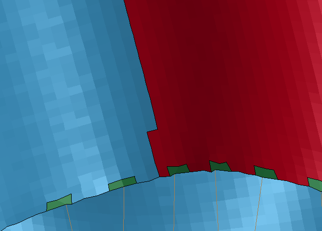

      I have simplified my parts so that they are no longer composites. Material model is *MAT_ELASTIC.
      Now I get failure at 26% through simulation. With these failure messages:

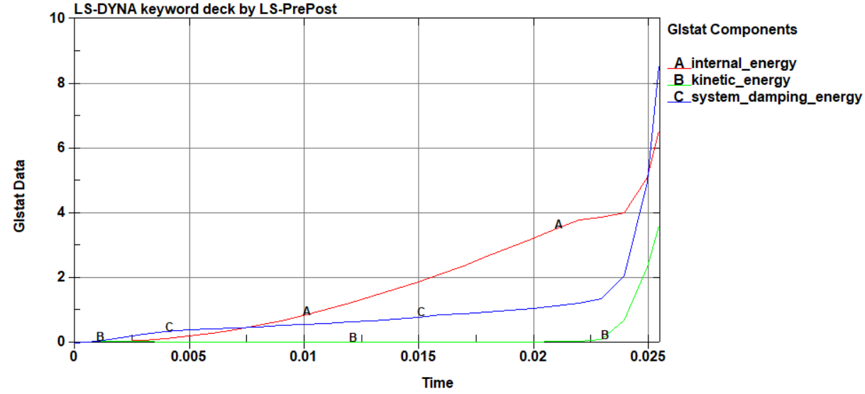

      These are my energies just before failure:
      These are my control cards:
