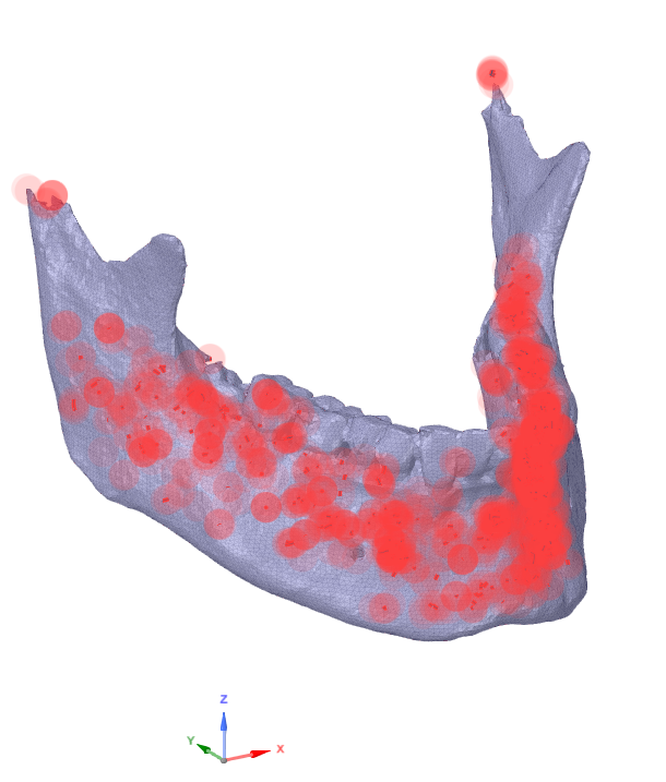

I was attempting to solidify the facet body. I tried it with an auto skin surface, and it discovered 1080 sharp edges with more than 120 degrees. As a result, I utilized the fix sharp option. This choice lowered my sharp edges, but when I clicked it again, it showed that the sharp edges had grown. I'm worried I won't be able to fix it. Is it possible to work with these geometries in any way? I've sent the model file as well as a photo. Please suggest a method to fix the sharps.

Ansys EmployeeYou can check shrink wrap command in SpaceClaim so that you wrap this geometry again. It will help you to give smooth wrap.
Regards Keyur
