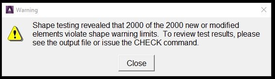

I am attempting to model a composite tube using ANSYS APDL and solid elements. I have little experience with the software and am unsure how to solve an error I am getting when in the meshing stage of my modelling. I will attach an image of the error.

On shape testing please see if the following links help:
SHPP (ansys.com)
Shape testing for solid shell elements ÔÇö Ansys Learning Forum
Regards Ashish Khemka

Thanks for your reply and suggestions. I found that changing to triangular mesh elements that seemed to solve the issue so I think its related to element sizing somehow. I will watch the videos anyways as it could help me prevent it happening in future
