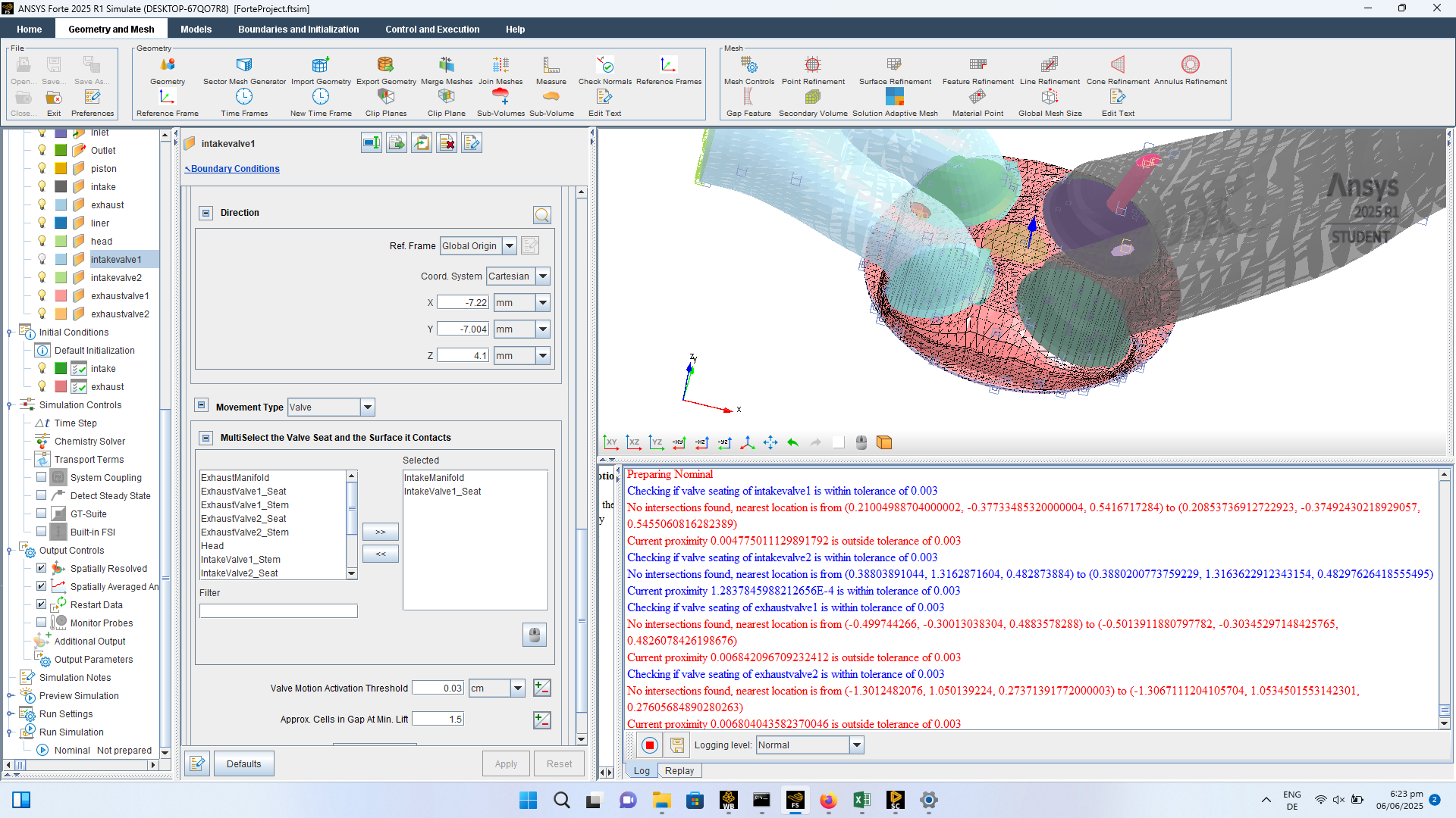

      I was training with Forte Academic version and scaled down inside Forte by 40% tutorial chapter 5 port fuel injection but valve error movement failed. Originally tutorial valve set up as shown below, was this angle setup main cause for error? i ttried picking coordinates on middle of valve face but no result.
      Accept the default Global Origin for the Reference Frame. Select Spherical for the Coord. System under Direction for the valve motion and set   =199 degrees and   =0.0 degrees.

      If the geometry is scaled/changed, you must check all the inputs that include numerical values as they will most likely need adjustments. For example, any local reference frame definitions, direction vectors, valve lift profiles, piston movement data, material point location, etc.

      I think it is to d with the theta=199' angle because the shrinkage would effect it but I didnt know how to alter the 199' accordngly.
    • Hasan
