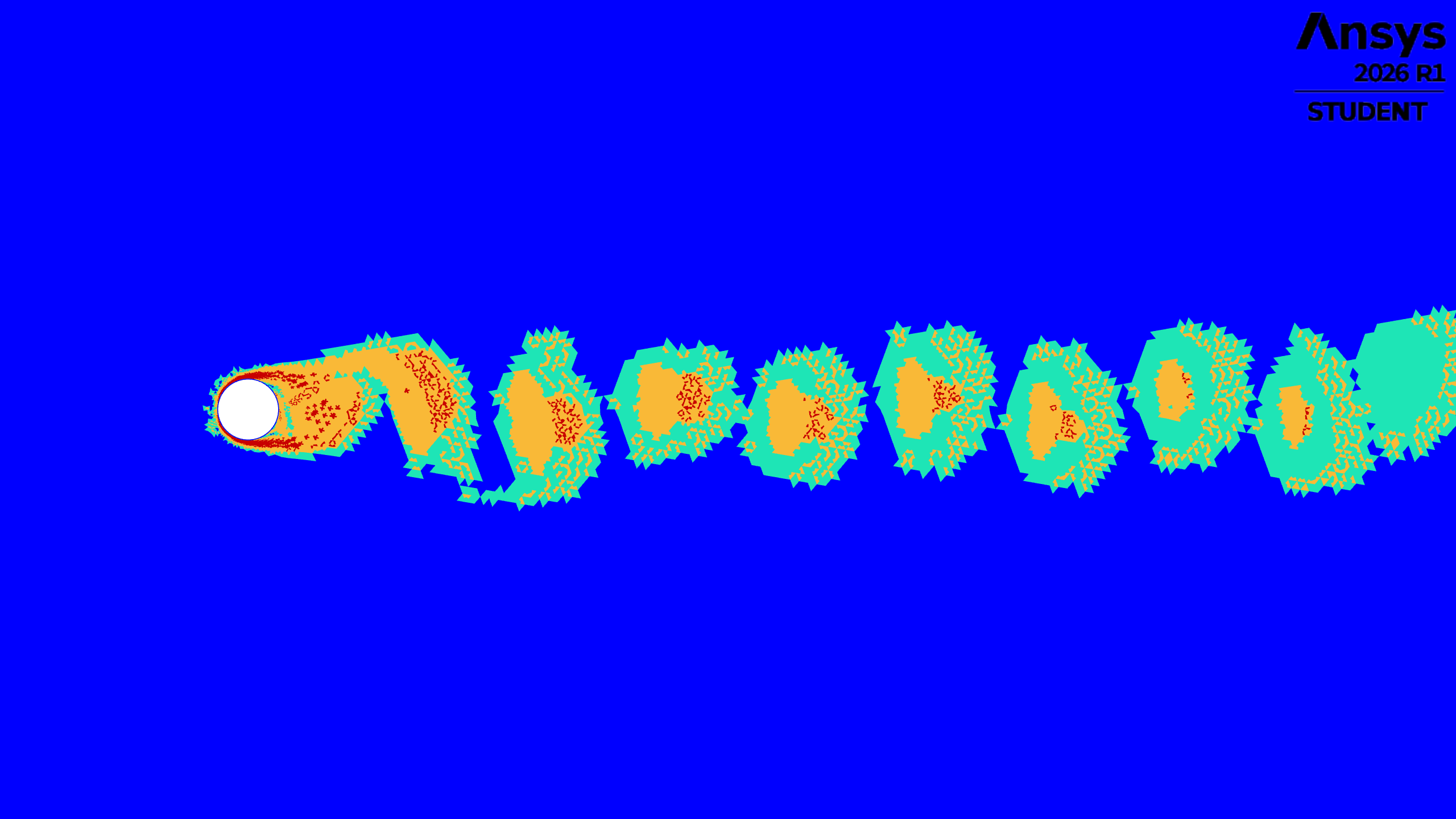

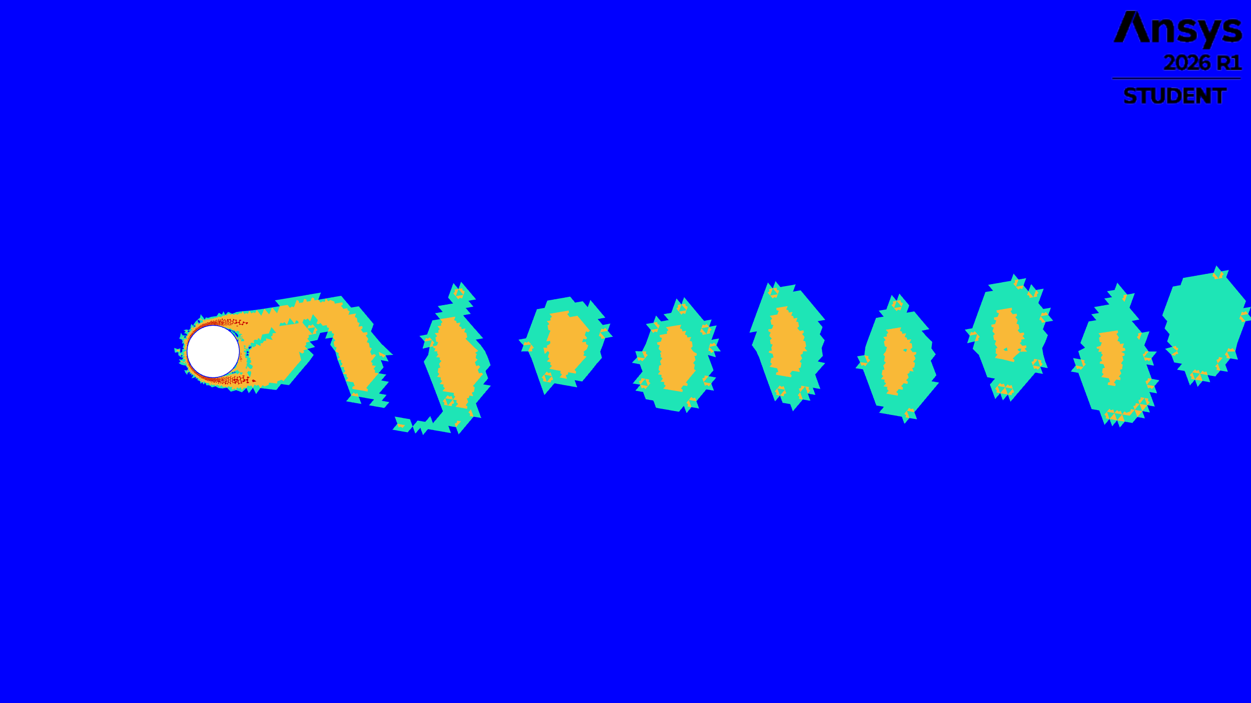

      I am using automatic mesh refienemt with the refinement/coarsening criteria specified above. In the first time step I apply manually the refinements in order to have the desired mesh refinements at the start of the next iteration and concentrate the cells at the high vorticity regions. The image below shows the cell refinement level in the domain at time step 1 (blue = lvl 0, cyan = lvl 1, yellow = lvl 2 and red is lvl 3):
      Now this is time step 25, as you can see the vortex core start to get closer and closer and the coarsening step isn't working

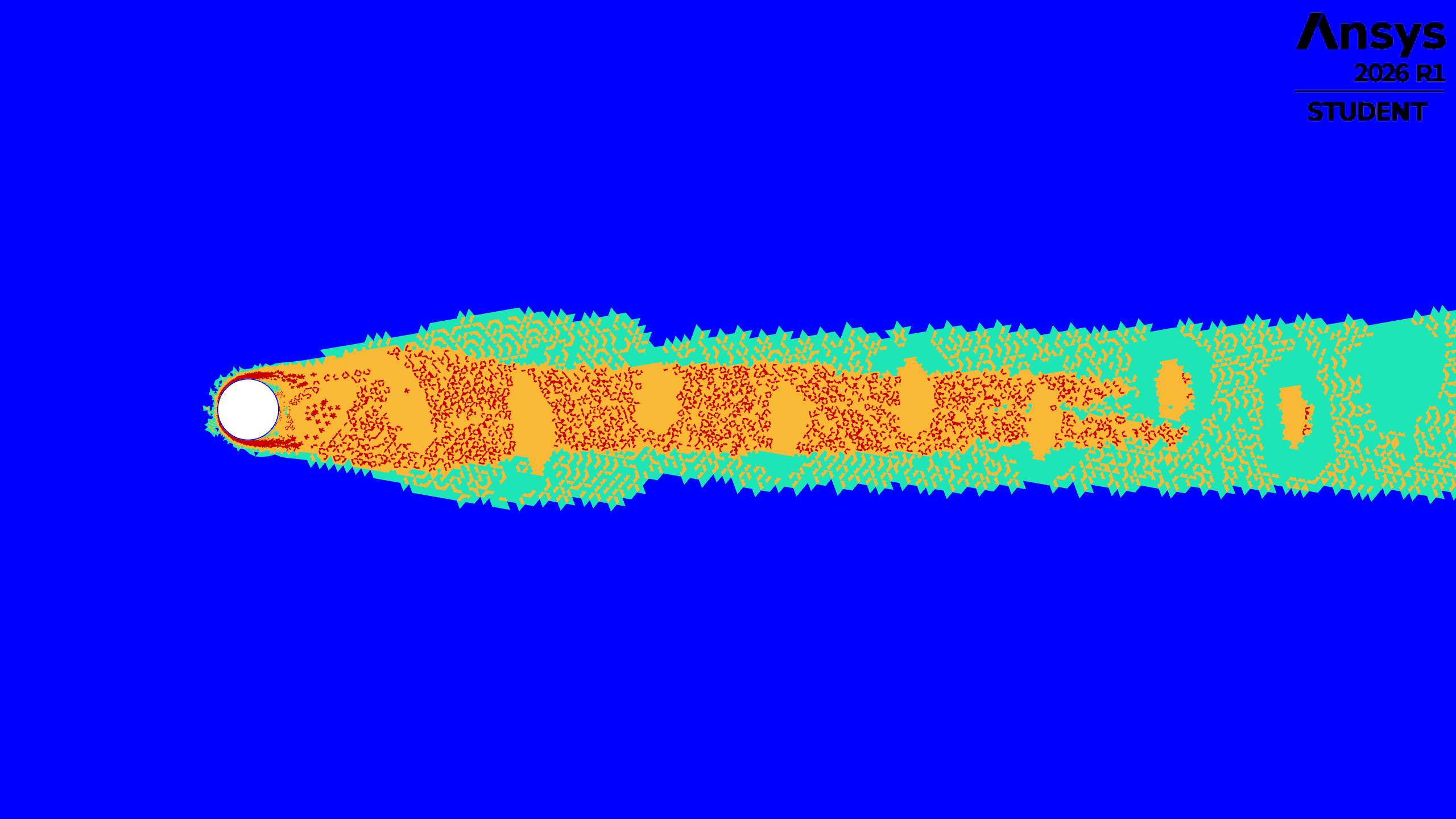

      Beyond a certain time step (around 100 time steps) the mesh clusters merge and the mesh starts to be constant. The image below is time step 500. It is also relevant to mention that the mesh patterns from time step 1 are kept and you can clearly identify where the mesh was refined initially.
      Can someone explain to me why this is happening in such a simple scenario?
