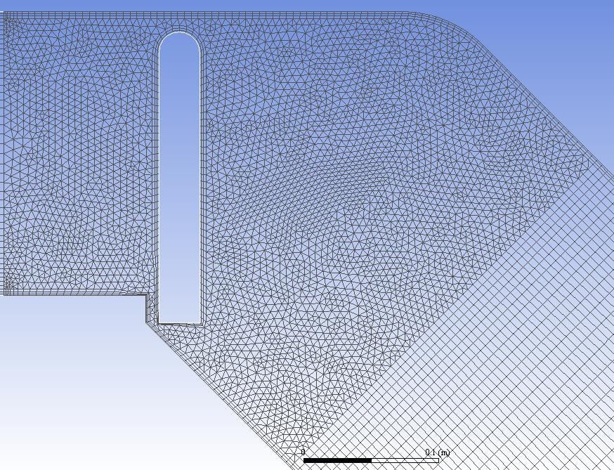

      I want to separate Cell Zone which have different shapes. I´ve read that I can use the following command:
      /mesh/separate/separate-cell-by-shape   separates cells with different shapes (pyramids, tetrahedra, etc.) into separate cell zones.
      The problem is that I can´t define this in the console in Fluent. Someone had already told me to proceed as follows but I can´t follow the steps in bold.

      I haven´t running any simulation for the moment, and I don´t want to mark cells based on values but based on the "shape".
      I´d like to do something like this. It´s a tutorial from ANSYS and a 2D-Case. We can see three zones in the middle: triangle, inflation around the valve and inflation around the pipe.
      And it´s possible to select the different cell zones:
      The solution to have multiple surfaces in the meshing stage is adequate for regions with different mesh, but not if I want to have Inflation. Indeed, I should then create a structure for each simulation.

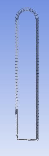

      I have done as following, but it doesn´t create two cell zones. I have just triangles and one inflation layer.I clicked on Adapt.
      What if I have two different inflation for exemple and one mesh in the middle. Thus, I have three zones to be separate. Indeed, I have to define each zones in the dynamic mesh zones.

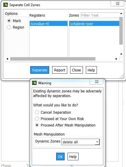

      Do not click on adapt: this will refine the mesh. You need to click on mark and then you need to separate the cells based on that register.
    • Max4
      I have click on Mark, and then Separate -> Cells ->
      When I do this, there is a Warning message: Zone not processed
      Maxime
    • Amine Ben Hadj Ali
      Why do you not disable"dynamic mesh" at first? After you have what you want you can enable dynamic mesh. Please be careful with mesh manipulation in the Workbench as Fluent keeps track of Mesh Operations and this might lead to a conflict if you update mesh upstream.

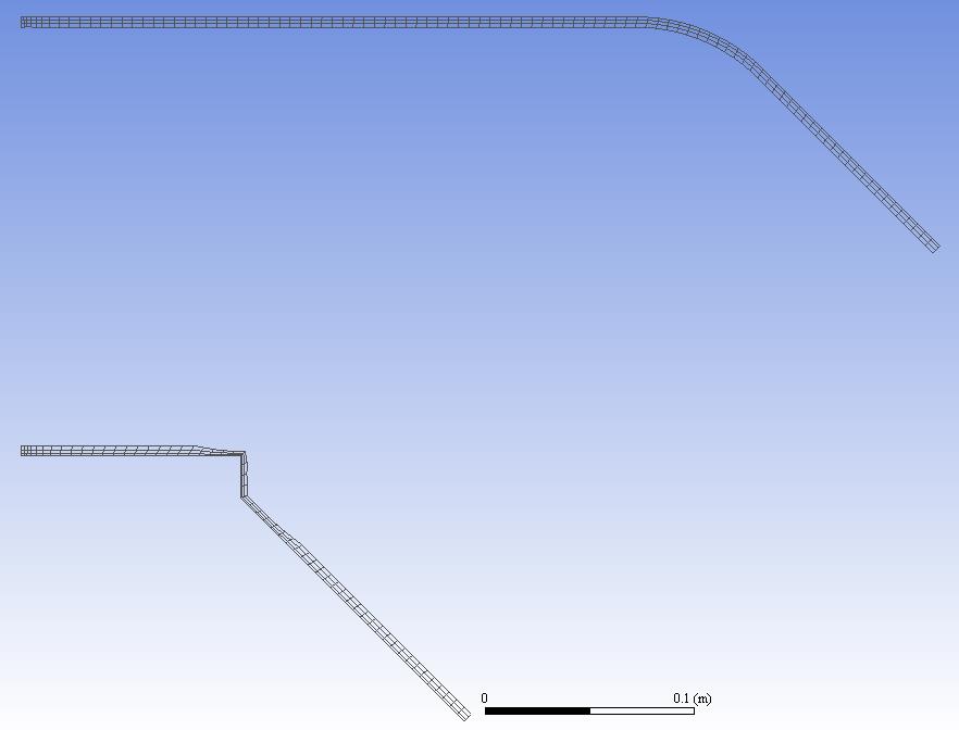

      I disabled it, but the warning message with Zone not processed is coming. This is the message in the console.
      I have triangle and one inflation (see below).
      Is then this definition okay?

      You want to separate the prism cells from the bulk, don't you? Why not doing a boundary adaption and select the number of cells layers you want to separate.
      Moreover Why not going back to pre-processor and doing all that stuff: is safer and valid for all Fluent cases downstream.
    • Max4
      Yes, I want to separate the quad cells (inflation) from the prism cells. I´m gonna to show this with the boundary adaption, thank you.
      I think that is the best solution to separate all zones in pre-processor.
