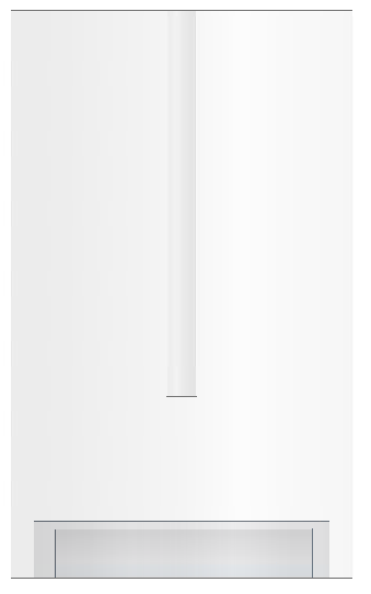

I am modelling an unbaffled stirred reactor in ANSYS Fluent where I am simulating semi-batch feeding. I initially used the homogeneous VOF framework to track interface between air and water (no feed, only considered batch mode of operation) and got a converged solution. Next I activated species transport equation and used mixture template with 3 species (water, calcium ion and oxalate ion). The oxalate ion is pre-charged in vessel and was therefore patched with concentration 0.04 M. The calcium ion was fed from feed pipe (positioned above vortex) at 4 L/h and 0.04 M with 2 L being added to vessel. There should be no discharge of material and there is no reaction. What I am noticing is that for the pre-fed species (oxalate) the mass (computed from mass integral of mass fraction of oxalate) seems to be continuously increasing despite there being no specified inlet flow for this species (I have double checked all boundary conditions) after short period of process time 0.74s. Mass increase reported from 0.0069274 kg to 0.0069328 kg which would lead to wrong transient behaviour as dilution effect isnt captured due to volume increase. I have tried adjusting time step size and URF to check the effect it would to no avail. The residuals look good as they are decreasing to < 10^-5 at each time step. It is only this artificial increase in mass of oxalate. I have attached some images below of geometry, mesh and vortex shape.Â
This is my set-up:
Solver: Homogeneous VOF (Implicit)
B.C: Veloicty-inlet (mass fraction of oxalate = 0), pressure outlet (backflow volume fraction of air = 1, mass fraction of species = 0), No-slip (0 mass flux)
Discretisation: Green gauss node based, compressive (volume fraction), second order upwind

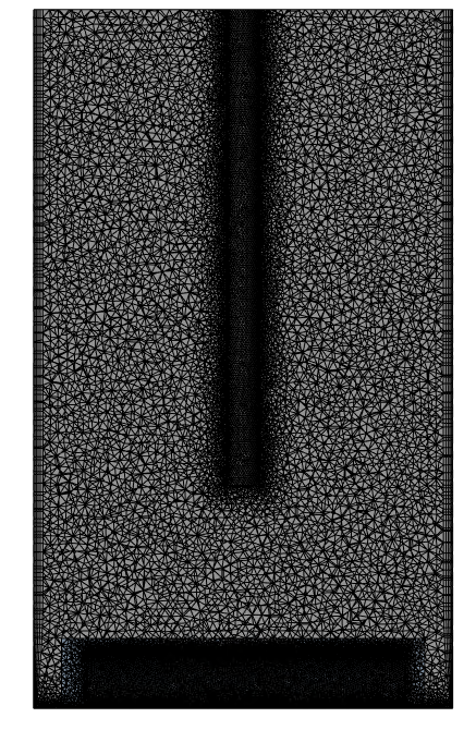

Mesh: Unstructured tetrahedral ~ 2 million cells
URFs: 0.3
Timestep size: CFL < 1

Another factor may be the mesh. If this is an axisymmetric problem with lots of solid body rotation in the flow, then a rotationally-swept hexahedral mesh will generally perform better. Tetrahedral meshes tend to be more diffusive than hex meshes, with the result being that gradients get smeared out. This can also contribute to mass losses in VOF cases. Before committing to a hex mesh, which can take longer to generate, I would suggest trying a radical mesh refinement like 2x finer to see if the mesh is a factor here. (In the grid-independent limit, hexes and tets should perform the same, but a lot more tets are often required for this than anyone realizes.)

Thank you for the reply. I am using weighted mixture for density and viscosity. I have refined the mesh further and ran a simulation but the same effect occurs. I have also tried turning off the feed and just patching initial concentration of oxalate in domain but the issue still persists in terms of mass accumulation
Changing mesh type from tetrahedral to hexahedral will be unfeasible for me as I am a PhD student and my previous work over the past 2-3 years (hydrodynamics, batch mixing) has involved using tets on domain.Â

SubscriberHi, this is a semi-batch reactor so there are no outlets to remove liquid. Instead liquid level rises with respect to time. At the top is a pressure outlet condition which allows removal of air as it replaced by liquid mass fracions of species are set to 0 here. The pipe inlet is set using a velocity inlet boundary condition, mass fraction of calcium ion is set to 0.0016 and mass fraction of oxalate ion is set to 0. Rest of tank B.C are walls with no-slip. The case is isothermal. I am solving full 3D cylindrical geometry (image is shown of 2D plane)
